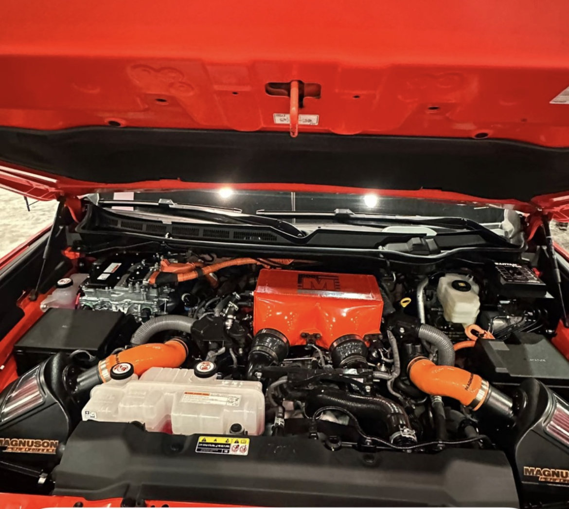

    It’s a complete, upgraded cooling system to help stuff as much cold air into the turbos as possible in conjunction with a tune. I have access to a pre production kit and will be installing it here shortly

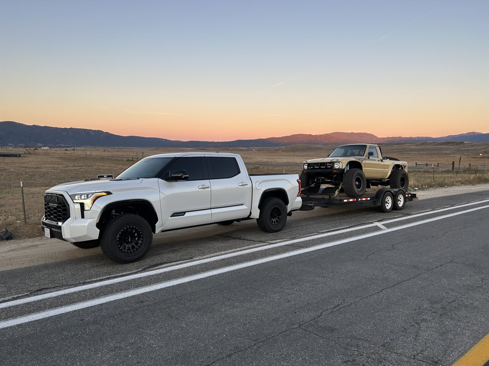

    Finally got a chance to tow with the new tundra and I was impressed. My off-road truck and trailer weights just over 7k lbs and the motor had plenty of power up the steep grades on the way to the desert. Trans also work’s excellent, never hunts for gears and downshift on the grades. I was most impressed with the handling of the truck, the King 3.0IBP shocks are a game changer. I can’t even put into words how stable and planted the truck rides at speeds especially though bumpy, twisty mountain roads.
    For reference I’ve always had GM 2500HD trucks w/duramax motor motors so I had low expectations for the tundra. Needless to say I was blown away, this new truck kicks ass and the suspension mods were worth every penny!
