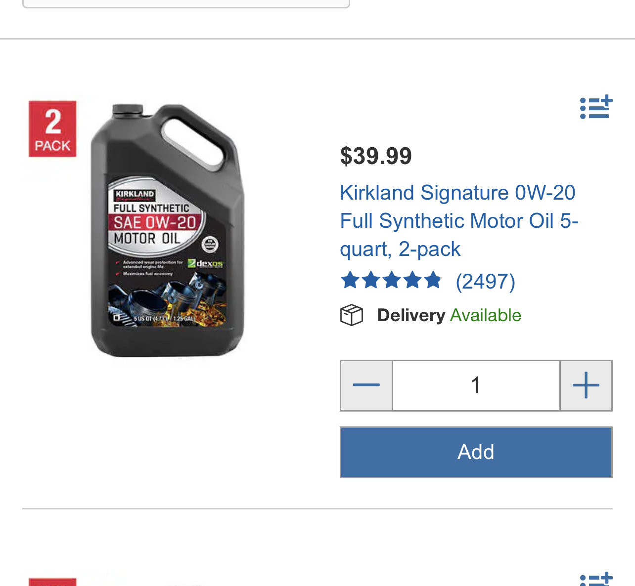

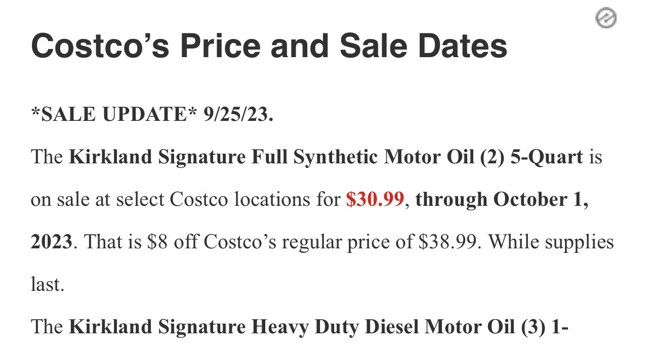

    When it’s on sale. Full price online is $39 for 10 quarts. It’s a buck cheaper in the warehouse.

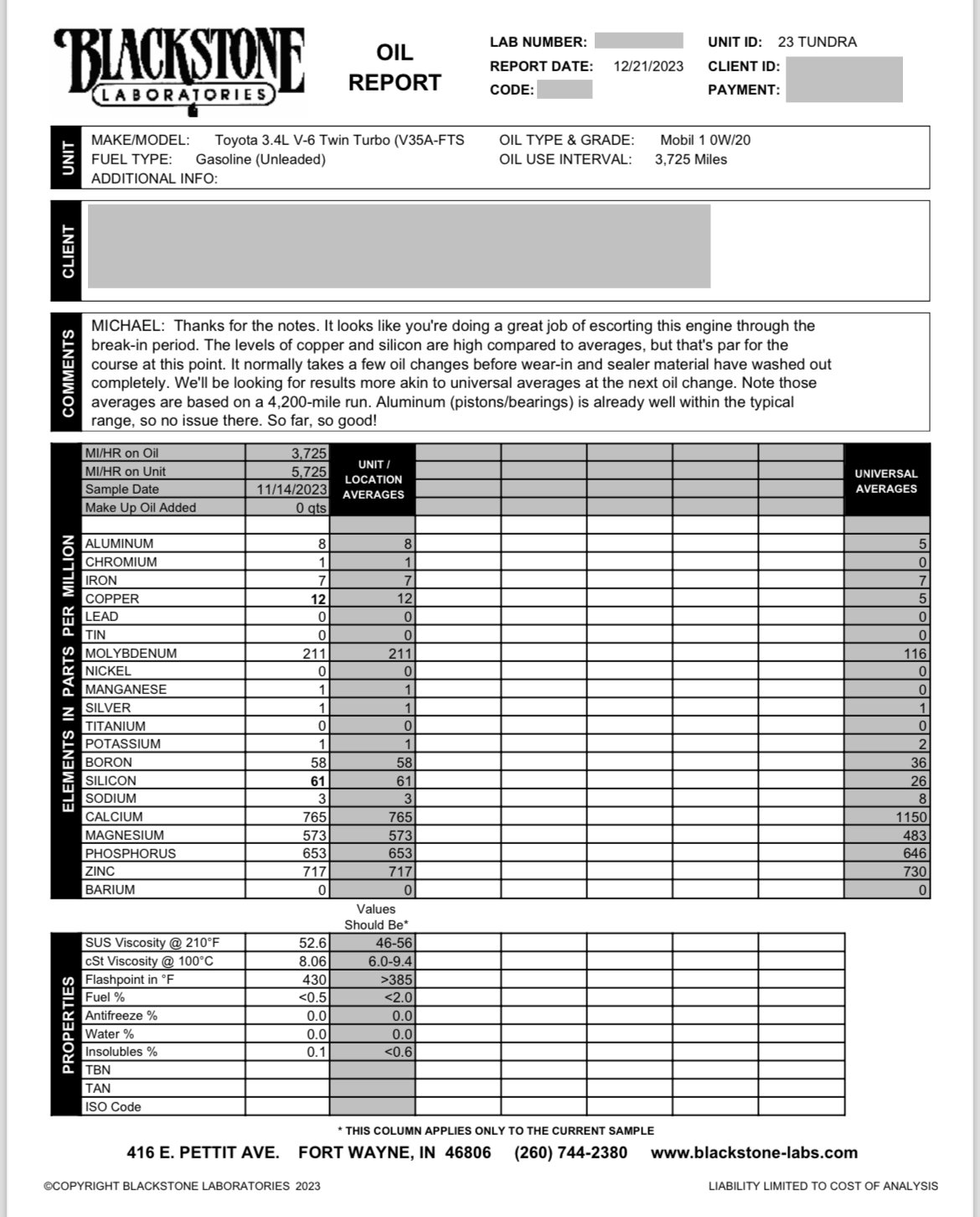

    My first Blackstone Labs report @ 5725mi. First change was at 2K mi but I didn’t sample that one.
    Dealer will be doing the next at 10K

    My research found these turbos are still oil cooled like all others but this new block has water cooling jackets around the exhaust ports ahead of the turbos cooling the exhaust flow headed in.

    The comments in the report bring me comfort regarding my post about fine metal in my oil. Thanks for posting.
