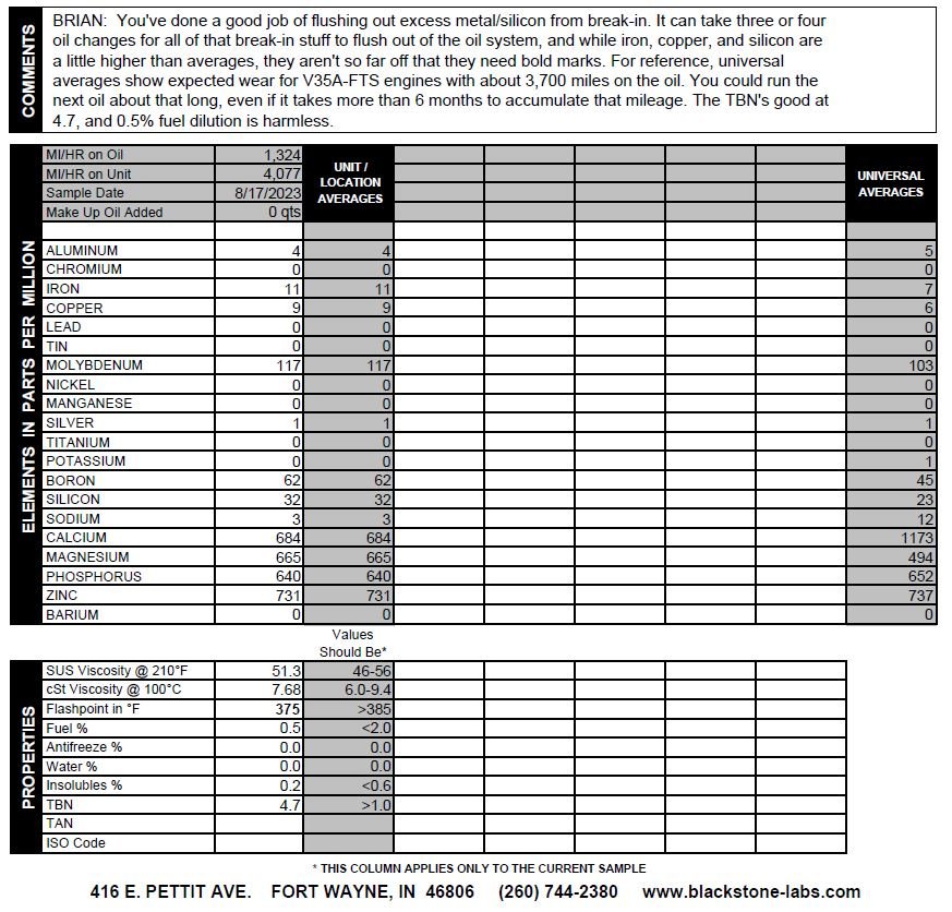

    So finally got some time to post the oil analysis, it's been a crazy week. Anyway, as you can see everything is within spec. That said, the analysis only reinforces what I've been concerned about, which is fuel dilution. I'm a prime target for it. Most usage is trips to store (5 miles or less), occasional longer drives, and roughly monthly towing of 8000# travel trailer. They do state that the 0.5% fuel dilution is harmless (and at that level it is) but this oil only had 6 months and 1,324 miles on it. For anyone else who has a similar use case to mine, I think you'd be nuts to be doing 10k OCI, but to each their own.

    Right, but the oil had 87% life remaining by a 10k mile OCI. So in only 13% of the recommended oil life usage, he is 1/4 the way to max fuel dilution. In other words 5,000 miles will have him at 2% fuel in oil if the trend continues.

    Yes, what AZBoatHauler said.

    Flashpoint already out of spec at 1,300 miles use is, as the kids say, cray cray.

    Yep, that as well. Due to fuel dilution most likely.

    Yes, a bunch of 87 octane in there isn’t going to help.

    91 actually, but same result. Since I rarely get through a tank before my next tow, I only run non-ethanol premium.

    Hey Ted, I have heard that too that modern engines with turbo chargers and intercoolers are prone to higher levels of aluminum and potassium due to the brazing flux used but I am not sure why you would see an increase after the second oil change. You would think those levels would be dropping rather than increasing. A increase in potassium (in this case twenty fold) can also be linked to coolant contamination issues as are sodium and molybdenum which also went up slightly in the second analysis.
    I am sure this is all normal as Blackstone have seen this hundreds if not thousands of times but I would keep my eye out on that potassium. I sure enjoy seeing the scientific approach you are taking towards your new Tundra ownership, keep it up!
