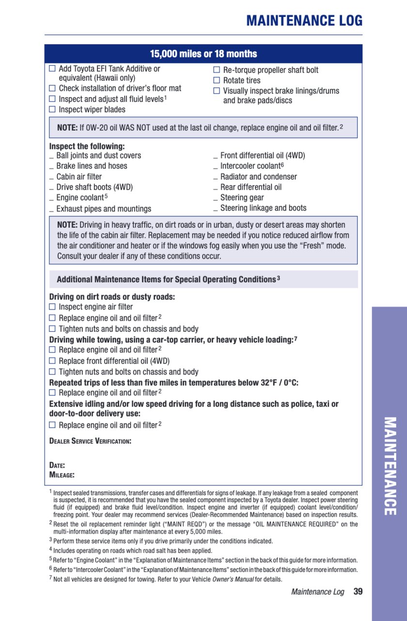

    Just a friendly reminder that quite a few of us fall under 5k oil changes. below is the 15k maintenance schedule for reference. See "Special Operating Conditions"
    Cheap insurance. Especially for those of us in cold climate that occasionally make short trips which results in condensation build up in the crank case / oil.

    Actually, VERY few fall under Special Operating Conditions.
    Ask yourself honestly - do you drive PRIMARILY under any of those conditions? That schedule doesn't apply unless the overwhelming majority of your driving is under one or more of those enumerated conditions. It doesn't apply if you tow your fishing boat to the lake 20 miles away every other Saturday, but drive 600 miles in between those trips to the lake.

    I use my truck to do truck things and my suv more less as a daily, so yes. It gets at least 1500 or so trailer miles and countless dirt road miles between each 5k OCI. Most of that is in the mountains. Again, good oil and a quality filter is cheap. Especially relative to the cost of our trucks. A simple suggestion and reminder for those that are not pounding pavement every day to and from the grocery store or work.

    I'm not arguing the oil change interval - I also do 5k for a number of reasons.
    My point is simply that very few people actually fall under the Special Operating Conditions as defined by Toyota. Many people think that because they tow their fishing boat to the lake 20 miles away every other Saturday, but drive 600 miles on pavement in between those trips to the lake, they fall under the Special Operating Conditions.

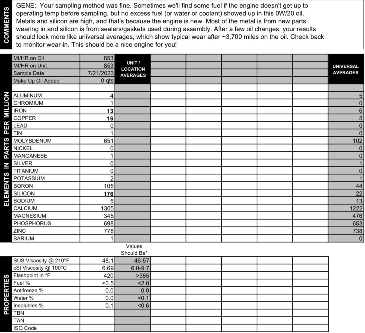

    I didn’t spend the money to just swap out stuff.
    Phew, thought it was going to be lost forever. Sample delivered 8/18 (pulled a month prior) and received results today. I want to take advantage of my free oil changes (next one I want at 5k) but I am not sure if I can rely on an oil tech to pull a sample if I ask which is when these numbers will really mean anything. Until then, it’s just to compare with other folks that got a break-in sample done.
    As an FYI, I was very adamant about the break-in guidelines in the manual. I didn’t gun it hard until after the oil was changed and even then I wasn’t aggressive about it nor am I today.

    Thank you very much for remembering me and sharing your report. I know early on metals and such are high but fuel, coolant and water are the main points this early and yours looks great. I’m approaching 2K mi. and getting ready for a 3K trip. The trip there and back each have two 10-12hr legs so I want some fresh oil in there. Will pull my sample at 2K. Thanks again!
