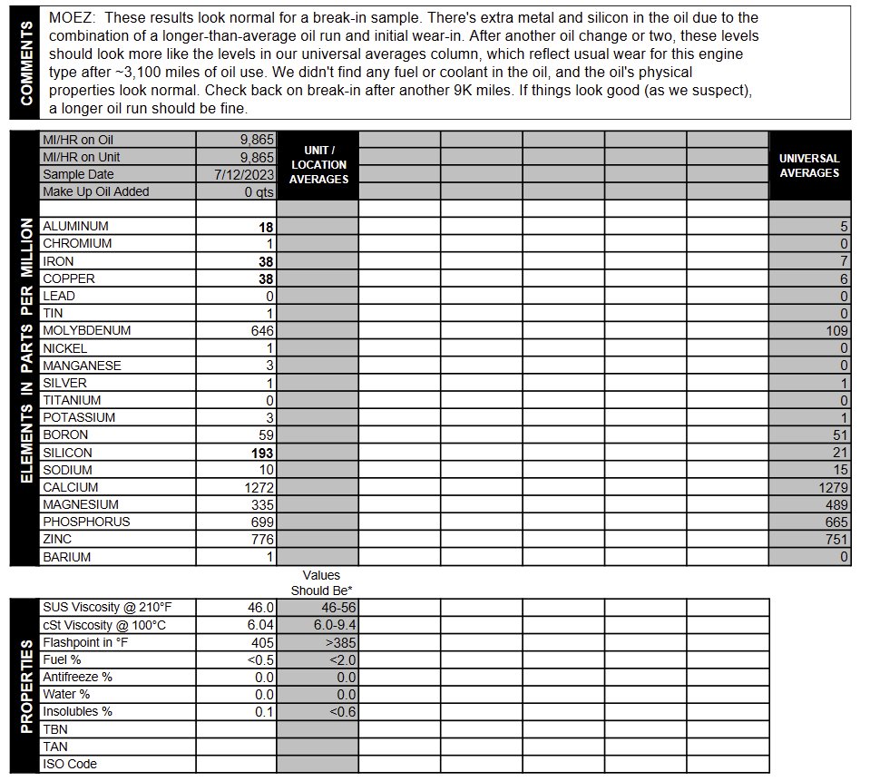

    Here are the results of the oil analysis after ~9800 miles on my break in oil. Higher than average metal/silicon because of the wear in, but nothing alarming to note yet. I'm gonna run another 9k miles on it and see where we're at! These 9k miles included towing a 9k trailer and several road trips from Dallas to Austin, Houston, Little Rock, and Tulsa. I'd say its a moderate workload on the truck.
    I'm gonna run it another 9/10k miles and see where its at.

    You mean you will do oil change now, and do another oil test after 9k miles, right?

    I changed the oil at 9800 miles on July 12 and pulled this sample from that.
    I've got ~1000 miles on the new oil already haha

    Thats good, early oil changes should help to prevent those bearing failures
