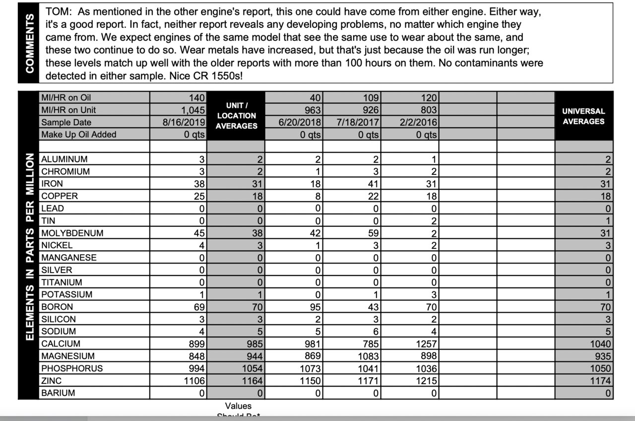

    They do. This one is out of one of the engines in my boat with the history. I started at 100hrs worked up to 140hrs on this test and ultimately ended up at 200hrs. Oil changes are $4K so you watch the science pretty closely. Full report is on the PDF.

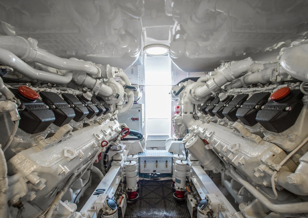

    Kung Fu Dick
    Twin MAN CR1550’s?
    Nice boat dude, big offshore sport fishing boat?

    Something tells me she can get with the program when called upon.

    I’m not currently in the correct economic bracket to contemplate what a full round of oil, oil filters, fuel filters, water separation filters etc costs if it all has to be done at once. You alluded to some obscene costs for an OCI, no doubt a huge amount of oil, filters that aren’t cheap, and from the looks of the engine room some $$$ in labor too.

    40 gallons of Mobil 1. Lots of fuel and oil filters. 4 air filters and the genset. Seatrial against the baselines. Blackstone on the 2 mains, transmissions and genset. I'm a good Blackstone customer.
    Back on topic though, I don't do that much analysis on my cars. I change air filters at about 1/2 the recommended time, always use synthetic and change it at 5-10K miles depending on use. On big diesels with raw water cooling the analysis is critical for not only what your OCI should be but preemptive to look for salt water, fuel or bearing material in the oil. There are steps you can take if you see indicators in advance.
    I'm not sure what Toyota would do if you took a Blackstone report to them? I doubt they'd act on it.

    Interesting on the diesels in your boat using salt water for cooling. I was under the impression that there was usually a fresh water/salt water heat exchanger to keep the saltwater out of the engines completely.
    In my industry we use strait fresh water for coolant in medium speed diesels, with a corrosion inhibitor added. Unfortunately the current industry wide obsession with lowering operating ratios has resulted in far too much deferred maintenance. We can report problems but the powers that be don’t seem to care. Kind of sad, and part of the reason our side of the supply chain is still all sorts of dicked up. The RR’s want to use COVID as an excuse for their piss poor service, claiming the pandemic caused their staffing issues, lack of motive power, poorly maintained track, and shortage of maintained rolling stock. Yet all of us in the operating side of the house have observed this idiocy going on since 2015.
    Kudos to you for maintaining your equipment to a high standard. Take care of your equipment and tools, and they’ll take care of you.

    That looks like it would be a nightmare to try and track down a pinhole leak.
