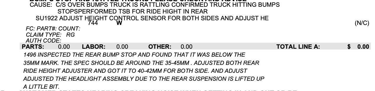

    My Platinum is in the shop right now where they are diagnosing the air suspension. Im the second owner and every since I owned it I always thought it rode like crap. At one point I decided to cycle the air suspension and my truck got stuck in the high position(even though the dash said it was at the neutral height). Took it to the shop and a new AVS computer didnt fix the issue. I was told there is one more part they can try to replace. If that doesnt fix the issue the whole system has to be removed and a Toyota rep needs to come in and help diagnose the issue part by part. I did get a loaner SR5 and Im shocked at how much better that truck rides than my Platinum.

    Once I get my truck back, maybe I should switch to normal or sport mode then? Ive been riding in comfort mode and have been hitting the bump stops a lot. Part of that though has to do with my air suspension being messed up. Even though it said it was at neutral height, it was riding in the "low" mode all the time. I crawled under the truck and I couldnt even stick my pinky between the axle and the bump stop.

    Breathing Borla
    Jan 21, 2020
    #41531
    7,384
    AZ
    maybe it needs the TSB for this
    they will adjust it be into spec
