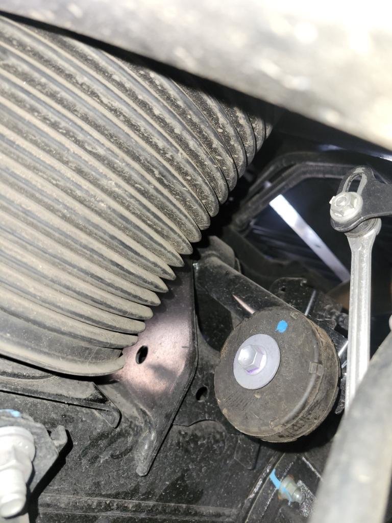

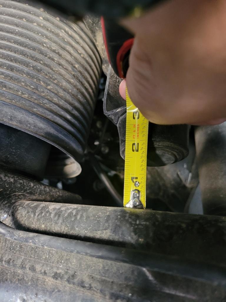

    post a pic of your bump stop axle area with it set in N, Id like to see the flat ground N position distance from the axle
