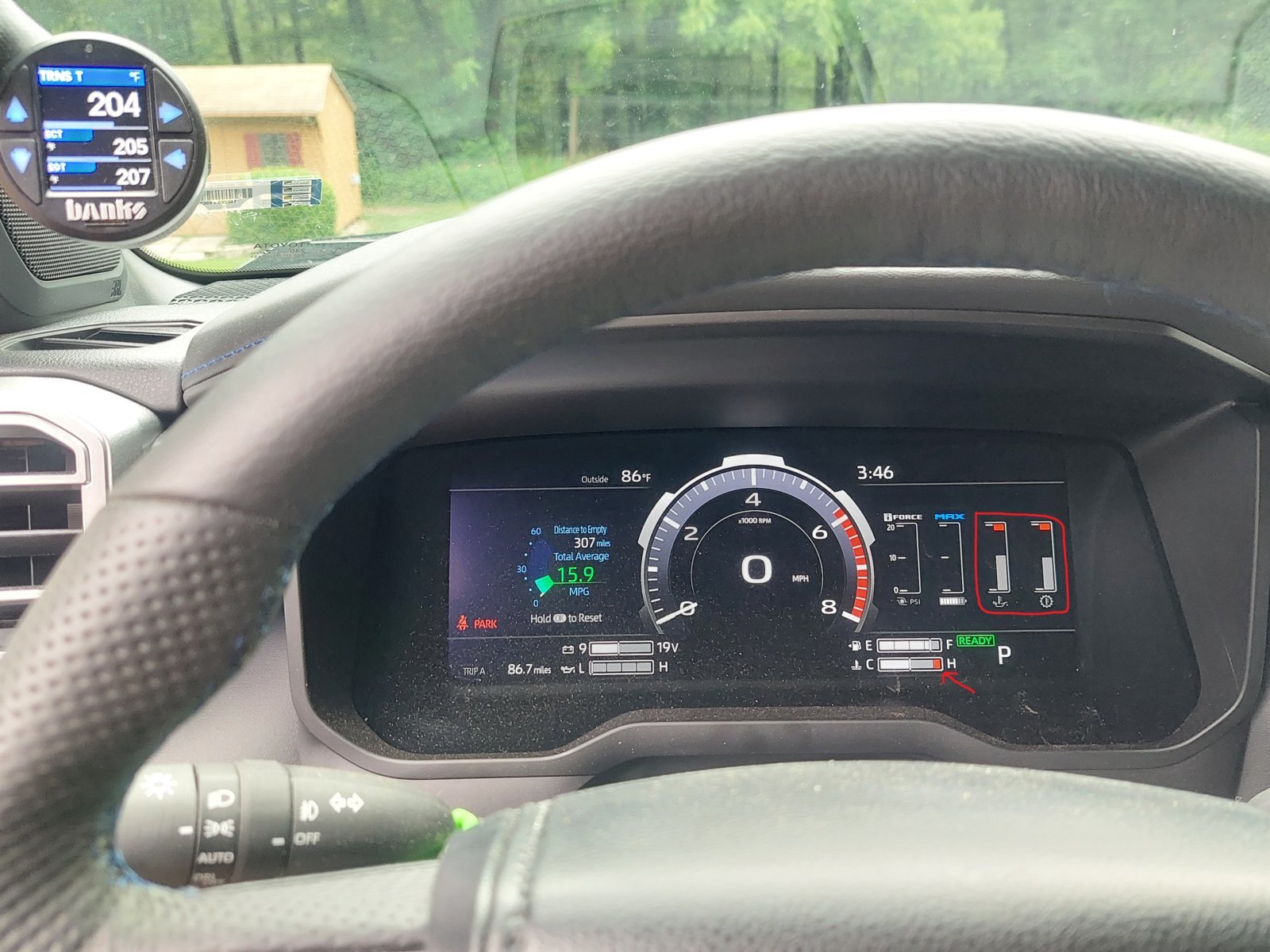

    Here is an update on what I have learned after towing my 5200 pound camper twice.
    • Without a trans cooler temp reached 226 degrees reading my Banks IDash gage in 72 degree air temperature in late May.
    • With 59,000 BTU cooler the temp reached 212 degrees this trip in 85 degree heat in June.
    • I confirmed that I was connected to the correct transmission line per post #177,178
    • I picked up a friend and was showing him where the cooler was mounted. By accident I touched the cooler line and it was cold! What I discovered is the bypass valve/Thermostat does not open until a temperature of 195 - 200 degrees!! I checked it on three different trips and the result was the same! This is in line with what MaxPayne3 said in post #61.
    • With no camper the trans temp reached 204 in 90 degree temperature. Today it was just under 200 degrees.
    303Gen3 and anyone with a transmission temp gage with an aftermarket cooler can you see if you get similar results on your cooler lines being cold?
    From what I am seeing we can only control the heat above 198 degrees unless we bypass the bypass valve/thermostat.

    Boy I must say I like the Banks Idash gage much better that just lines as pointed out below. I am showing transmission temp, coolant temp, and engine oil temp.

    My engine oil temp has never gone over 205ish. Coolant (radiator) is always sub 200 - runs between 185 and 198.
    Trans oil temp holds par
    with engine oil temp since addition of cooler. Pre trans cooler my engine oil was 205 and trans temp was 215.
    Have to think our differences are hybrid (your truck) and non-hybrid (my truck). Hybrid runs hotter by design.

    I brought my truck to the dealer at 2500 miles to document the high transmission tempature. Talking to the mechanic he told me "keep an eye on the engine oil temperature". He went on to say "if it gets in the red (truck gage) shut it off". He was implying that trucks that have lost a motor (due to metal chips) have had elevated engine oil temps. Towing this last trip my engine oil temp hit 237°! I hope I am not looking at that kind of an issue in my future!!
    I don't think the hybrid would influence engine oil temp. The hybrid motor is after the engine and before the transmission.
