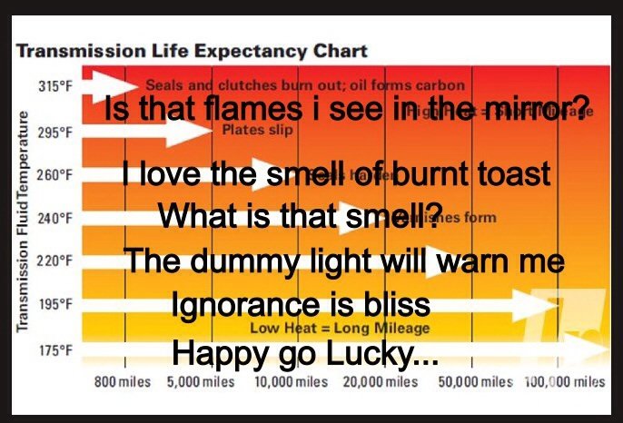

    If your using it on the Tundra, it's picking up the temp from the temp sensor in the valve body which is grabbing temperature from the pump, which will be slightly higher than the pan but a better indicator of fluid temp. Anything less than 185 is going to be optimal and prolong the life of the transmission. A "red line" would probably be sustained temp at 220 or higher (doesn't go down after 5-10 miles of driving), it could spike at that temperature but then start cooling back down, but if it does repeatedly spike or you have sustained high temperatures it's best to get the fluid changed soon. Below is a a funny, yet informative chart :)

    The chart everyone keeps posting is from the 60’s. Newer transmissions are designed to run hotter.

    I said that and got booed out of the building by our resident trans shop owner , so maybe thats not the case.
    guess I dont really give a shit, I drive it and if it blows up toyota can fix it, knock on wood,I never had a problem with aisin trans

    This is outdated information. The fluid in the 2019-2021 Tundras is rated for 280 degrees continuously. One post states that the components are rated for 325 degrees.
    Woocawachie likes this.
