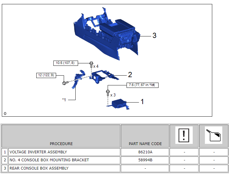

    Where is the 400/100 watt inverter located on the TRD Pro?
    ryanwgregg likes this.
  2. Aug 25, 2022 at 5:58 PM
    TakiEvo
    TakiEvo New Member
    Dec 28, 2021
    #72363
    659
    Allentown, PA
    2022 SR5 TRD Sport Crewmax White
    Should be underneath the center console like all the 3rd gen.

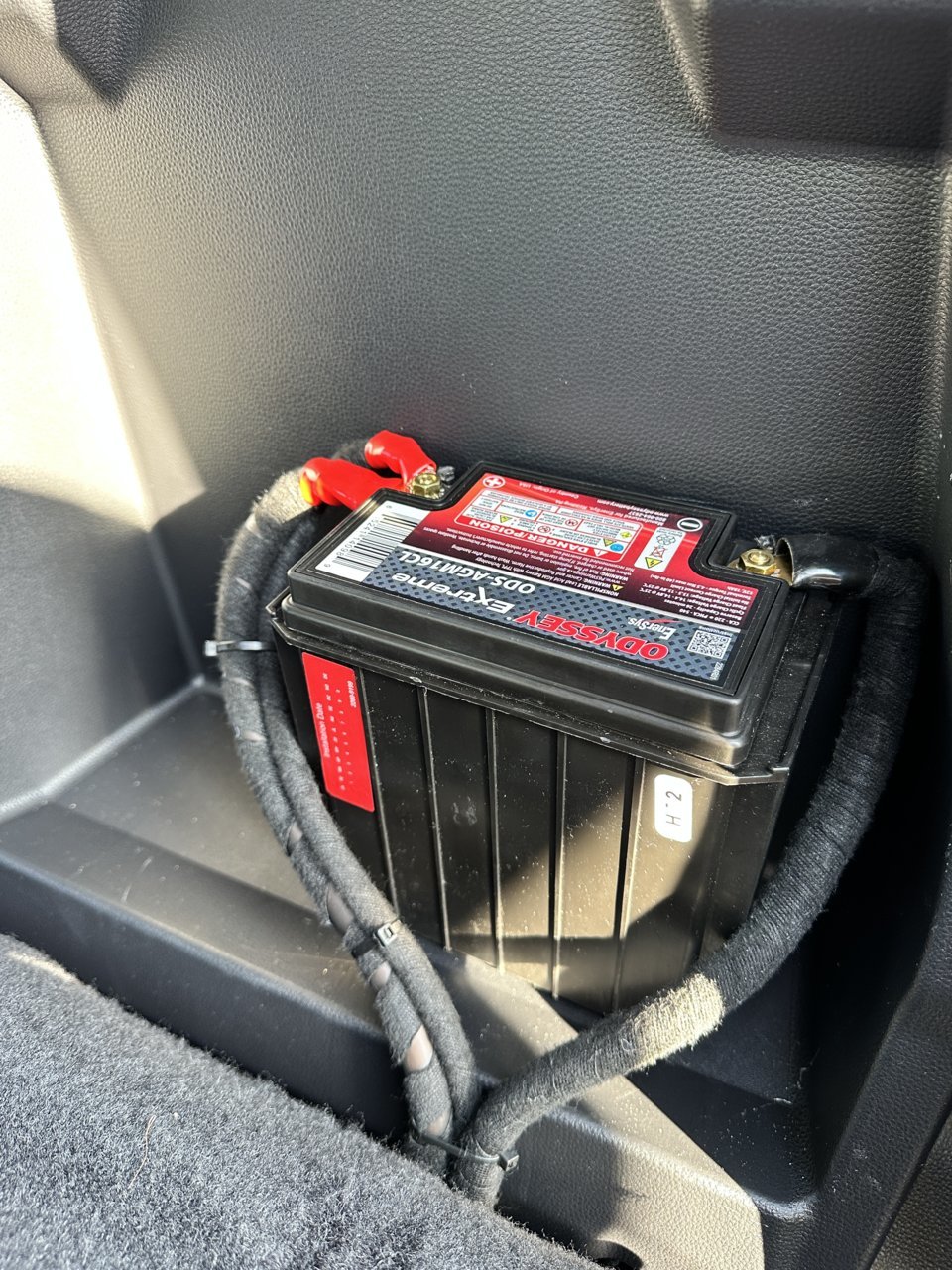

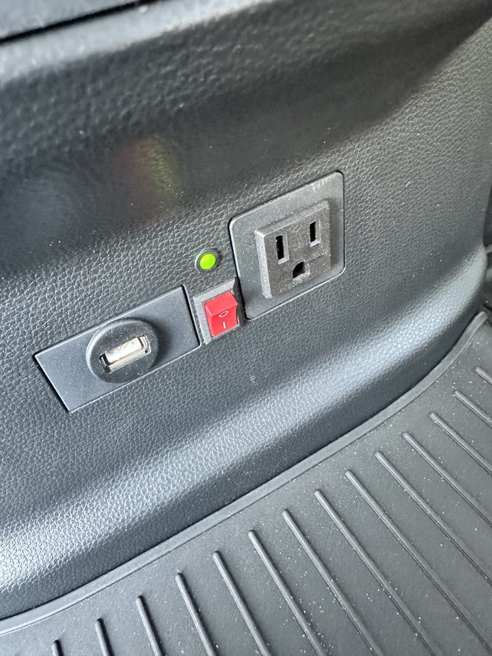

    I just installed this is my SR5 that didn’t have one. 1500w.
  11. May 18, 2023 at 2:22 PM
    PERRY1060
    PERRY1060 Hammer Down
    Apr 14, 2022
    #77186
    509
    Perry
    Indiana
    Blk on Blk 22 Ltd 4x4
    TRD wheels, skid plate, black fender flares, mud flaps and running boards. Pirelli Scorpion 275/70/20 Allterrain Plus tires
    Nice clean install. Was the power supply for your inverter already in the console or did you have to run a lead from the battery or other source?
  12. May 18, 2023 at 3:02 PM
    NATE4SURF
    NATE4SURF New Member
    Apr 11, 2023
    #95320
    157
    Laguna Hills, CA
    '23 TUNDRA TRD CREW 4X4, was ‘05 TUNDRA TRD CREW 4x4
    we put a small AGM batter behind the seat. It runs off of that when I turn on the red switch. That way I can use it when the truck is off. Then the truck charges the AGM when I’m driving.
