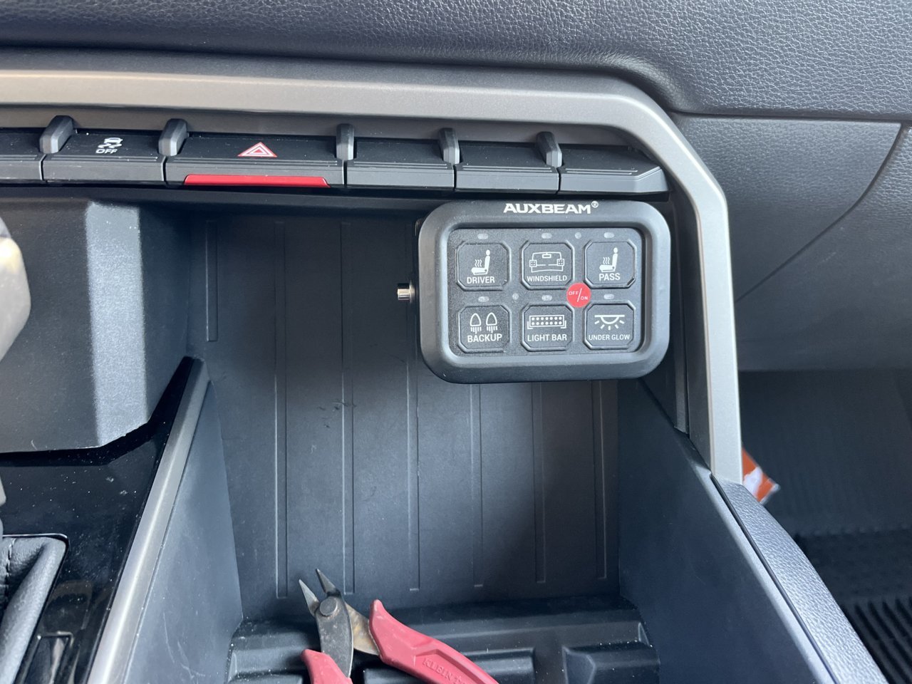

    where did you get that mount!!!??

    My gang mounting option

    Did you have to remove that panel to install or were you able to access through the side?

    yea, i remove the side and the panel that it was moutned on. Drilled 4 small hole and a larger one for the wires from the switch. it's solid and nice.
