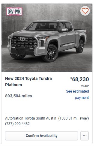

    I always see a fair amount of high mileage 3rd Gens on Autotrader at any given time. The mileage question comes up often enough that I've stopped creating new posts on the subject and now just link to this last post I did:
    https://www.tundras.com/threads/off...-discussion-thread.125154/page-6#post-3289598
    The Autotrader links in the above post are likely broken now since (I'm sure) the trucks have been sold. I looked on AT just now and I see eight MY22 trucks on the first page that have 75k miles or more on the ODO. If you really get bored, you can do like I did in the above post and search the service history on the trucks by entering the VIN at on Toyota's website to confirm none of them have had engine rebuilds.
    Side note: I didn't include this one in my count since I'm sure it's a typo. If anyone wants to call Autonation Toyota of South Austin to confirm...I'm sure you could be famous for having the first million-mile 3rd gen. And, a 2024 to boot! :rofl: Though $68k for a truck with nearly 900k miles seems a bit steep.
