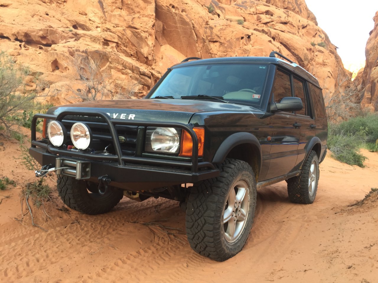

    bballjames
    bballjames New Member
    May 6, 2022
    #78042
    480
    Inland PNW
    22 Tundra Platinum 4x4 Hybrid Crew Max 6.5ft bed
    I’ve had a very good life… and the way you know that is my only regret so far has been selling that vehicle.. :D
    And ya those duratracs were amazing. And they honestly held up fantastic. Not a ton of road noise, but extremely capable tire.

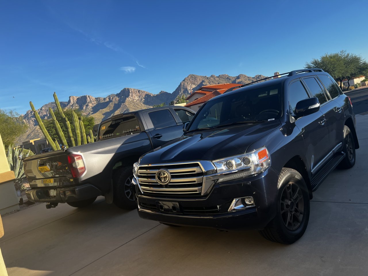

    AZBoatHauler
    Aug 13, 2019
    #34576
    9,382
    So.Arizona
    His and hers 5.7s.
