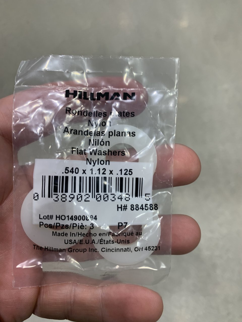

    The McMaster washers OD wasn’t large enough. I didn’t think to measure the ID of the tube that the bolt goes through and it was just small enough to fall right into that space. I went to Lowes and grabbed these nylon waters which fit perfect. Ran a couple of days with no issues or sounds.

    @bsulli91, I am curious to know if your fix has been permanent in nature? I added some nylon washers under my bed between the frame and the bed rails and the bed has never been more quiet- for about a week or so. Fast forward and the noise has come back. Anyone have this problem? Curious to know what the end all be all solution is that anyone has come up with? I loosened the bed bolts and the noise goes away, so I am know I am on the right path. Thanks in advance.

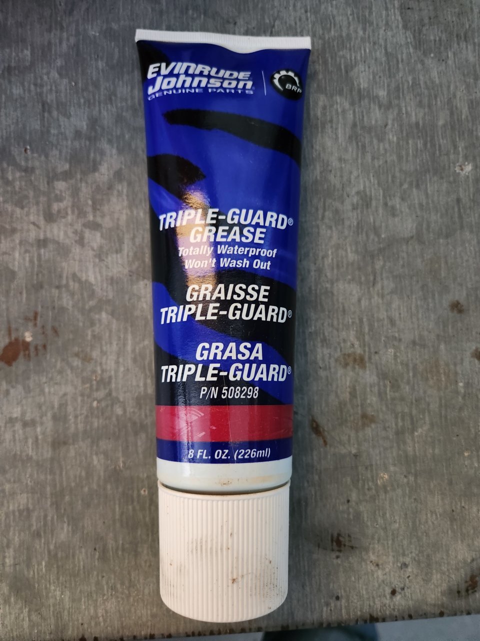

    Mine has been quiet for a few months with temps from the 30's to the 90's and about 7k for miles. I didn't use the washers but good quality grease. I am calling mine fixed.

    #91473
    8
    A decent coating where the rubber pad touches the frame of the truck. I also put grease on the bolt and bolt head in the bed. Any flex the bed or bolts make are now greased.

    Just loosen the bolts and grease between them...took 15min, also do between the OEM rubber pads and frame. Fixed all my noise, I had no reason to put anything between mine.
