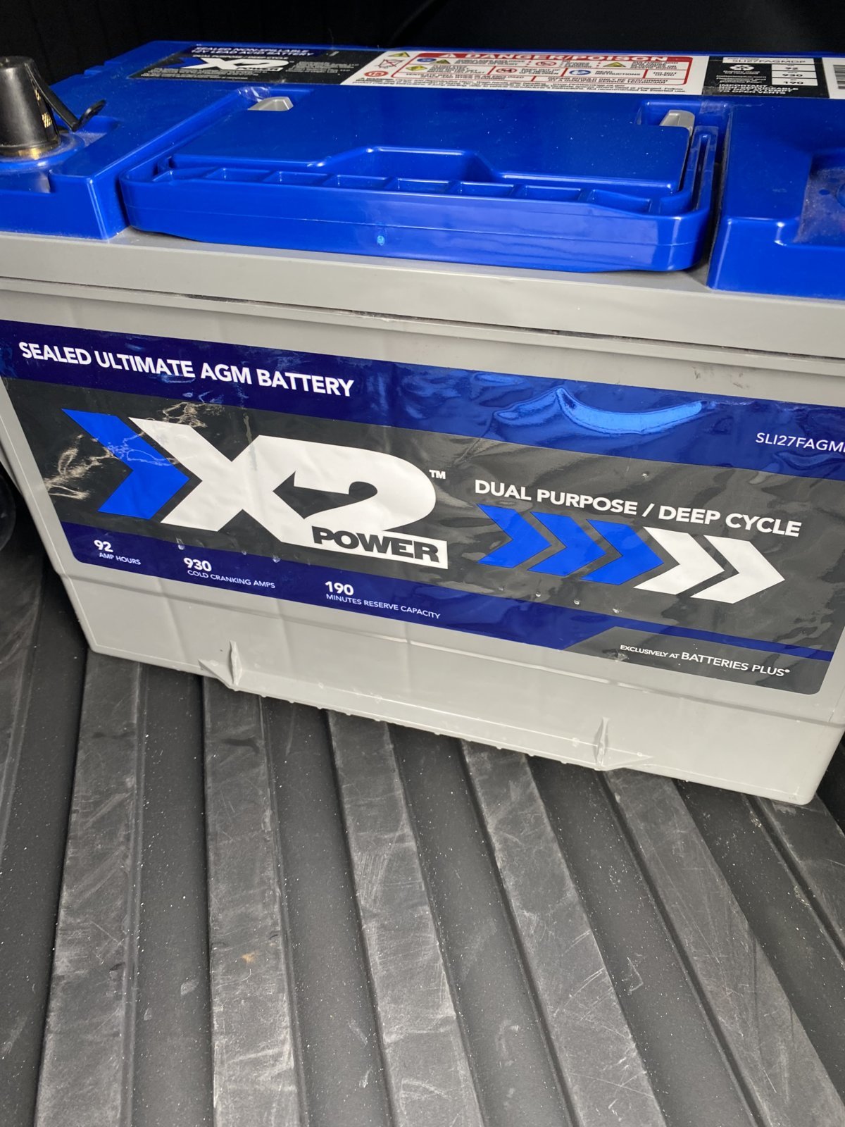

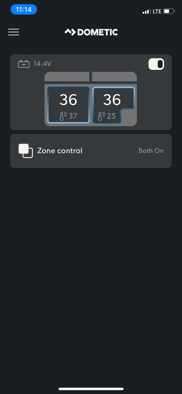

    For me off grid camping running a fridge, lights, and heater. 22% more reserve and AGM’s bounce back better than flooded acid batteries

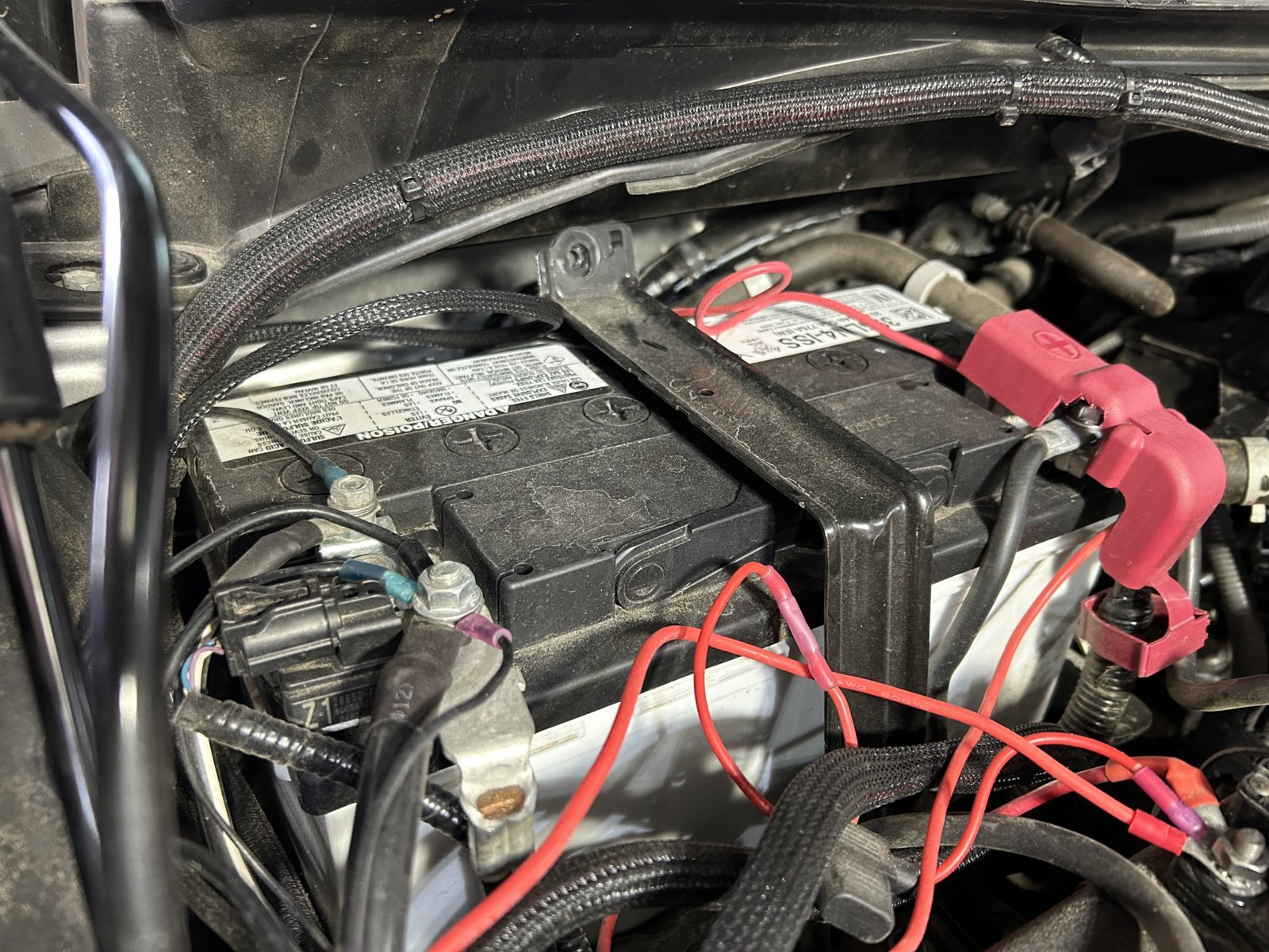

    Haha what’s not shown are my BlueSea circuit breakers which look nice but yes over time a project here and there has added a few wires!
