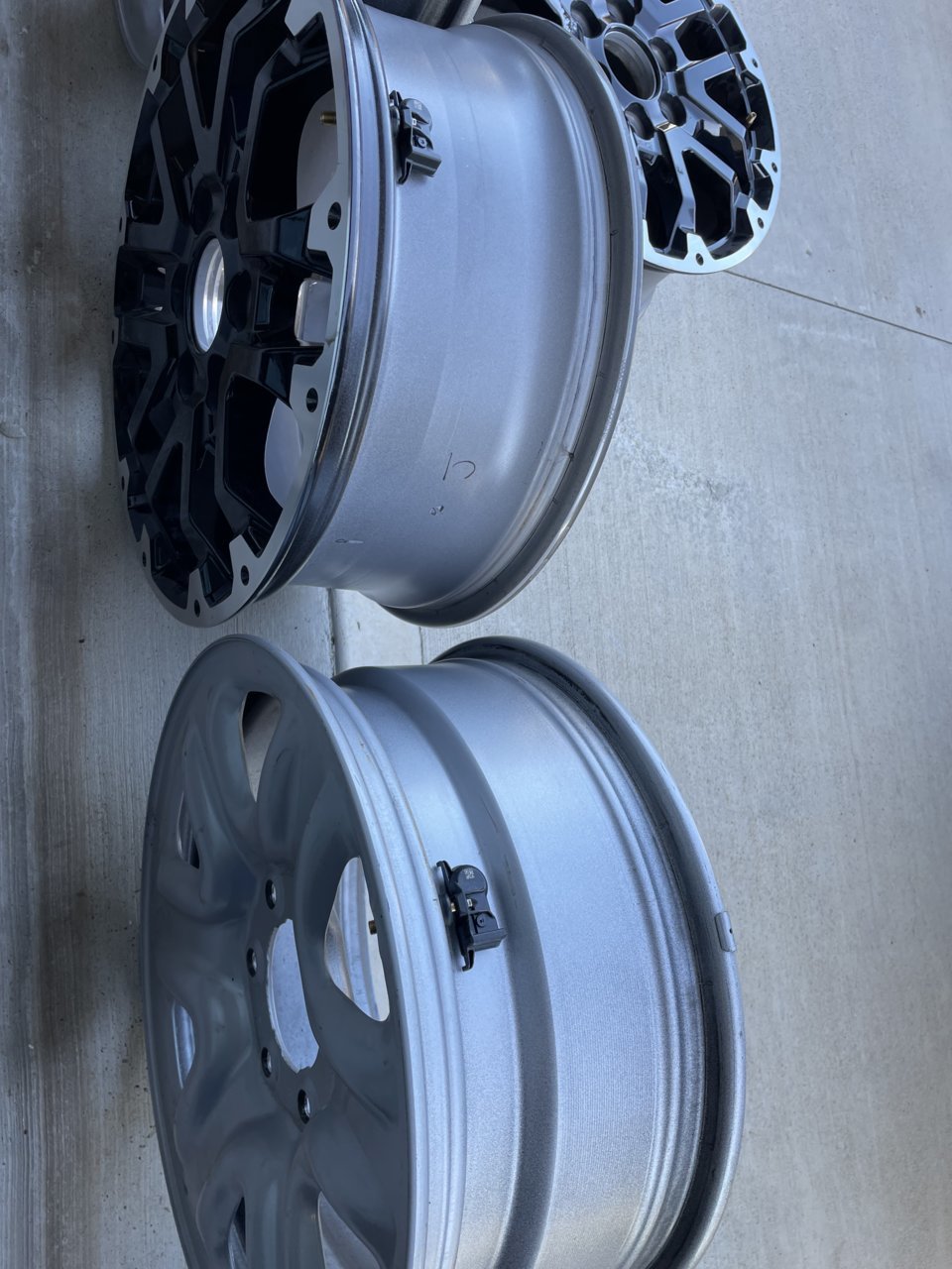

    I can absolutely confirm that the tpms from oem steel SR wheels work and mount perfectly to aluminum wheels.
  15. Jun 9, 2023 at 6:22 PM
    #75
    4mm
    4mm New Member
    Apr 2, 2022
    #76711
    198
    Francisco
    2015 Sequoia
    18” steel wheels & 18” Off Road aluminum wheels, plus 20” TRD wheels.
