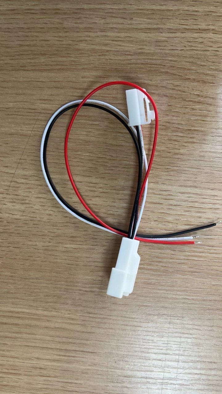

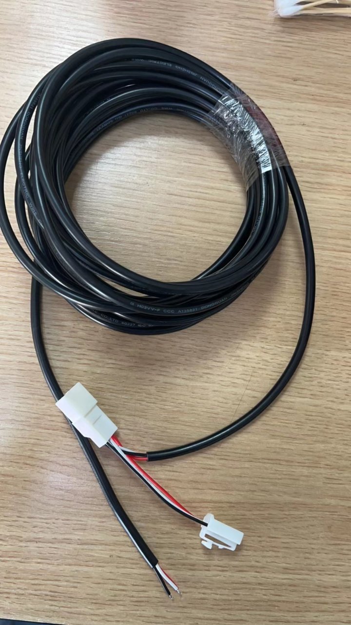

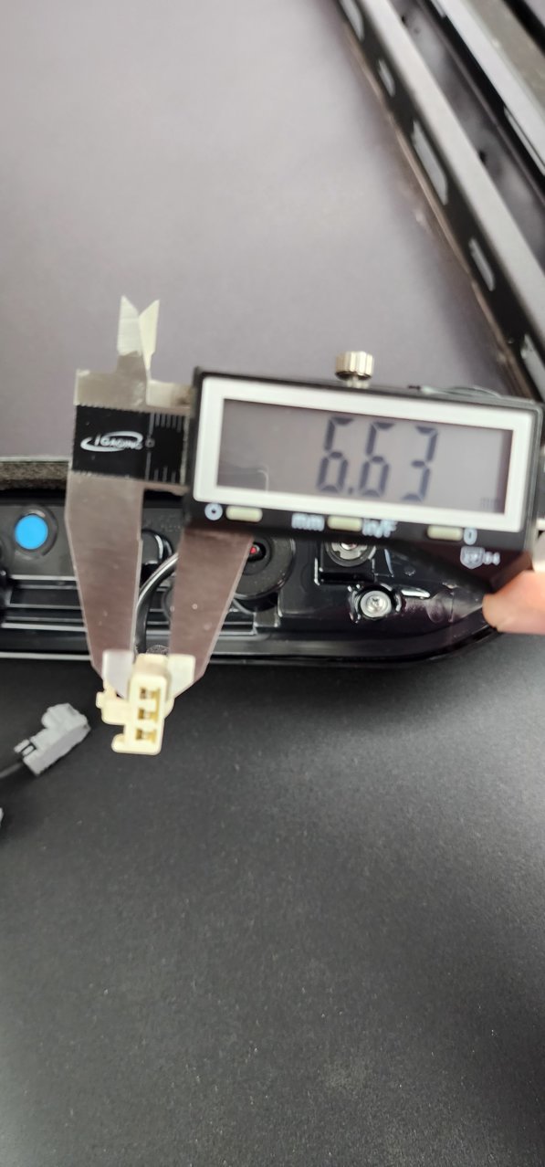

    Hey y'all, I wanted to give a quick update that I got the cables in and they're shipping out now.
    Thanks for all the support on this. Im just glad we can use the mirror again because it really is a nice safety feature.
    I wanted to announce here that I also decided to make a cable that breaks out the brake light and illumination light. It plugs right inline with the third break light. I figure it might be useful for some to get all the topper wiring done at once. Let me know if this is even useful to you, I know you can also just grab the brake signal from the tail lights. Made one with just short pigtails for using your own wire, and one with 26' of 24 awg wire in a cable.IMG-20230226-WA0000.jpg IMG-20230226-WA0001.jpg 20230219_141453.jpg

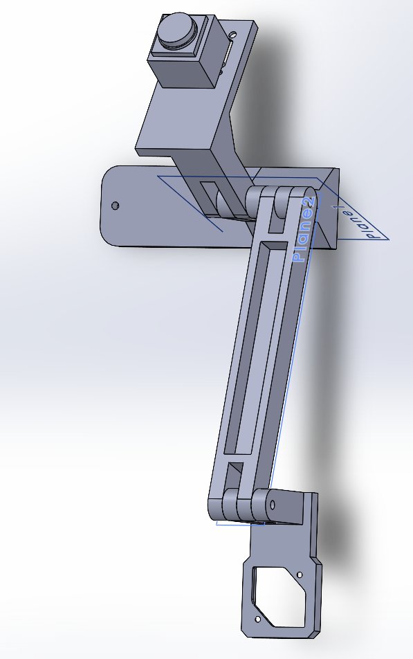

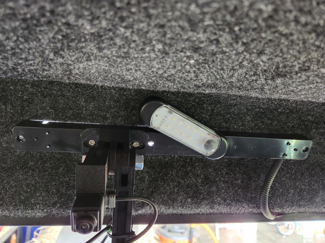

    I'm prototyping that right now actually. I'll send you out a prototype!upload_2023-3-1_22-20-8.jpg
    The first prototype shakes quite a bit. This time I'm scaling it back and reducing the weight to see if that helps.

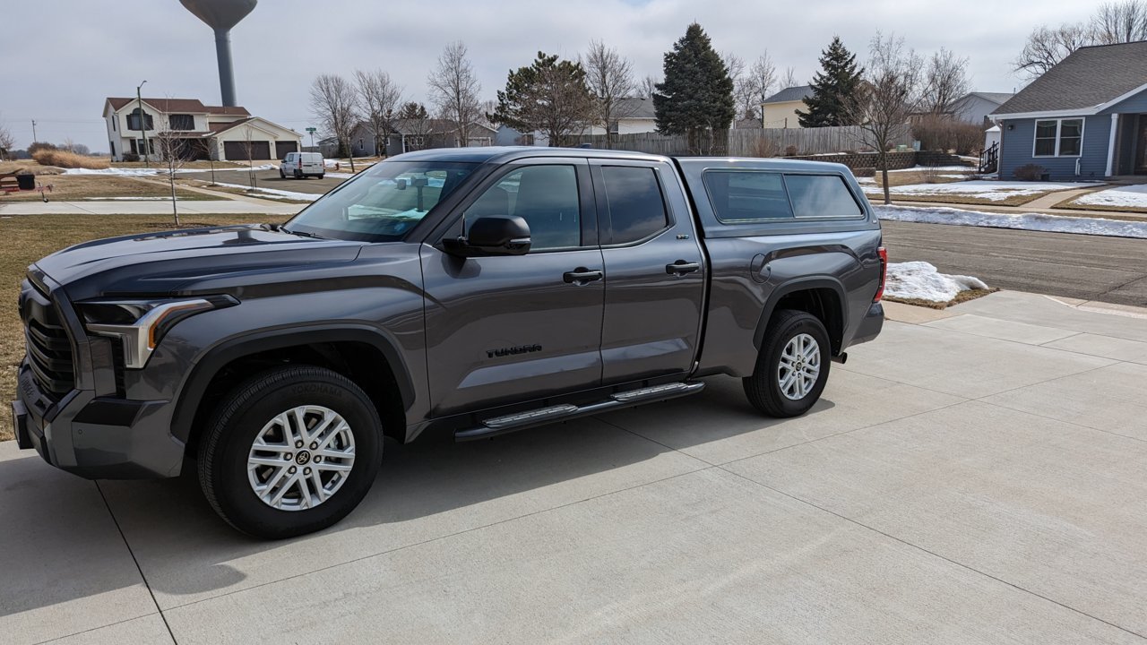

    Just got my Lakeland cap installed yesterday! Got the headliner, pet screens, front slider, and a 42" LED bar for $2350. Only took them 3 weeks from ordering to delivery, one of their first 6.5' caps.

    Dang that's a super affordable! Looks great!

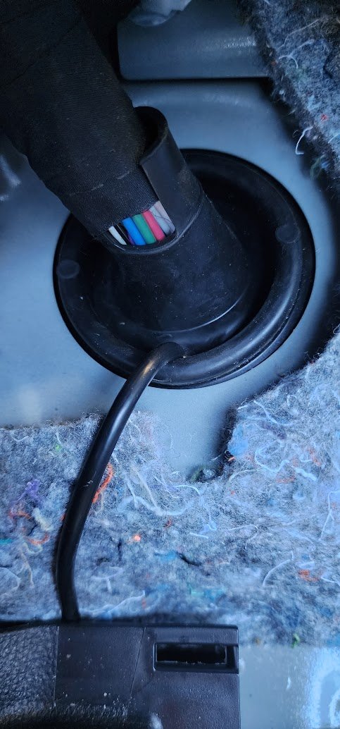

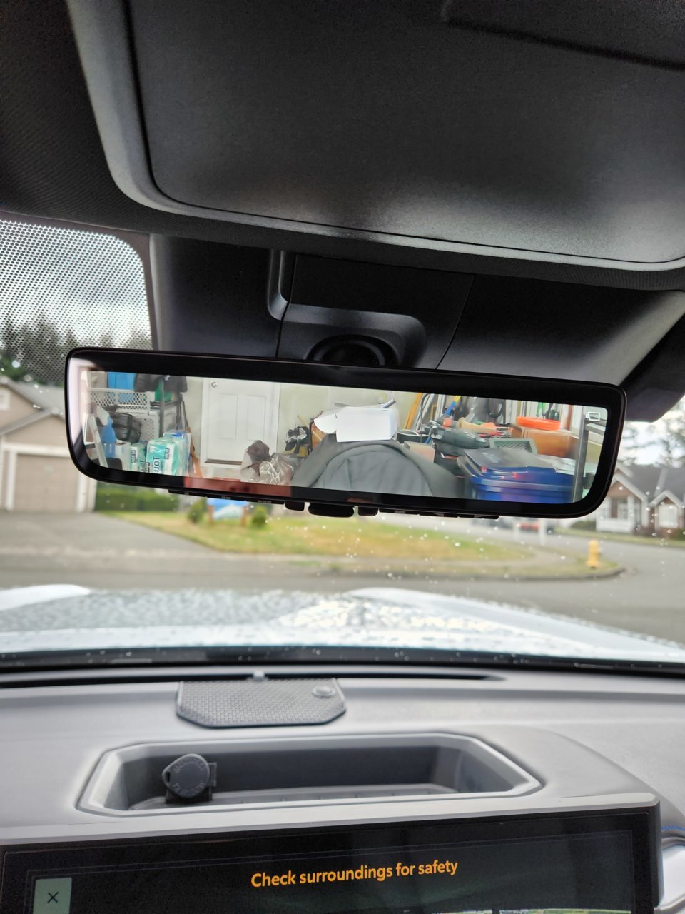

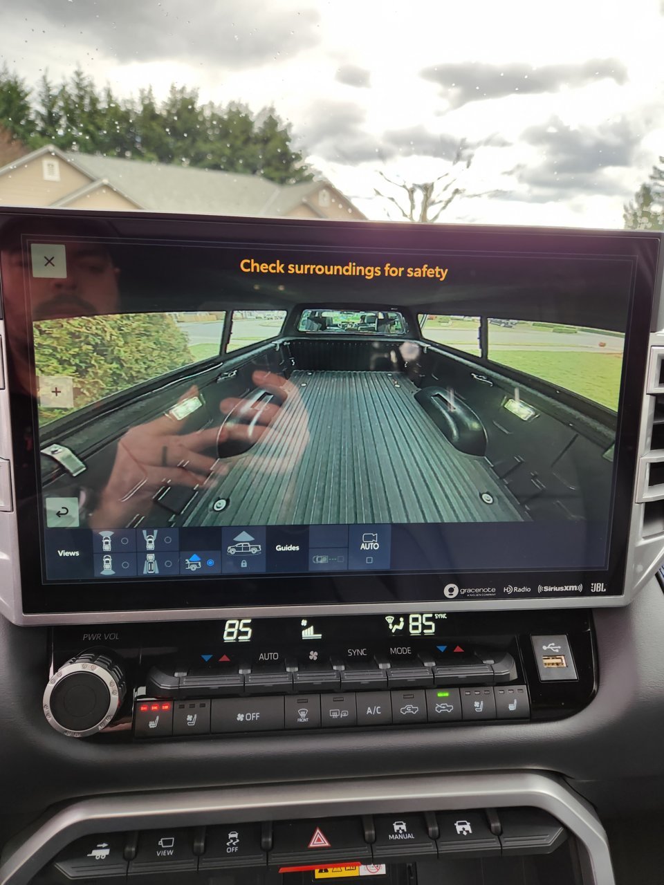

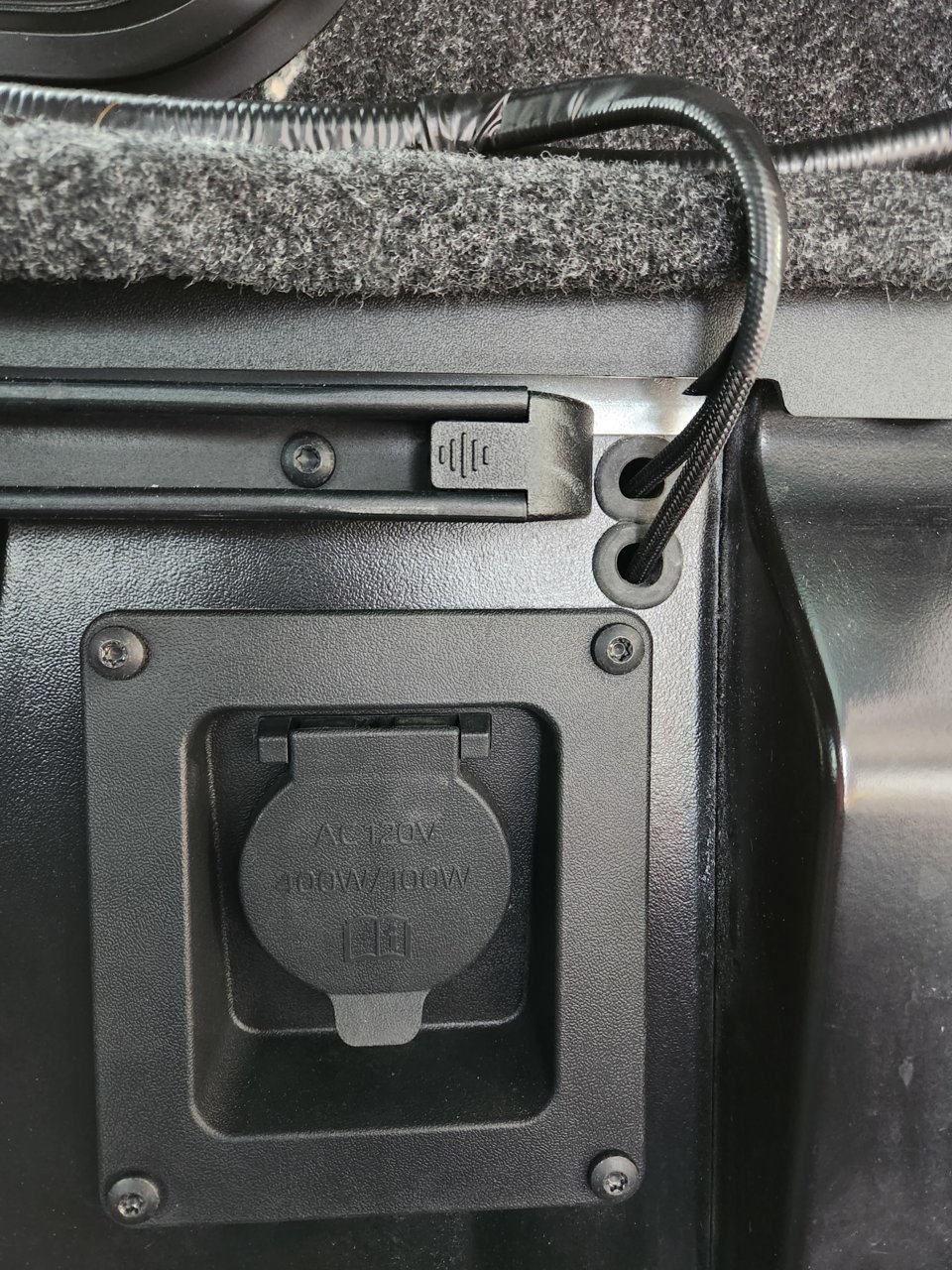

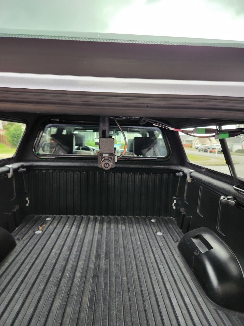

    Installed @GG.Offroad camera relocation kit. Works great, install was easy. Happy to have my digital rearview mirror back.
    On a side note, removing the third break light for removing the camera's would have been easier to do before the canopy was installed.

    @Rusty21 Good lookin install Youre right its a real pain to get the 3rd brake light off once the camper is on. I ended up sliding mine half way back so I could stand in the front of the bed. If the front window flips down its not so bad.

    Nice install! I’m going to have to drill out the bed and add those grommets when i get home this week.
    If you have carpeted headliner get some one sided male Velcro to cover up the wiring- works great

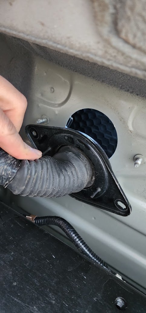

    I have some instructions at www.ggoffroad.com/install
    Youll want to run it down the passenger side pillar trim and wither to the wire grommet that's under the rear seat, or to the grommet that's under the front passenger seat. Then you'll just zip tie it with the rest of the wires that run along the top of the frame toward the bed.
    Under rear seat grommet:
    M5v0-Px_Mfsb8Ltmga_fgAUVceItNpze2Fs2s3tX_e6899abcdd6b1d7c69b314927bd80dcc66f25650.jpg
    17kqJr2blGaKZKNrMB_M1VSJ5n1O9a56QmEVkBrL_fcfb1d1d62a2bf02244a2231a2ec21a1de031d9b.jpg

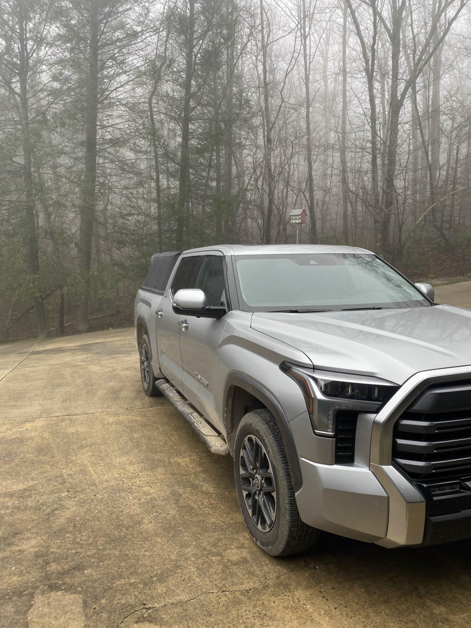

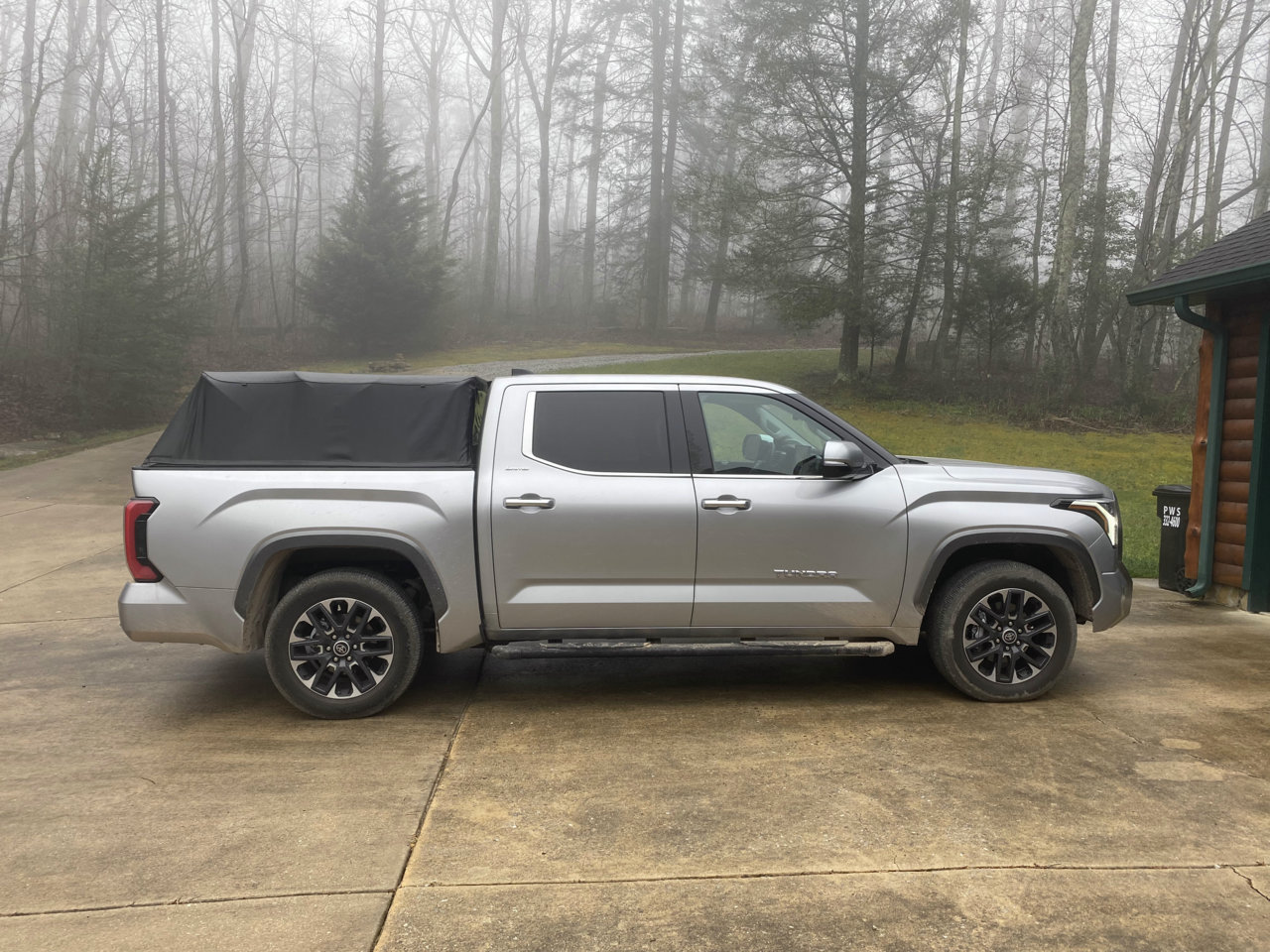

    Been using the fas-top solo for the past year. Upgrading to a leer 100XR when it arrives next week.

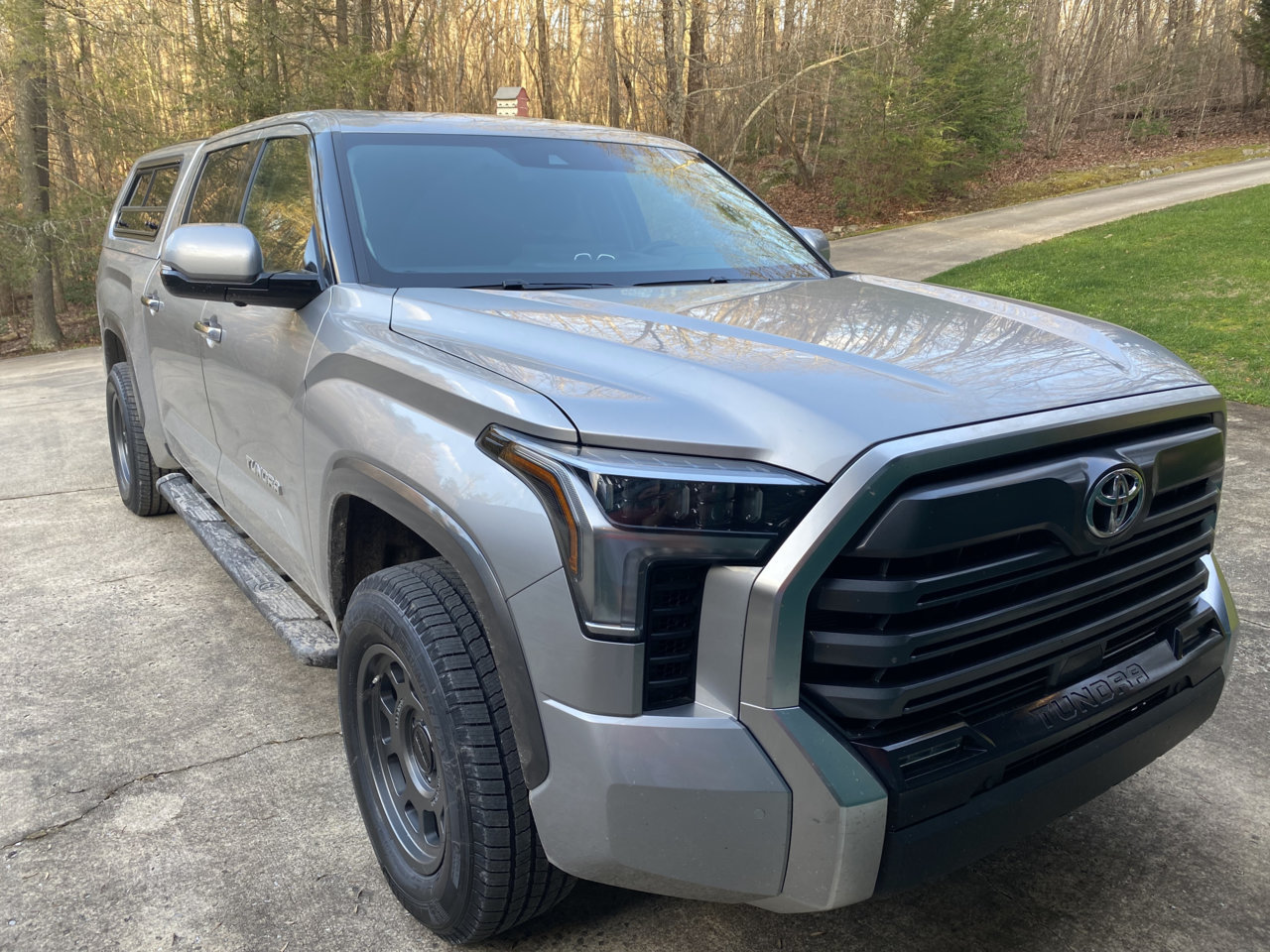

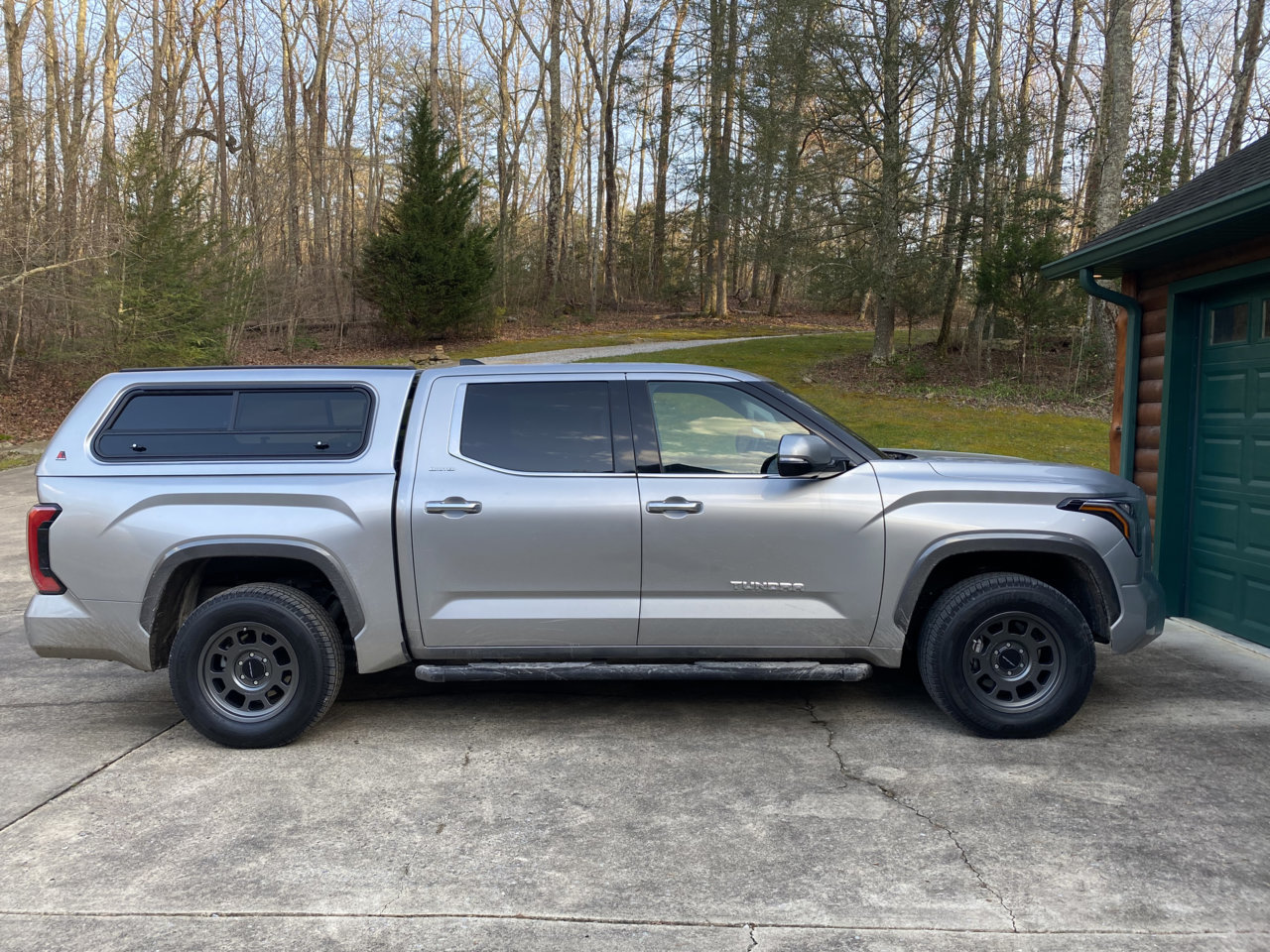

    Got the Leer 100XR now and some new wheels. I'd like to get the camera relocation kit mentioned here, but I am not sure of the best way to make the install clean. Would like to see some more examples. @GG.Offroad do you use a single bracket to mount both of the cameras?

    Yes the bracket im sending out is for both cameras, If youre separating them in can send you two. DM me
