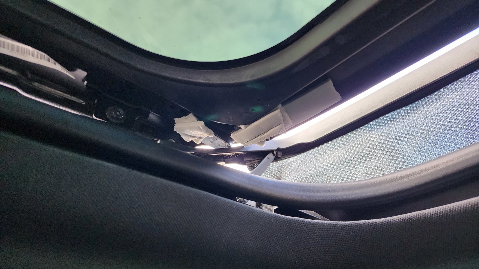

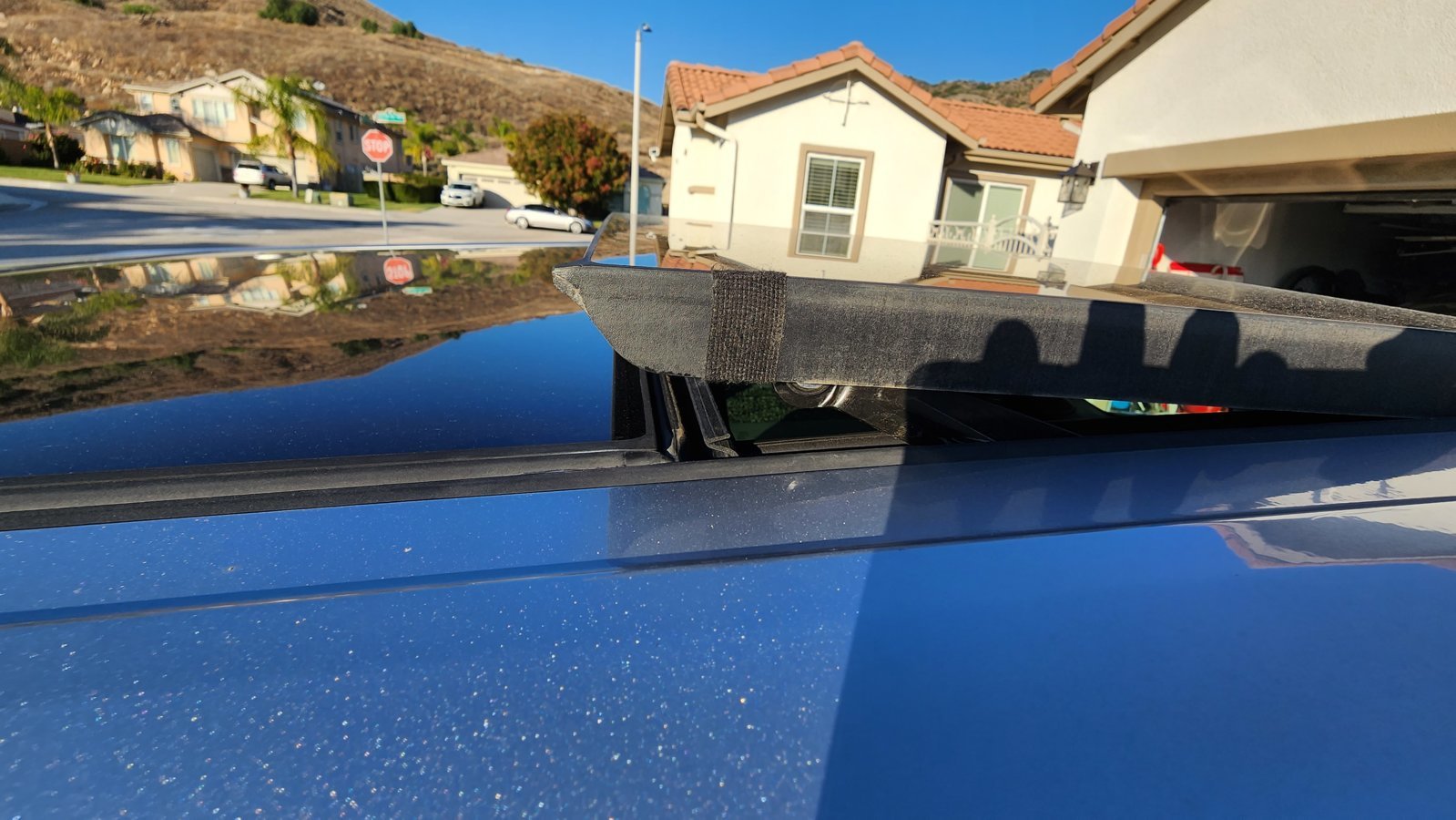

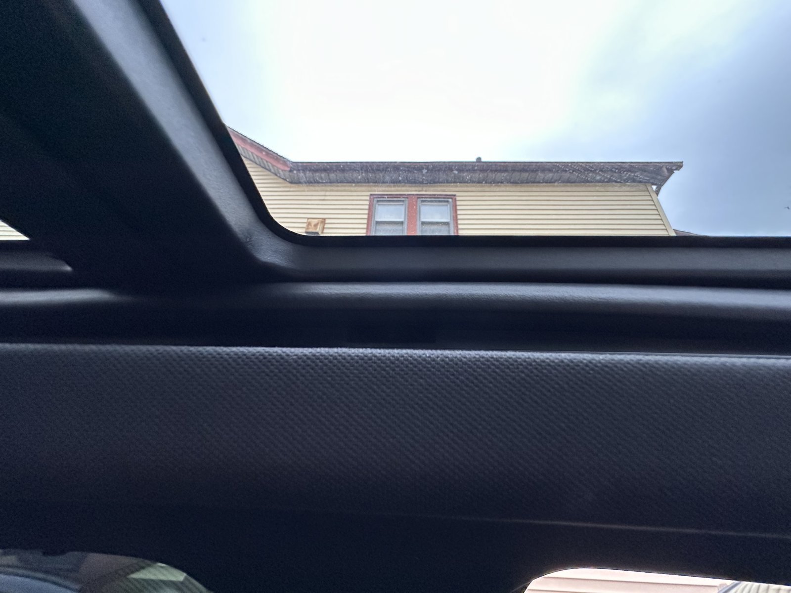

    Well for anyone still dealing with this issue, I have found a fix, at least it works on mine. Anyone else’s mileage may vary but it’s worth a shot. What I have done is the weatherstripping on the inside that runs along near the headliner, I removed and pushed it up to were it sits along where the opening meets the back, which prevents the back from bouncing up and down. I’ve tested it for a few weeks now and haven’t heard the dreaded rattle since. Attached is the photos on how I have it set up, driver and passenger side. Yes it’s not the most ideal way but it beats having the dealer rip apart the headliner. Mine won’t even touch it without opening a tas case which I never hear back on

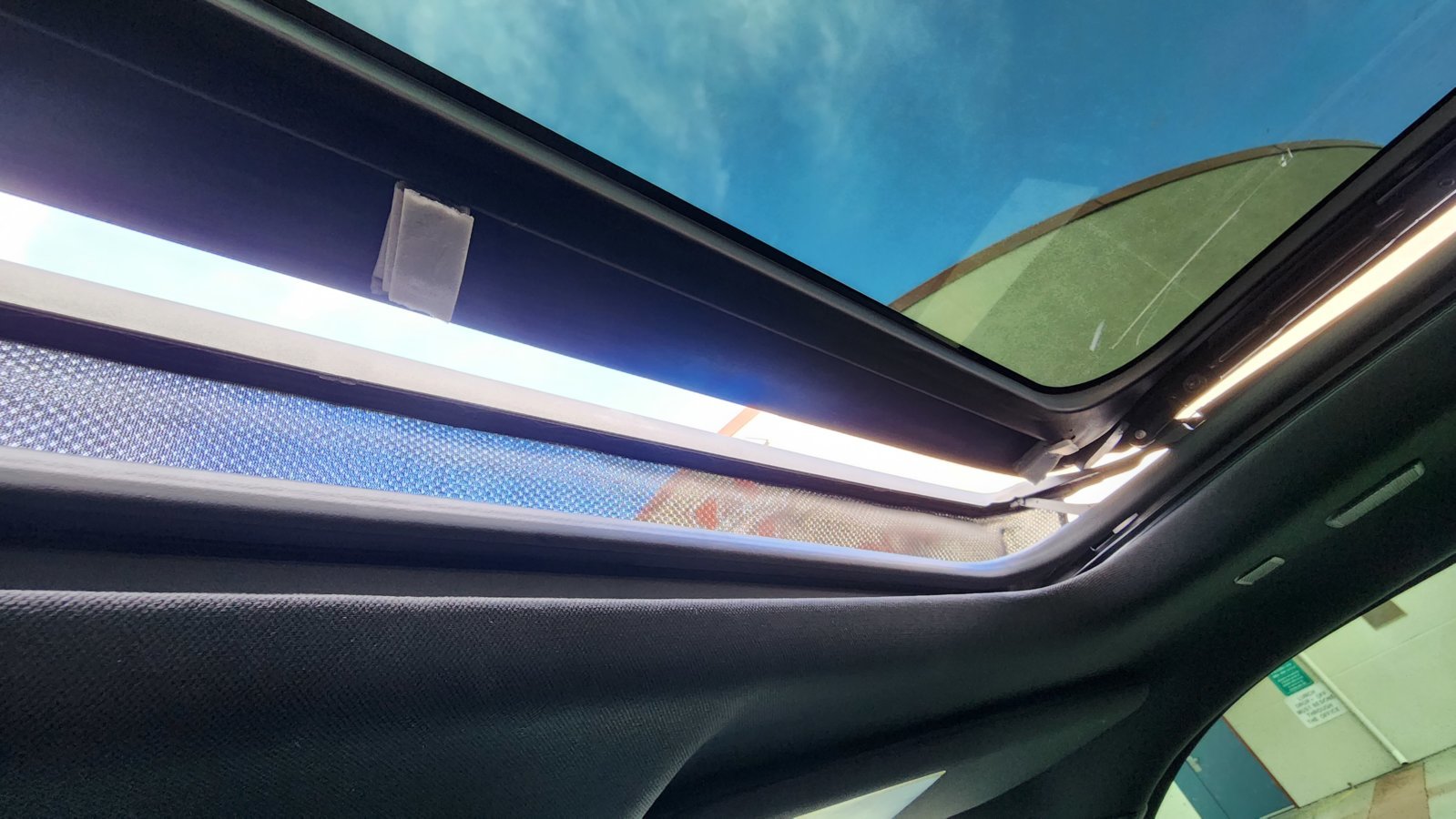

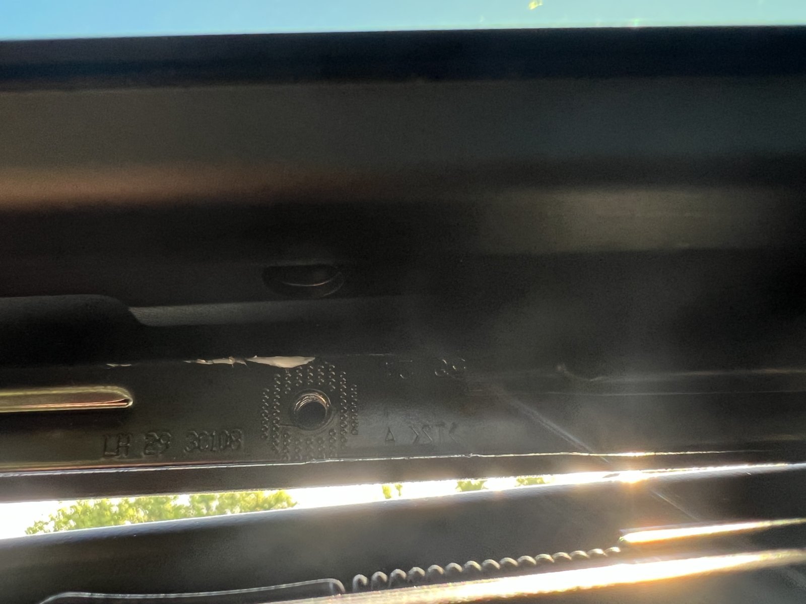

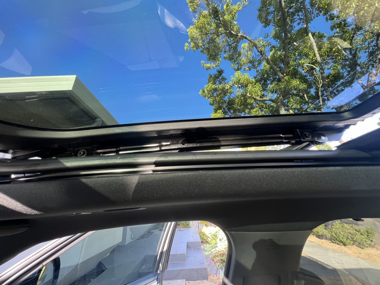

    So that didn't work. Did this and it definitely got rid kf the rattles. Seems like the rattling comes from the pop up wind screen slapping the glass frame.
    Added foam strips at those spots and rattling is gone. Will look for some thicker/denser/black weatherstripping to pretty it up.

    yeah I’ve tried that spot and that wasn’t it for me, it’s the back flopping up and down not the pop up wind screen

    I did not, but did notice that the adhesive on the foam I bought doesnt stick to well to it. Once I got it on there and closed the glass, the compression provided seemed to help. BTW, rattles ended up after my post....I believe it's due to the foam compressing and no longer providing any cushion. I then ended up putting 2 layers of foam along the back of the glass where it meets the stationary glass. This has been in place for 2-3 weeks now and the rattles are gone.
