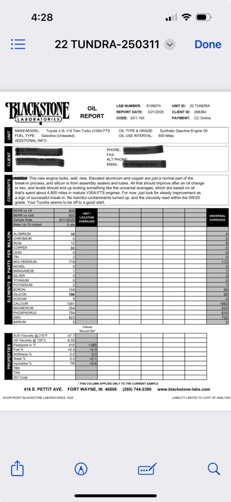

    Quick update on my new long block. Driven 850 miles with no issues and changed oil at 600 miles. Plan to change again at 1500 then every 3-5000. Below is Blackstone report forthose that enjoy tracking/comparing oil data. Wondering how it compares to original motors with 500 ish miles.
