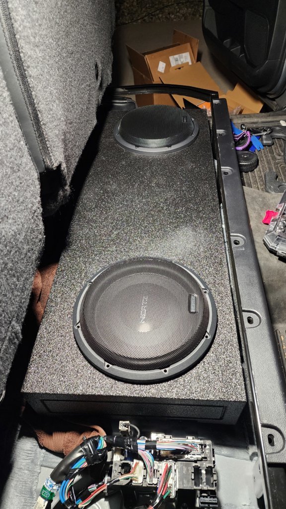

    Ordered the Rockville underseat box and 2 Hertz MPS 250 subs...got them cheaper than JL 10TW3's and they come with a grille....hope this fits

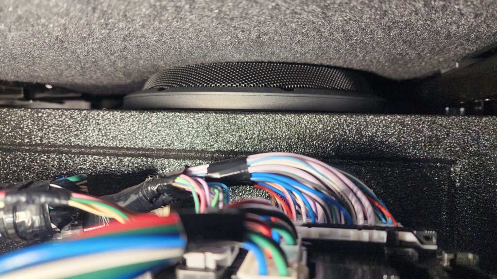

    Well, they "fit"....had to take out the storage bin and jute padding. The grills BARELY touch the seat bottoms. I'm going to recess the subs into the box (5/8" baffle) to give me the space I want. This box is deeper than necessary, so I have room. Plan is to run my lc2i pro, epicenter and epic1500 amp where the JBL sub is at and keep the oem panel. Going for stealth install.

    Made progress on my amp rack. Its a bit too wide, so I will trim that down and then add the round over. Cant tell its there unless you really look through the grille...exactly what I wanted. Bolts are too short, so will need some M6-1.0x25 or 30mm.

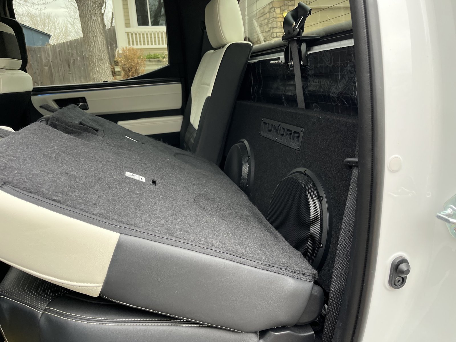

    I have the same box with RF P3SD2-10 but I’m having a problem with them as they hit the rear seat. did you change anything on your box so it does not hit. I see that you even installed the sub grill and they still fit. In just not sure how mine are hitting.
