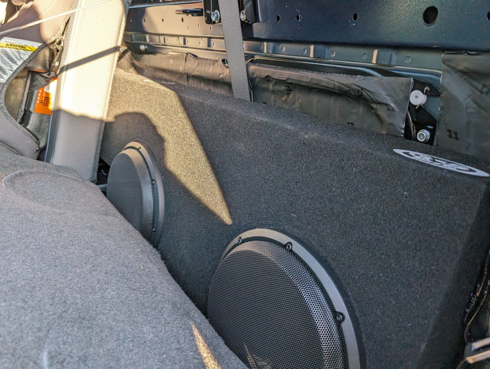

    +1 to @mattvarnell's comment - the JBL speakers are decent, subwoofer excluded. I'd love to
    One heads up about this particular setup; as can be inferred from the picture, the grill on the center sub (farther away in the picture) is pushed concave due to how hard it was being pressed into the rear seat. If the subs go over roughly 50% power input, you can hear that sub rattling against the grate. Admittedly, I don't push them that hard too often, else everything else in the truck is rattling as well.
    ... Anyone have any advice on how to sound dampen a Gen3 Tundra? :)

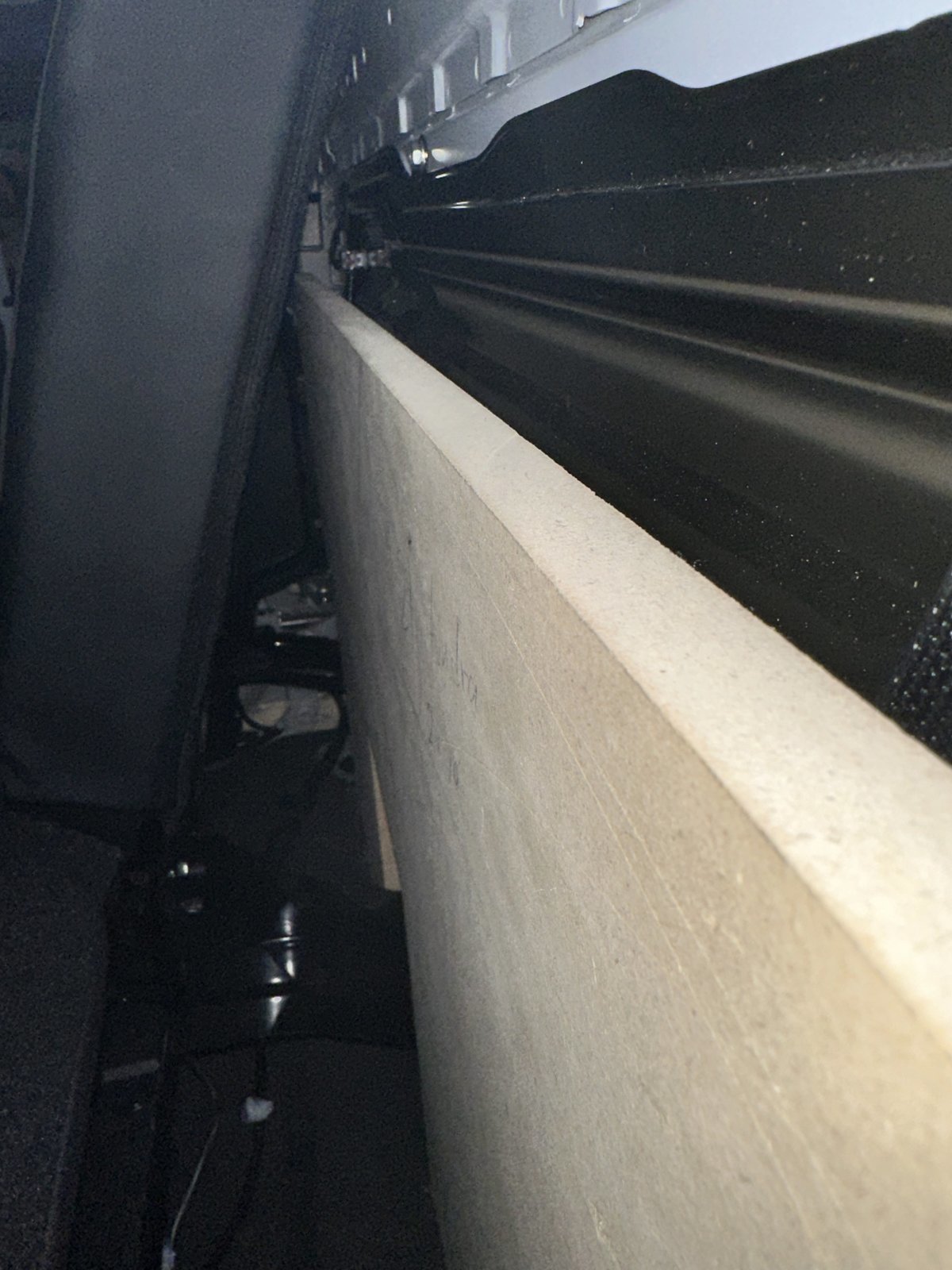

    @Baldilocks
    Just came across this forum and want to say thanks for sharing your blue print. I am gonna attempt to recreate it as I have 2-JL 10W3-D4’s.
    I mighta missed it but what width was the top of the box? I see the depth at bottom is 4.5”, but I noticed a slant for the top.
    Thx

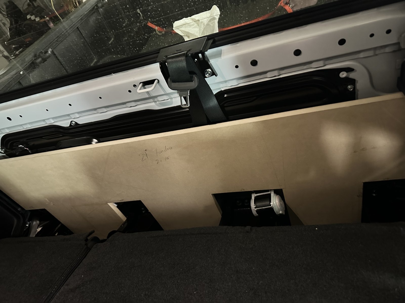

    Got the back panel made to dry fit, at 21.25” height it’s snug as a bug up top, did your seats lock back after you built this? @Baldilocks

    yes they lock back. The center seat takes some extra effort but it locks.

    If you follow my measurements, do not add carpet as it it PITA to get in / out.

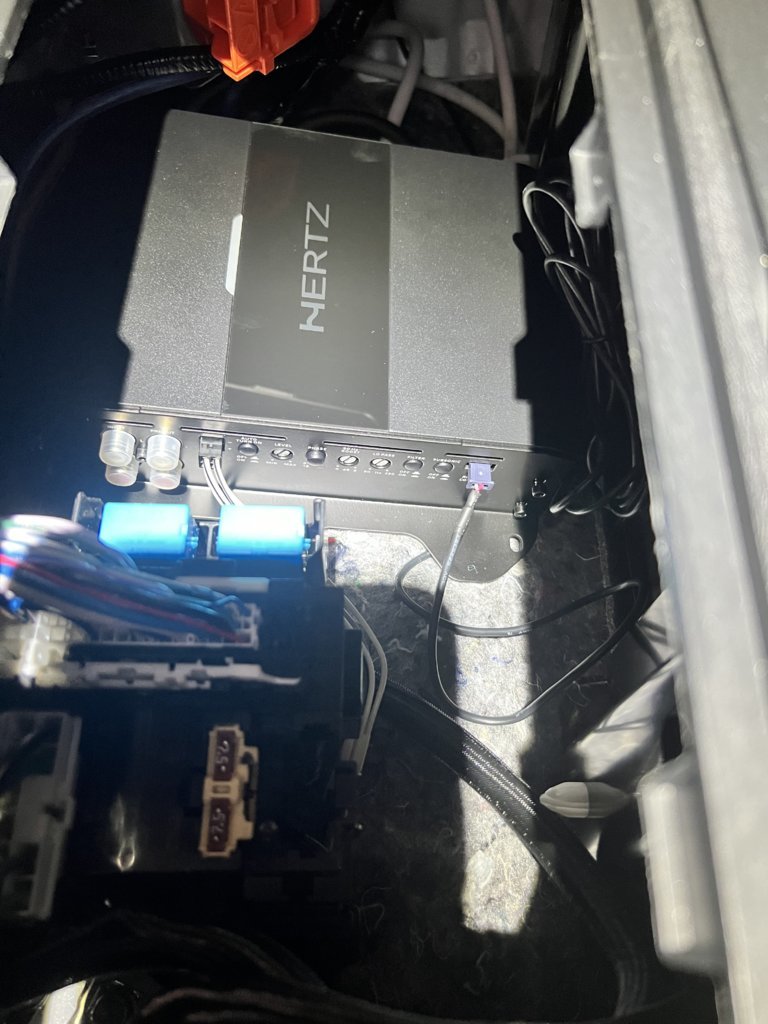

    I had my DSP in the corner of the right rear. Over time the jostling would casue the wires to come loose. After the third time of I just moved it to my under seat storage with amp
