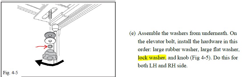

    The hand screw bolt for the cover dose have a lock washer with it. For the ones that are having them loose, is the lock washer there?
    KroppDuster likes this.

    Maybe there are some inconsistencies in the manufacturing? I see so many folks having varying experiences with their covers that it makes me wonder.
    All I can speak to is my experience. I installed mine on Jan 15th, 2022 and I had it on for 13 months & 17k miles. I folded it up a lot for dump runs. Especially for the first 3 months when I was doing dump runs weekly and carrying large payloads of materials (we were doing a remodel at the time). I just took it off & sold it about 2 weeks ago after I had my Leer 100XR cap put on the truck.
    When I took it off, my 2 knob nuts were still very tight and I never had an issue with them being loose, the clamps unlocking, or anything else that would make me feel it become unsecured. I think Toyota telling people to remove the cover is primarily their legal department just being overly cautious & trying to mitigate any legal liability. That's pretty typical of any major company nowadays.
    I feel like if you follow the 3 bullets below...you'll 100% fine to leave it on until the remedy comes about.
    • Make sure the cover is aligned properly (i.e. plumb) so that each locking clamp gets equal purchase on the bed rails, it should be fine.
    • If you fold it up and find your knob nuts loose...tighten them. Want to go the extra mile? Dab a little bit of purple vibra-tight or loctite on the threads.
    • If you fold it all the way up, make sure it's resting firmly against the cab when you secure it with the arms and that it does not act like a fulcrum that forces the forward portion to pull away from the riveted mounting plate.
    Regarding the 2nd bullet...ensure that your lock washer & rubber washer is present too. The rubber washer should also help to act as a vibration isolator.
