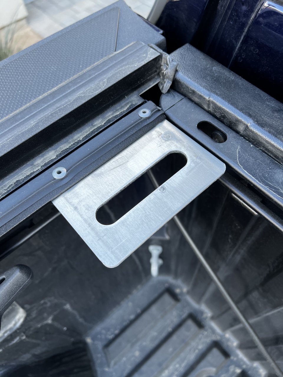

    I took my cover off before going to the dealer for service. This aluminum piece dosnt move and is riveted to the rails, the rivets are the only thing holding this cover onto the truck after you tighten the handle bolts. As for talk of refund, the cover has gone up in price in Canada so I would rather have a replacement and not a refund then have to pay the difference on price.

    That's a pretty poor mechanical connection to the rails. Yea rivets can be good, but there those rivets are serving to hold the bracket from front/back and left/right force much more than up/down force. I think their design is flawed from the get go. IMHO.
    Yea, if they are instructed to take the covers off of any vehicle before selling, then how can they also not refund for those purchased from Toyota?

    They should handle it the same as a 1st owner. Similar to what @donmartin mentioned. Because Toyo only has visibility to the trucks that had it as a factory/port-installed option, they will send a recall letter to all owners who purchased their truck prior to the recall going out. If your truck as the OEM part on it, whether your dealer installed it, you bought it from a Toyota parts desk, or you bought it 3rd party...you'll get the remedy all the same.

    good pics, ya thats kinda shitty
    for example the undercover uses a big bolt and then a clamp to the side rails, I think its a much better design.
    perhaps this is where they cut some costs to make them for toyota. I wonder what the OEM BAK ones look like right there.
    anyways, Im glad they just took that off my build just now, Im fine with that, I didnt really want a 1300 cover in the loan anyways.

    Not to scare anyone, but a point of clarification...
    The rivets are the only thing securing the cover to the truck, when it's in the full "folded up" position. Otherwise, when the cover is down it's secured to the truck in 4 additional (6 total) places with the locking mechanisms. My 6.5' bed had 2 sets of locks that interlock with the deck rails.
