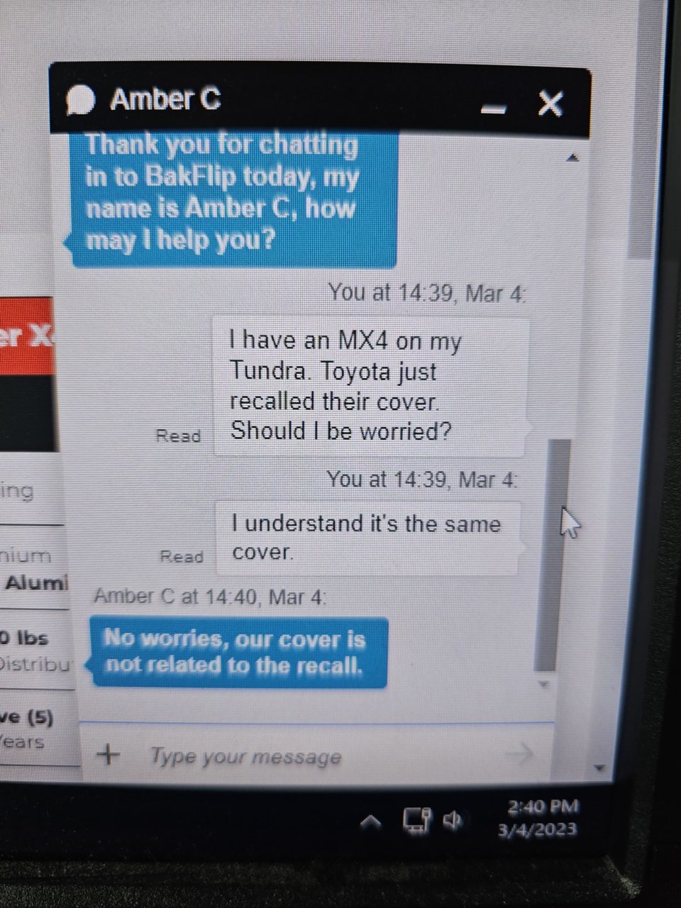

    MX4 owners: For what it's worth.
    Maybe Toyota cheaped out on hardware?

    Do we believe this? Would it really be true that a Toyota accessory MX4 be different than a BackFlip MX4? I suppose it could be, but seems unlikely that Toyota would mess with something like this. IMHO

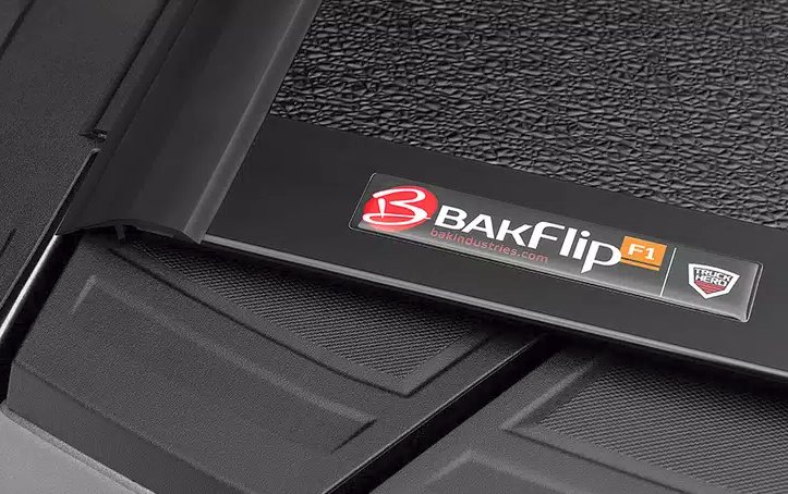

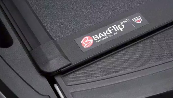

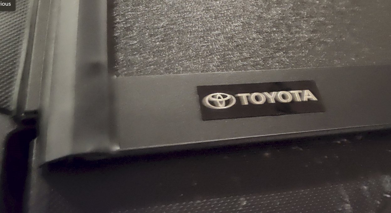

    I think is it more like the F1 than the MX4, everyone keeps saying it's an MX 4, but if you look at the back corners:

    My understanding was the OEM cover is a mix between G2 and MX4 components.

    My guess is it's the MX4 with some of the less expensive finishes of the F1 but who knows?

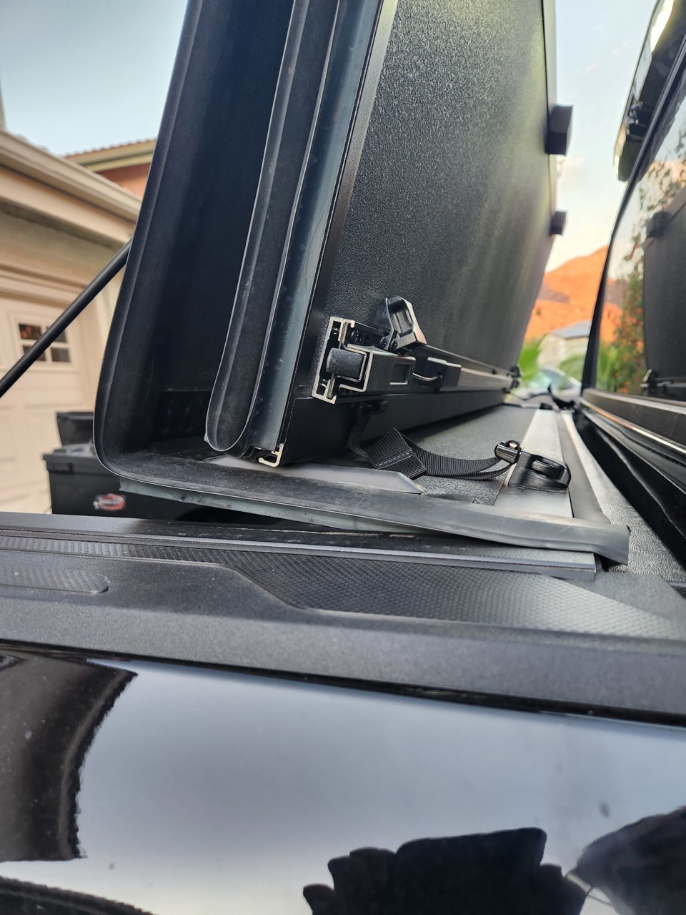

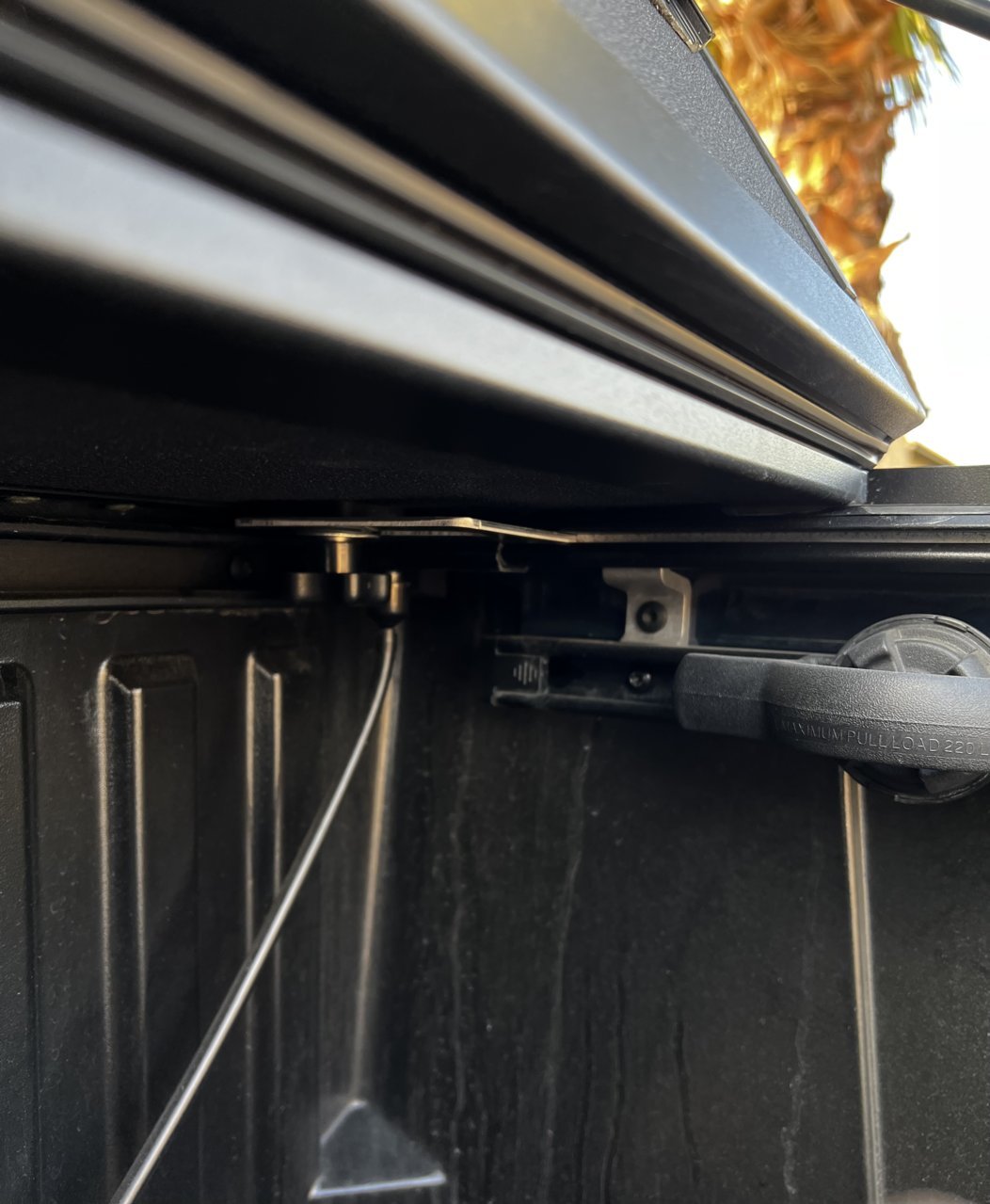

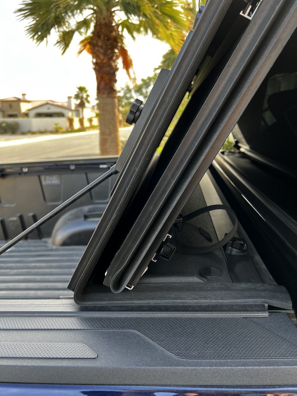

    Well its about time! So here is the deal. I purchased the Toyota Tonneau cover from the parts department late last year and installed it myself. I was driving one day on the freeway with it in the UP position an noticed it was lifting off the bed. I checked those knobs and they were snug but not tight. I tightened them down further to the point it was going to bend the bracket. The support braces were also as tight as they could be. Continued driving and it still lifted off the bed. You can make it lift off when stopped just by pushing it away from the back window as the wind would do. I took pics and went to the dealer. They were unwilling to help because I installed it. I also contacted Bakflip who did confirm they build them for Toyota and it is the same as their 448440. They never called me back once I sent my pics! Now I know why. If you have one put it in the up position and see if you have the same problem. It is totally fine in the flat position and I've never had a problem. I have not used it in the up position ever since as I've been concerned about it tearing off and hitting someone.

    I’d really like to know if other people drive with it in the up position and are fine or not. Is that a one off issue I wonder.
    I have the cover and planning to install it, but if I use it like my Tacoma, I’ll want to drive with the cover up fairly often.

    That would be great if a few people who have them could check. All you have to do is pull it away from the back window. Note this only happens to me in driving conditions above 65ish or slower if you have a headwind. Around town it is just fine. Mine is PT954-34220-02 which is listed in the recall docs. In my opinion the bolt is mounted too far foward and there just isn't enough bite to hold it down.

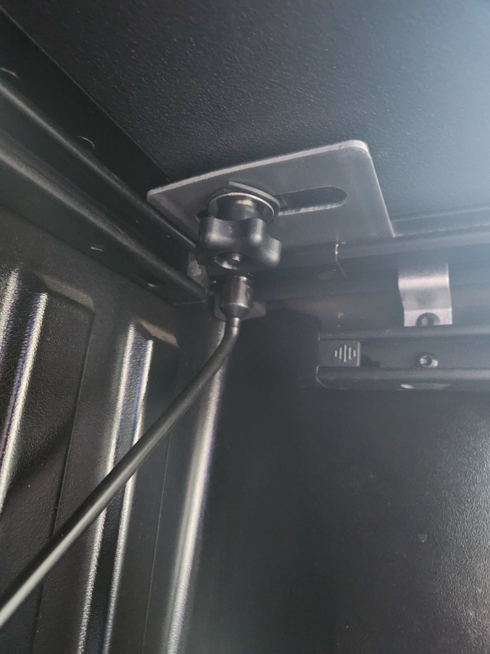

    Now this is interesting. Look at the difference between this bracket and mine. Mine is not flush almost as if they installed it upside down or on the wrong side. This bracket is pre-fabricated so there is no way I installed it wrong. I wonder if that is the issue?

    It’s only going to fly off in the up position without having anything to brace it to the truck like a box full of furniture. The cover is heavy and it did not have any movement up, I did have my tri fold cover on my Tacoma come off this way in the past.

    This is the first thing that makes any sense. No way this thing is coming off while it is shut.

    Experienced the same issue the first time i used the cover in the up position. No matter how tightly I secured the bolts, the struts, or the clips, the cover is still pushed about by the wind with any kind of mild speed.
    Checked the recall site but nothing listed yet.
