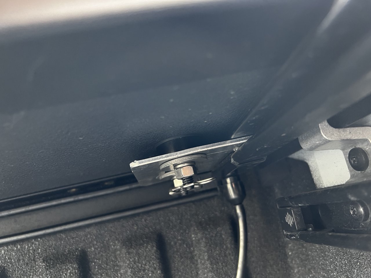

    Just had my recall done for the tonneau cover. The original hole does not sit flush with the new bolt. The gasket looks loose and may leak. Will have to take a look at it when I come back from vacation. The second bolt gasket sits flush with the cover.

    Can you take pictures from underneath to see what it is they did there?
    Is there 2 bolts per side now, did they do an anything to the bracket those bolts attach to?

    2 bolts per side. They just added another hole and different bolts. Different nut and has a safety pin to prevent the nut from fully backing out. Added spacer to prevent the bolt from over tightening and crushing the cover. Which was the issue with the old bolt and nut. That’s why my original hole doesn’t sit flush now. Didn't touch the rails.

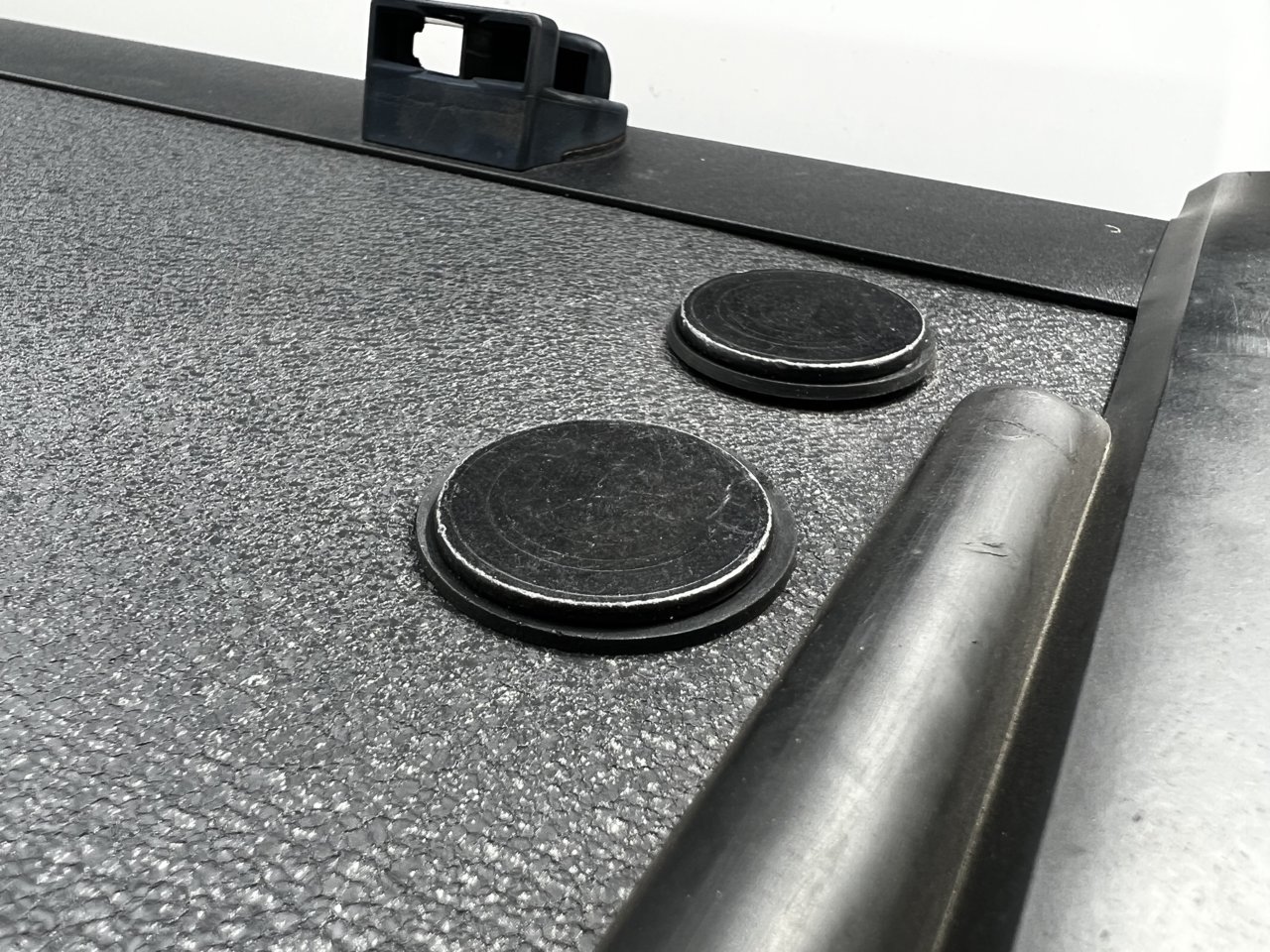

    Friend has a 2024 Tundra purchased in April. He bought OEM tonneau cover through parts department and installed. Then decided he wanted a topper. I’m assuming the tonneau sold by the parts department in April/May would be clear of the recall issues? Any help is appreciated. I’d like to take it off his hands. Thx!

    It's honestly a very easy self-fix.

    If it has two hold-down bolts per side up at the cab end it has the recall fix. If it has only one per side, it doesn't.
