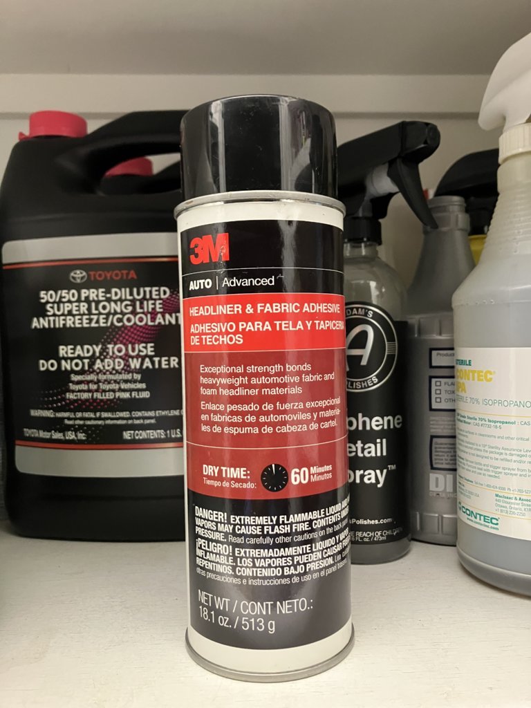

    My 2008 started to sag, i taped off the window and dash, used spray upholstery glue on the ceiling and just pressed the fabric back up. Been holding for two years now

    what glue did you use? mine is starting to do this behind the passenger side sun visor

    Nice, thanks! Still holding another 2 years later?

    still holding up and no foam headliner material falling anymore.

    Awesome, thanks! Amazon got some coming Monday, hopefully it hold and stops this deal before it gets worse. headliner hanging down looks so damn trashy smh.
