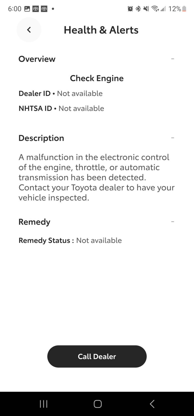

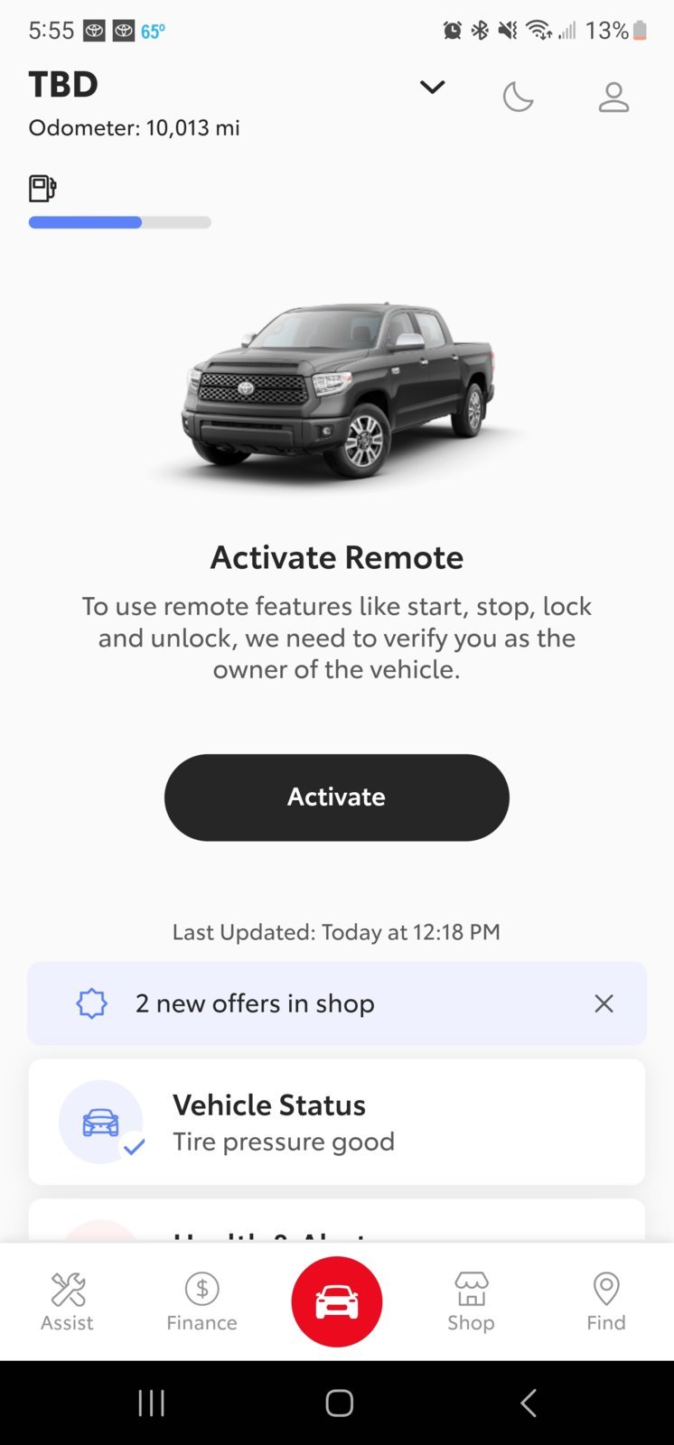

    Interesting little development. Won't know until tomorrow if it pans out though.
    I got a call from a Toyota dealer this evening because the truck called home to notify about the check engine light. I was like whaaaat how did you know to call me lol. Apparently the truck was still under the trial period for Connected Services or something. I downloaded the app and it shows a last update time of 12:18pm today. Which is shortly after I left the body shop. I think I left closer to 11:30. Anyways, I'm wondering if it took some time with the new battery in for some electronic modules to become active again? Fingers crossed for tomorrow. Techstream from Amazon supposed to arrive by 11am. Got my toolbag packed.

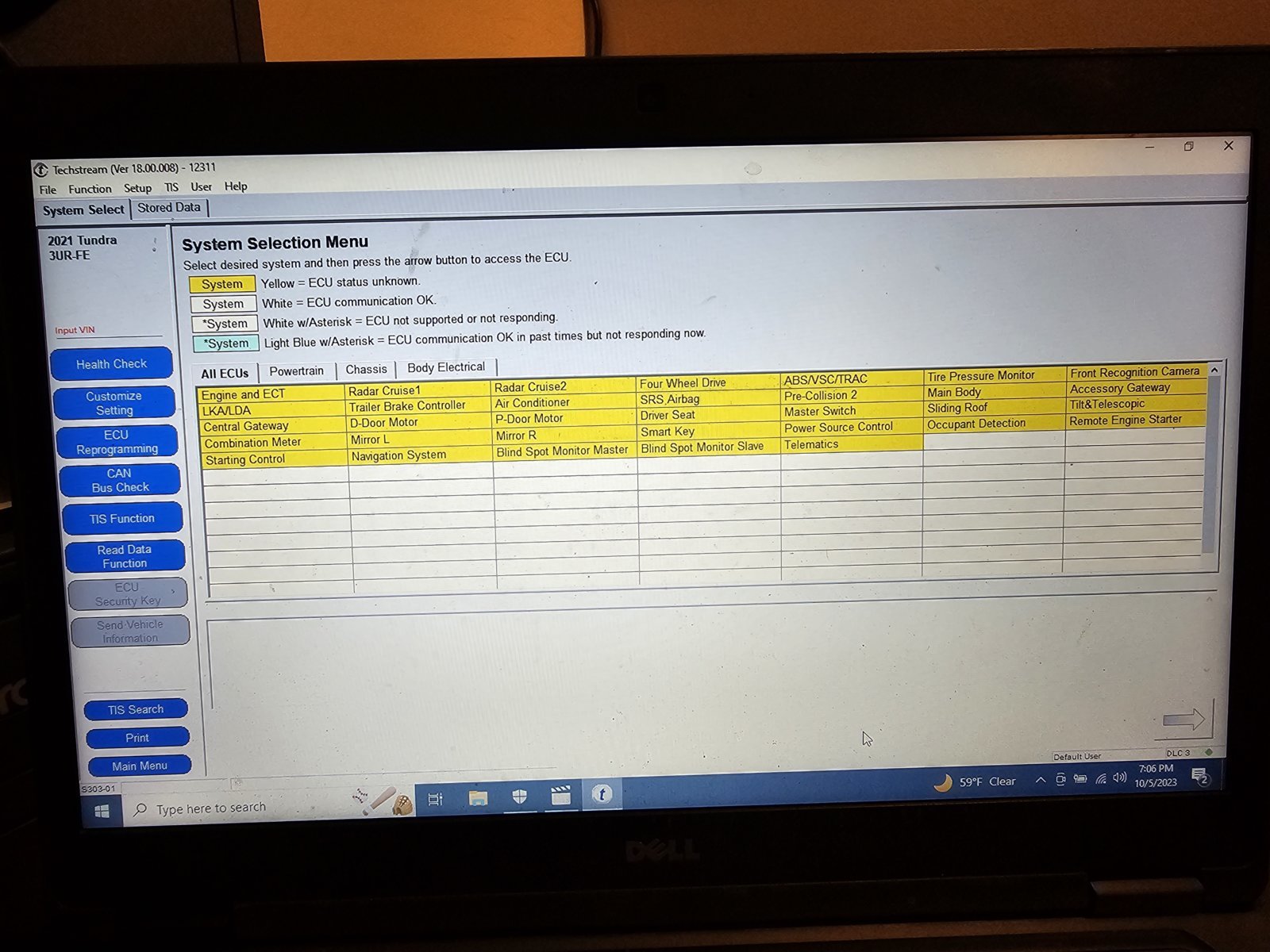

    Didn't make it to the shop today but I called them and had them do a test start. Same issue remains.
    Just finished installing Techstream. Hopefully it pinpoints the issue tomorrow

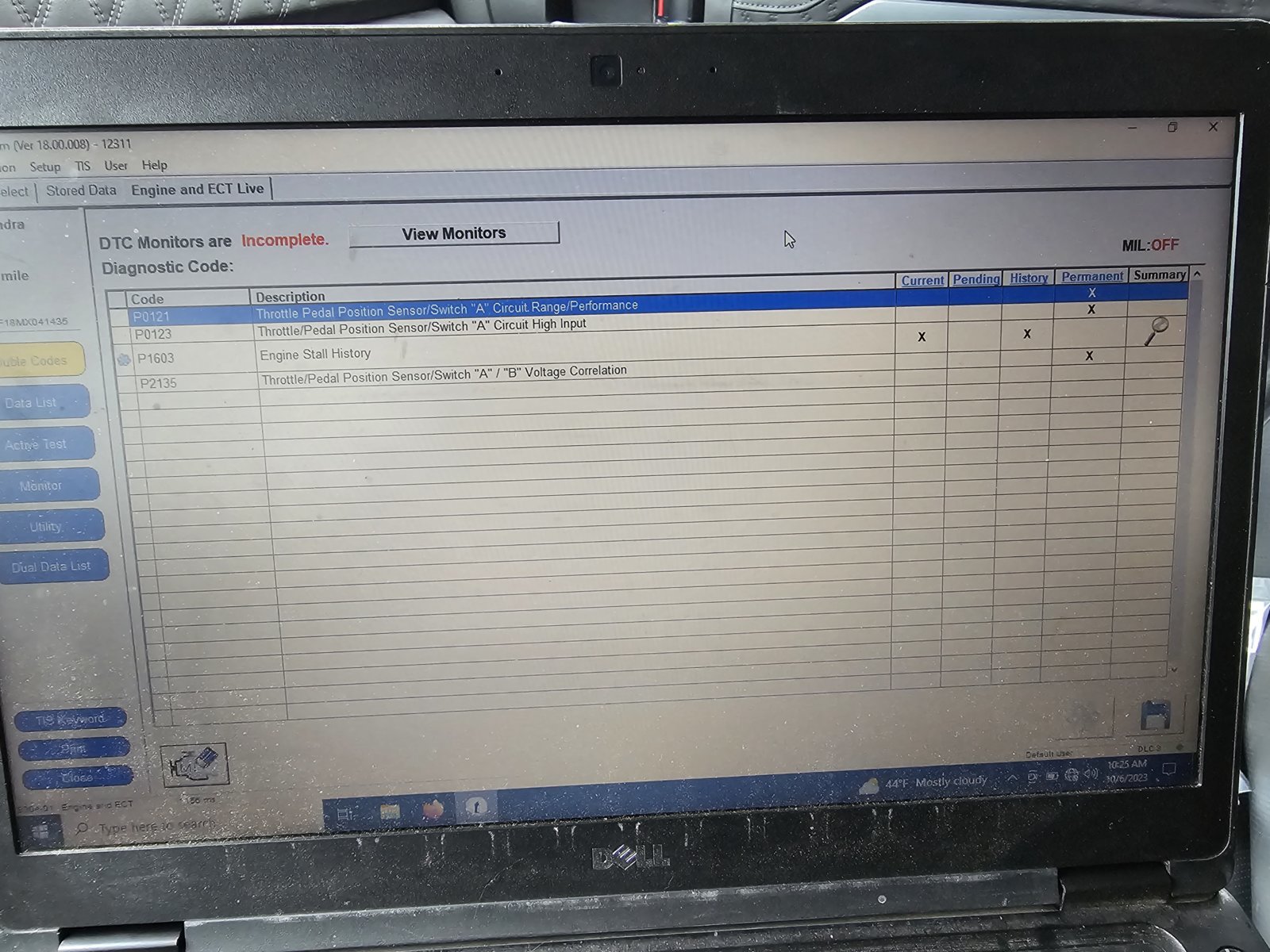

    OK, found extra codes related to the throttle position sensor. But they are permanent and not clearing. Researching now

    ordered a new throttle body since the sensor is riveted onto the body
    got off Amazon for $85. Should be here sunday and replace it monday

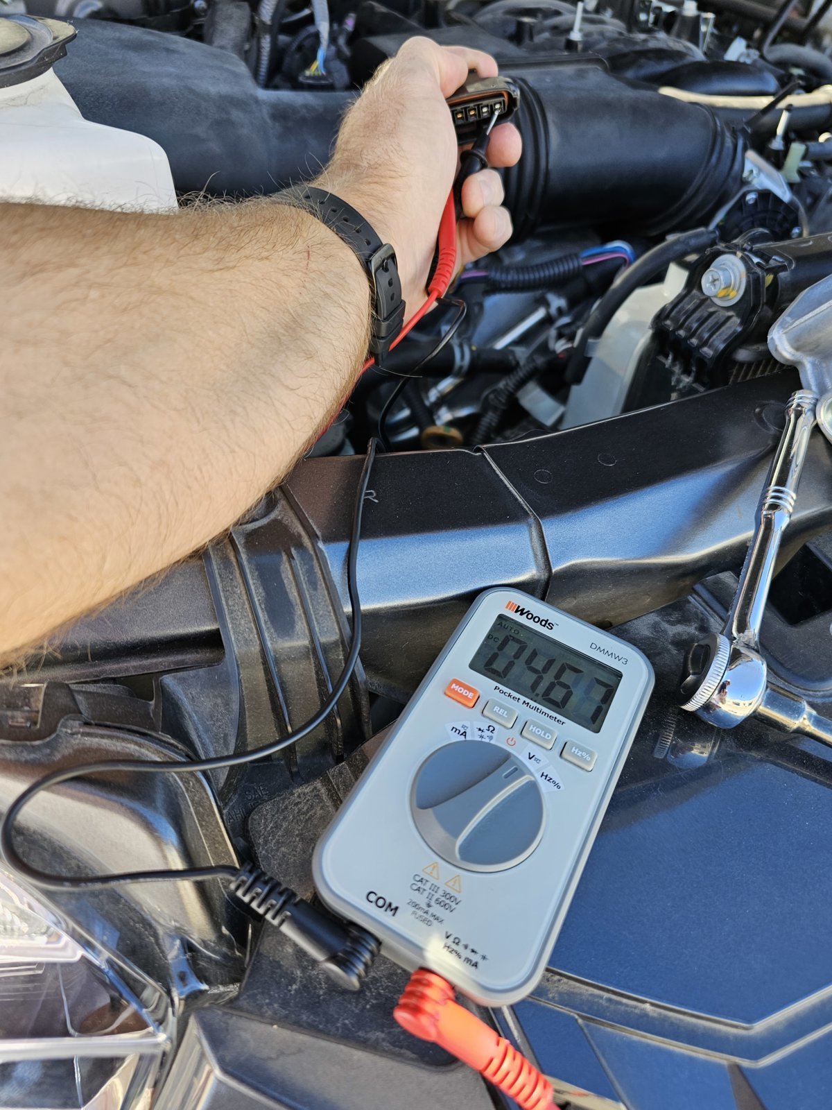

    Swapped TB, same issue. Tested TB connector and its.getting proper voltage.
    Stumped...
