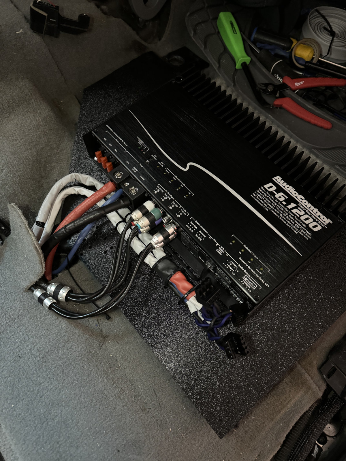

    Well I made the impulse decision to order it off of ABT last night but kept my crutchfield order just incase something went wrong or it was damaged and of course with just my luck crutchfield gets an order in today and charged my card again for the same amplifier :facepalm:
    Always a hurt to look at a bank statement and see a purchase of $2000 in one day
    Guess I have 2 D.6-1200 amps now incase anyone wants to buy one off of me XD

    Congrats on the buy! Coaxials or not, it's gonna sound great! Just finished installing the D-6.1200 last night and man do those GB10 tweeters sing! The GS25s sound great but now I'm super excited to compare them with the GBs since I've heard the upgrade between the GS25s and GB25s is much greater than any of the other speakers. Once I get my refund for the second D-6.1200 I'll probably end up ordering them lol. Never gonna be done with the audio in this thing XD
    Some pics :)
    (can catch a glimpse of that fox acoustics box in the back :))
    I definitely recommend wiring everything to the board before you install it. Makes zip tying and wire management so much easier.
    The tweeters look fantastic! The silver trim matches the interior perfectly!

    Very nice! Cable management and wiring looks on point. Those tweeters do look super nice in the sail panels! I was measuring the JBL sail panels last night again and I think I'm going to end up just using the flat non-JBL ones. My Frak tweeters have a cutout diameter of 2", and the JBL sail panels have a "flat" surface of 2" before the tweeter cup angle starts. They would probably fit I'm mainly just concerned about how well they'd seal around that edge since it's not perfectly flat all the way around. I've already paid for em though so I might just give em a go and see if I can make em work. As for the flat fail panels, I haven't pulled mine off, but judging from the countless installs I've seen with them I'm assuming there are no clearance issues behind the panel? My only concern was if the non-jbl sail panels were flush up against the door metal, but since everyone installs tweeters there, there must be plenty of room.
    I fully agree with wiring everything up on the board before installing. In my last truck I had ordered the F-150 amp rack from Sounds Good Stereo (great shop btw, heard Five Star name drop them so they must be fairly well known in the car audio world). Wired everything up on the board and actually still have everything sitting on it in my basement lol. Makes installing a breeze and or/removing/swapping things in the future.
    Where did you install the D6.1200? In any case, excellent work on a clean install! Glad to hear everything went smoothly with the install and your GB-10's really came alive with the new juice. Have you played with the audiocontrol DSP and tuning yet?

    The D-6.1200 is under the drivers seat and the LC-1.1500 is under the passengers seat.
    After a couple of days of having it installed I have ran into some issues that aren't too bad and are probably easily fixable but I haven't found anyone that's experienced something quite like me.
    Just for context, I have the front rca's and sub rca's from the HU going into the 6 channel so I can dsp the front stage and the subs. Also am using the ACR-3 bass knob that doubles as a preset selector instead of just using an ACR-1 that goes directly into the sub amp. Keep in mind I have a kenwood headunit which is known for being able to play at max volume (40) with no distortion or clipping. When I started to tune my system, I realized for some reason I was getting a clipping input signal into the amp at around 32 volume using a 40hz test tone, but when using a 1khz test tone I could turn it all the way up to 40. I ran through the HU's settings to make sure the subwoofer level was at 0, eq was flat, no bass boost or loudness and the crossovers were all set to full which was all true. I decided to just tune the system with the new max volume being 30 to be safe and get rid of the clipping input signal into the dsp amp.
    On the D.6-1200, there is an MILC light which detects any clipping coming into the amp, then there are 2 lights for each channel that shows if that channel is receiving distortion or if it's sending out a distorted signal. In the software, to set the gain there is a slider for each input channel and the one output channel which I'm using for the sub amp.
    Since I made a mental note that the new max volume was 30, to compensate I set the input signal to +6db (max is +12db) for the front rca's that feed the 3 way. I left the rca output for the sub amp at 0 and instead turned that gain up on the sub amp itself pretty far to compensate. Went along with my tuning using an acoustical RTA and it sounded pretty good for just a simple quick tune that took all but 20ish minutes. I knew it needed more but planned on doing it the following day since it had gotten pretty late and I planned on hanging out with some buddies that night so I wanted to be able to show off the tunes to them. Only complaint with the first tune was the subs could have been louder (considering I'm overpowering my dual 10" alpines by 150 watts each)
    The next day after doing some research on what most people recommend to do when tuning, I realized that everyone recommends to try to keep the INPUT at 0db to minimize sound throughout the car and to set the OUTPUT to the max db before distorting/clipping. I never realized any sound, but I hadn't really been paying attention either.
    So I did exactly that, I turned the gain down on the front RCAs to 0, maxed the sub output with no distortion(which I think was either 6db or 9db on the software), and reset the gain on the sub amp which was barely turned as to be expected. This time I realized that I found myself turning the volume up all the way to 30 with almost every song, and the front stage just wasn't loud enough. Maybe it was just the subs drowning it all out, but either way I should not be complaining about the loudness of a 125 watt per channel amplifier.
    I made a post on an audiocontrol facebook group asking for help (which to be honest wasn't much help at all lol) but decided I need to be able to turn my HU up louder than 30 since that's what kenwood intended everyone do with an aftermarket system.
    That leads us to now where I'm just trying to figure out what is causing the clipping. Every subreddit I've read and every article about my HU all states that there should be no problem with turning up the volume without distortion. I even asked Dean & Fernando on one of their lives about what might have been going on and they had no clue either. They said it could be a HU problem and that they would dyno my same HU whenever they got another one to install, but I'm really hoping they're wrong because it was a $700 HU that I got last november :( God forbid it is, I'm hoping Crutchfield will warranty it but again maybe it's something more simple than that.
    I'm to the point now where I'm thinking maybe it's the DSP amp causing the issues, so maybe I'll just go straight from the HU to the sub amp and see if that fixes the clipping. I've tried moving the sub RCAs around on the amp from channels 3/4 to 5/6 and it didn't change anything. Also tried messing with the crossovers on the HU. Instead of setting the front and sub to full, I set the front HP to 80 and the sub LP to 80 and all it solved was the clip light wouldn't come on for the front rcas using a 40hz test tone (since the HU HP filter wouldn't send that low of a signal)
    I'm to the point now where I really am contemplating on returning the D-6.1200 and getting an Audison, Helix, or maybe even ARC audio amp. If it's the HU then it won't really solve my problems but I also know that 100% without a doubt I won't have any issues with them in the future. Also, they allow more tunability and are just all around better (or so I'm told)
    I've got 60 days to decide on if I want to return, so I'm gonna keep messing with it to see if I can't figure something out. I already modified the inside to fit the ACR-3 into the factory ash tray which looks and works fantastic, but I'd be fine with buying a replacement if it means I get to solve all of this nonsense.
    If you have any idea on what might be going on with this I'd greatly appreicate it, because as of right now I am stumped!

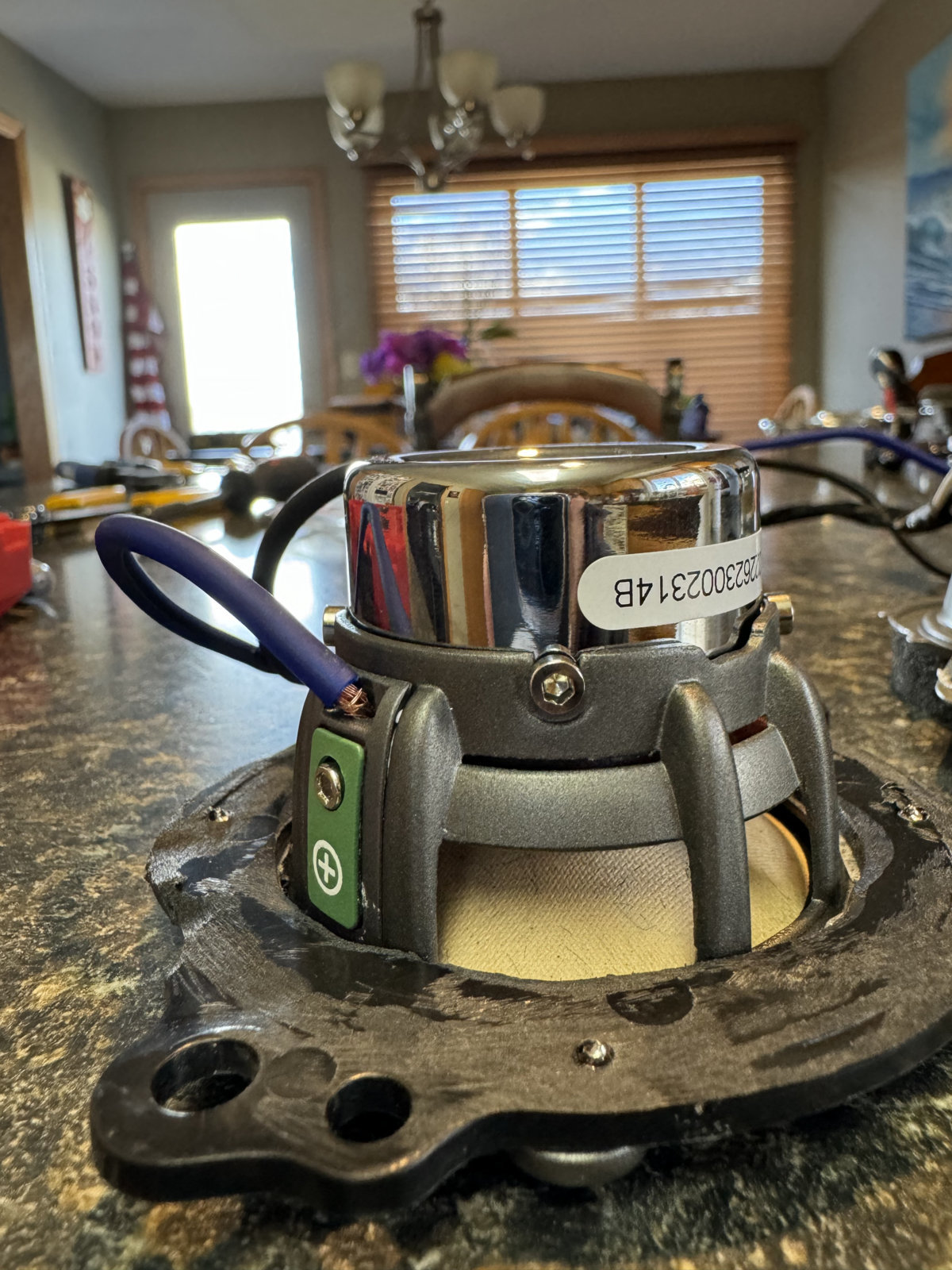

    Been busy lately, but I had some time to attempt fitting one of the Frak tweeters into a JBL-sail panel. Focal really dropped the ball on mounting options for these tweeters imo. The two options from the factory are to use the included plastic pods, or to use the friction ring they include, which I'm not particularly fond of as they only work by gouging into the frame of the tweeter. I used a pair of flush cutters to remove the JBL sail grill, and then slowly dremeled out the hole wider. Took my time and continuously test fit as I was going. I was able to eventually get the hole to the required 2" diameter and press fit the tweeter into place. Due to the design of the back side of the panel, it's not possible to use the included mounting ring. I was able to save all 3 mounting screw holes, but due to the depth of the tweeter the bracket sits fairly far out from the holes. This doesn't really matter though because it's physically impossible for the tweeter to fall back into the sail panel due to the irremovable surround on the tweeter. There is however the very real possibility that the tweeter could fall out forwards/into the cabin. While I've got them fit super snuggly, and I've given them some good shakes, I'm still worried they won't be secure enough on bumpy roads etc. and might pop out. At this point I'm debating a few options and would love anyone's input.
    Option 1) Use CA glue or hot glue to "permanently" affix the tweeter to the sail panel from the back side.
    Option 2) Trim the sail panel bracket to obtain appropriate depth around the tweeter and be able to utilize the factory mounting locations, along with possibly wrapping the back sides of the tweeter, and inside of the factory mount with velcro so that the tweeter is velcroed to the bracket, and the bracket is screwed onto the sail panel.
    Option 3) Ditch the JBL sail panel idea, cut 2" holes in my flat non-jbl sails, and use the Focal friction ring to secure them.
    I think I'm leaning more towards one of the first two options as the focal friction rings are flimsy and honestly kind of a joke for how expensive the tweeters are. Hot glue would probably be strong enough to stop them from popping out (I just gave them some really hard shakes and they didn't pop out). CA glue would probably be the most secure but also slightly overkill. Factory mount + velcro could probably work but might not depending on how everythign would fit together. I'm going to trim the factory mounts down and see what I can get out of them. Pics below for reference.

    I trimmed down the mounting brackets and realized there's just no way they'll be usable. I'm debating getting some flexible plastic to cut a triangle out of, cut a hole in the center, and then create a donut of velcro on both the plastic triangle and the back of the tweeter to suction the two together, and then screw the plastic triangle into the factory mounts. I'll play around with options. I'd like to avoid glue for messiness although I know hot glue is relatively easy to remove. Can't really see it in these pictures and I forgot to mention it originally, if I decide to stick with these, I'll be re-shaping the cup portion of the panel with body filler etc. so that there's not an overhang around the tweeter surround. At this rate it would be a lot easier, and I doubt I would notice an audible difference between these panels and the flat panels. I like that the JBL panels angle the tweeter and I'm guessing the audio engineers at Toyota designed them with said angle on purpose. Since the tweeters have a cut out of 2" and I have a 2" hole saw, I will probably just end up going that route to save time and headache.

    So I figured out the problem and after finding it out it seems pretty obvious lol. Since I'm using such a "high quality" head unit it has 5v preouts for the RCAs going to the aftermarket amps. The audio control amps, dsp or not, are rated for 6 volt RCA inputs. I knew this and thought to myself "5 is less than 6 so it must work" not taking into account that I'm going into the dsp FIRST then going to the sub amp. Somehow even at a 0db input gain on the dsp amplifier, the signal had to have been boosted higher than 6 volts at 32+ volume thus creating a clipped signal which the sub amp obviously didn't like. I'm glad I didn't ignore it cause I most definitely would have fried my sub amp if I would have continued to play it like that.
    I had the same problem with my D-4.800, but I knew I wasn't going to be keeping that amp and instead would be upgrading to the 6 channel so I just never took the tuning seriously and only played to about 28 volume on the HU, which didn't clip.
    To fix the issue, on the output channel of the dsp amp I turned the input gain to -5db. Although the gain on the sub amp itself is turned up pretty high there is no noise so I can't really complain.
    Now I can turn the volume up all the way with no issues, but I try to keep it under 36 just because I really don't want to have to buy new subs since I'm pushing 150 watts more to each of them than they are rated for lol. I am using a barely large enough box for these subs so technically I can push some more power, but I'd rather not risk anything. These subs BANG just the way they are and I'm extremely happy with them. Can't ask for much more with the space I've got to work with.

    I'd probably get hate for the way I installed mine but I don't really care because it works for me.
    I too used a Dremel to fit my audiofrog tweeters in the sail panels. I DIDN'T use anything to hold them on the panel from the back because they were super tight to get on since I was very conservative with how much plastic I cut out. I HIGHLY doubt my tweeters would ever fall out because they were quite a pain to just get into the holes. Plus, on the outside of the tweeters there are two stickers stating where they were made and the individual serial numbers for if I ever needed warranty work. They act as a little barrier that helps hold the tweeter into place
    Yes it's lazy, but it works. My tweeters were the exact same way as in they were deeper than the factory tweeter mounts on the panels. Eventually, I might just take some 1/8" or 1/4" plastic and use a torch to bend a little mount to create a kind of dish to screw the tweeter in if that makes any sense. I don't see any problems arising anytime soon though so knowing me I probably wont XD
    If you cut your holes to big, you could wrap some tape around the outside of the tweeter to give it more grip on the panel. Kind of cringey and yes it's lazy, but it could work enough just for you to dry fit the panel to see if you like the way the jbl panels look. If not, could restart and make a more custom option.
    I also wouldn't be against using some CA glue or hot glue. Just make sure it's what you want before incase you change your mind then you have to go through the trouble of removing it.
    Based off of your pictures, your tweeters look pretty similar to mine in terms of how they hang over the lip. I too thought they didn't look very good with the overhang until I installed them into my truck. I can hardly notice the lip when they are sitting vertical on the door since they are pointing directly at me.
    I'd recommend you dry fit them in the truck with the jbl panel and tweeter just to see how they look. Who knows, maybe you'll dig it :)
