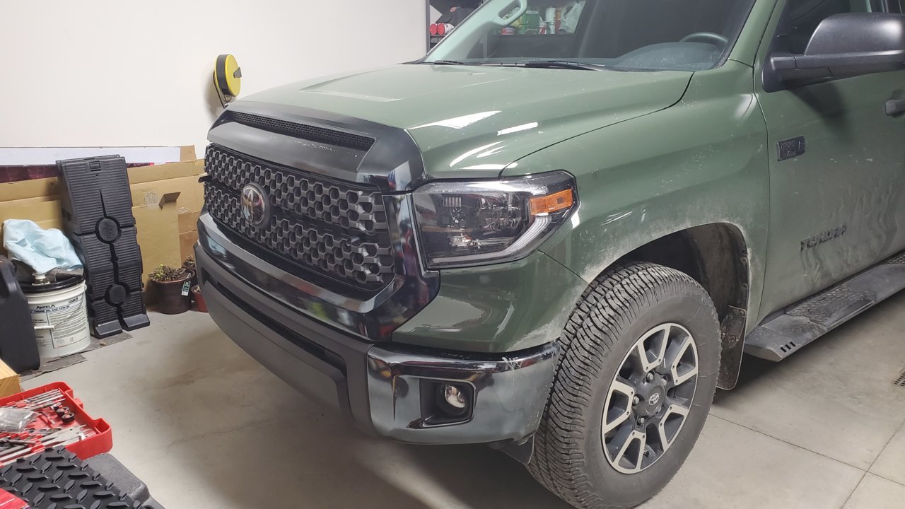

    Hello all, new to the Forum.
    Purchase my first Tundra back in September a 2021 TRD off road Crewmax in Army Green.
    Absolutely love the truck!
    Well everything but the Chrome grill and front bumper ends.
    I found a Product that Dupli-color makes called Shadow chrome. With a lot of prep work I ended up spraying the hood bulge, the grille surround and the bumper ends. Here are the results. I hate it and love it. I did three lite coats of the shadow chrome and three coats of clear. In bright light I love it because it looks like black crome, but in low light it picks up the green paint color and looks blotchy.
    Time to order a color matched sport grill and bulge
    Does anyone have pictures of the army green sport honeycomb grille?20201216_160252.jpg 20201214_173810.jpg

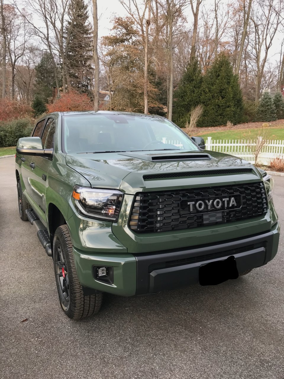

    Not sure it helps, but here is my 2020 TRD Pro in Army green.

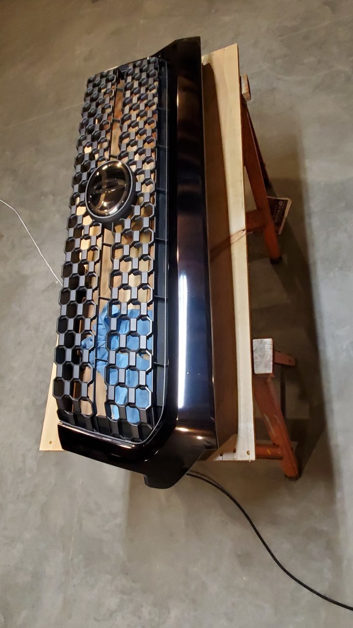

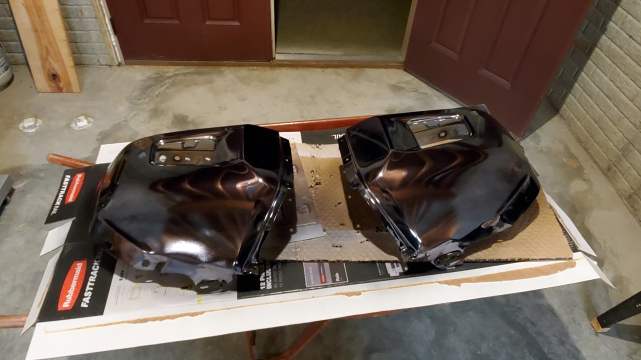

    Here are a few more picture. It's hard to capture in pictures but off the truck it looks black, on the truck it picks up the AG paint and looks a blotchy green. But it all depends on the light. It bright sun it looks great . Haven't had many sunny days lately.
    The hood bulge and grille surround I used the recommended prep per the instructions but from recommendations from two professional painters, I used Dupli-color adhesion promoter. I then sprayed three as even as I could coats of the shadow chrome per the instructions on the can. Then 6 hours later I applied three coats of the clear per the instructions on the can .
    I did the same to the bumper ends except I didn't use the adhesion promoter.
    FYI. Its already chipping off on the insides of the wheel wells from stone chips.
    On your MGM color truck I think it would look great because if it reflect the color of the truck it should just add to the shadow.?
    Hope this helps
