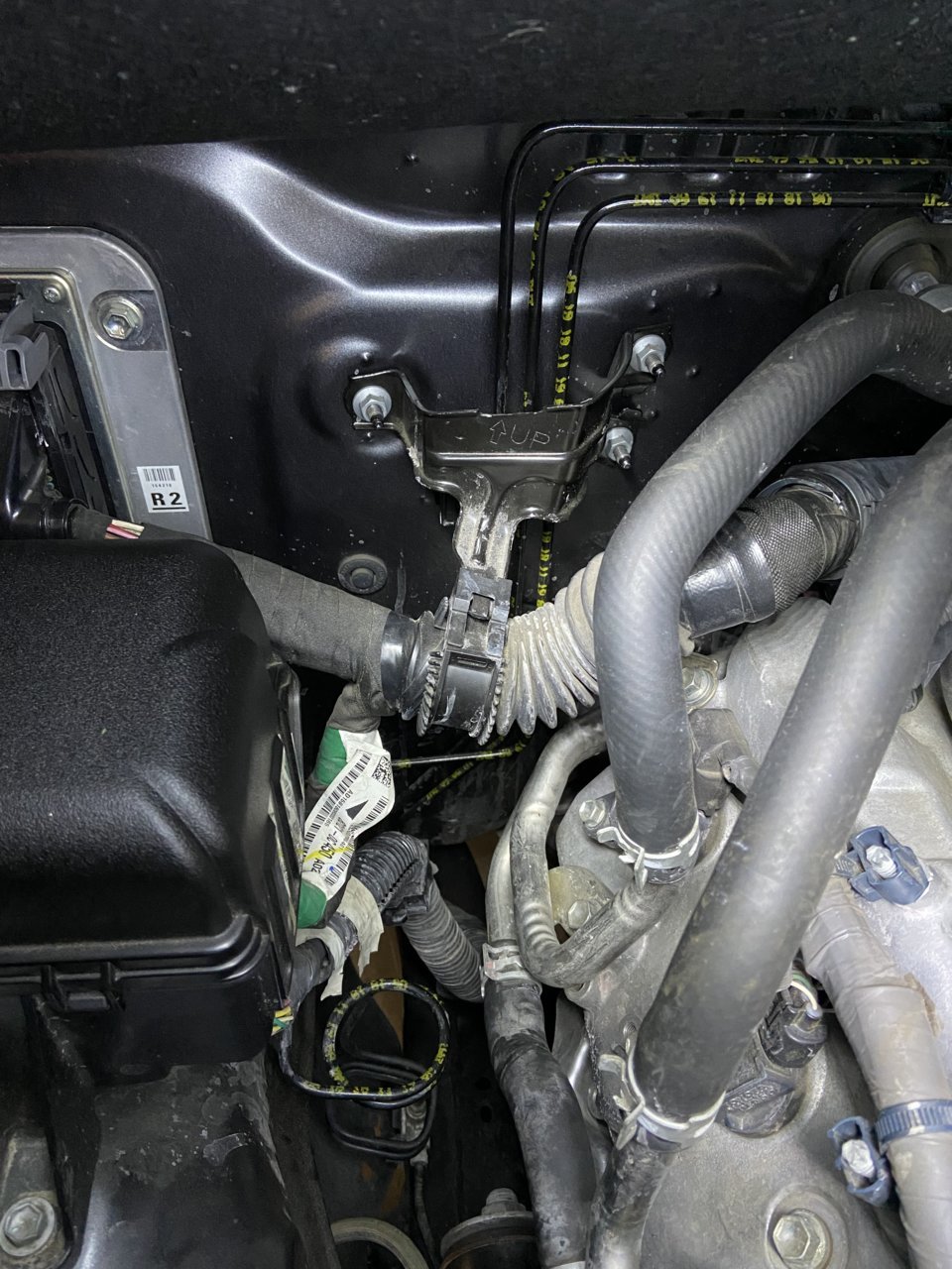

    Yep I had that issue took the dealership 3 days to tell me it was the brake lines they ordered a clip put it on and apparently put the wrong clip back in because the stupid thing was still making the rattling noise over ruff roads etc so I took 15mins of my time and found out it was a brake line touching a hard radiator hose lol ‍♂️ I took and zip tied it back into place, no more noise. Also to the OP I have the same issue I wouldn't describe it as a ping but a crackling kinda like what u said water hitting hot grease but a ping will confuse most people, what I believe is happening is it's a fuel to air ratio problem too much gas is flowing in such a low rpm and when u accelerate through that rpm drop the gas does not all get burned and it reaches the exhaust which makes that noise ‍♂️ crazy how it mainly happens from the shift between 45mph and 50 and mostly if u let off and then accelerate through it. This truck is a POS I paid 50k for America garbage tbh they were good when the japs made them but since moving to America, it's planned obsolescence.. now I have another issue when my a/c dampener switchs from outside air to inside air the dang thing sounds like a loud fart! Beautiful truck but I'm about to trade up soon ‍♂️ the dang thing leaked from the sharkfin the first night I brought it home, soaked my entire headliner

    It's your firewall brake line touching a hard radiator hose go to the hydraulic lines on passenger side under the hood, one of them will be touching a hard radiator hose, I swear to you this is the problem and I fixed it you will need a step stool to be able to see back there trust me, zip tie it to the spiral looking line to keep it from sliding back and fourth in the clip and fixed, I guess I'm smarter than the local Toyotas master tech

    So what do I need to zip tie to where? I've got an annoying buzzing type sounds coming from around this area I believe that I generally notice under light throttle.

    I dont hear buzzing over my dirty sevens and clanking bypasses lol. Def recommend higher grade fuel if you're truly getting pinging
