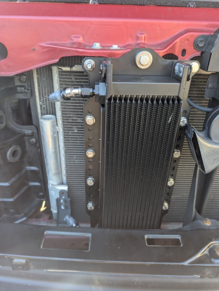

    PXL_20250112_210124555.jpg Got started on my AT cooler install . I realized after the pic that I had the spacer installed wrong but it's correct now :)
