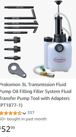

    use this.
    thank me later.

    Hmmmm, I'll look in to it. Are those outlet elbows that can hook in the fill plug? That's almost exciting. Yah, I live a sad existence
    Does it have volume graduations on the side?

    yes...it hooks right on the filler hole.
    yes, it has measurements....but, fill it with about a quart more than came out....and check valve it down to correct level.

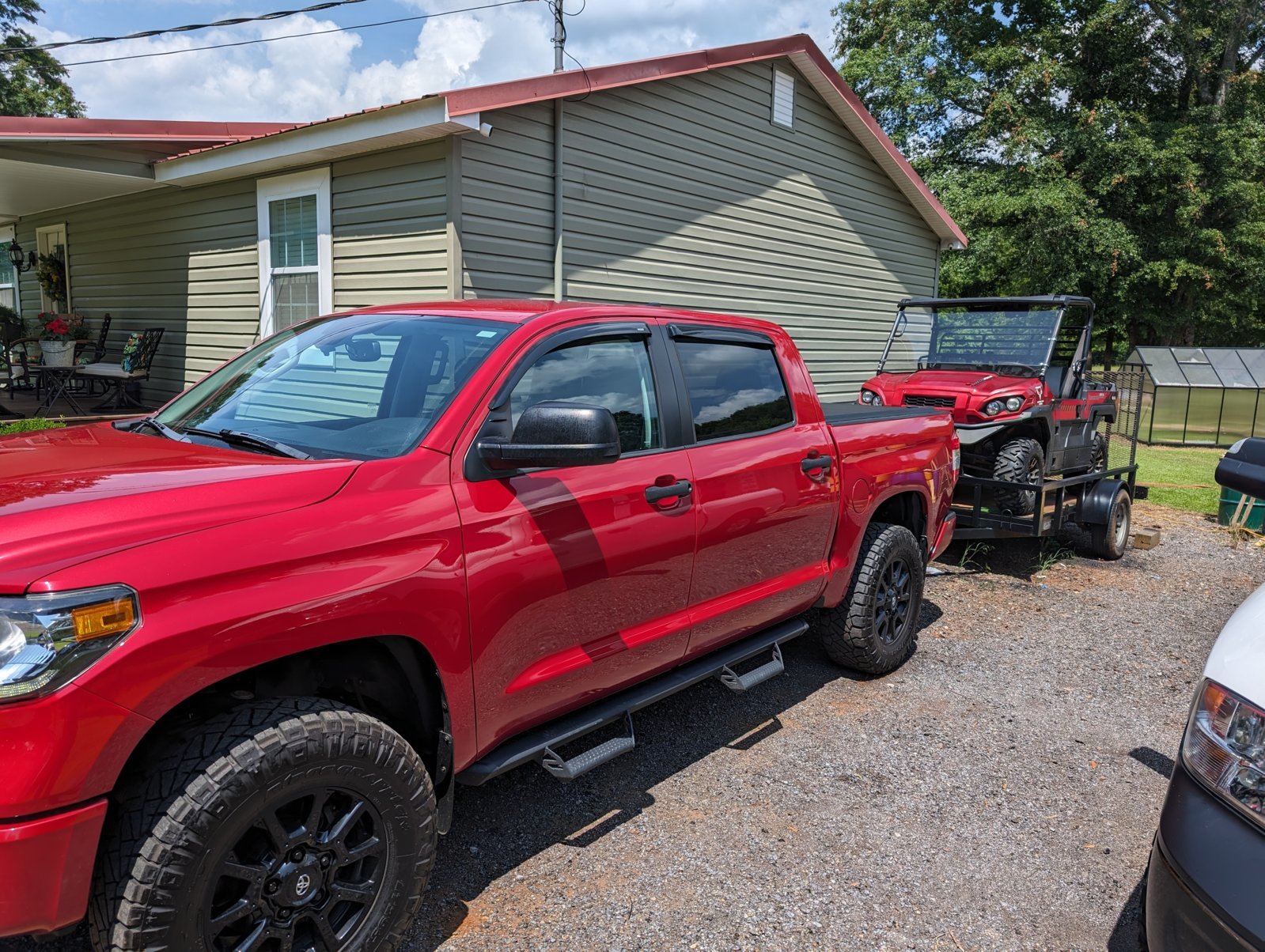

    I just recently joined the group and after finding this thread learned that my 2020 has no AT cooler so looks like I have some work to do.Plus my Tundra has 102k and I'm sure the trans fluid has never been changed.I purchased the truck in May with 101k and I will be hauling a tractor or side x side so it's a full service and cooler add for me.
