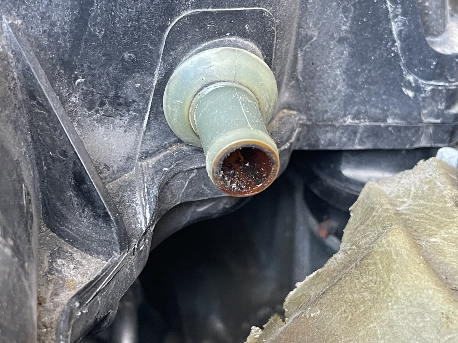

    I just took the hose that connects to the pcv valve and it is oily in there. Is that normal?

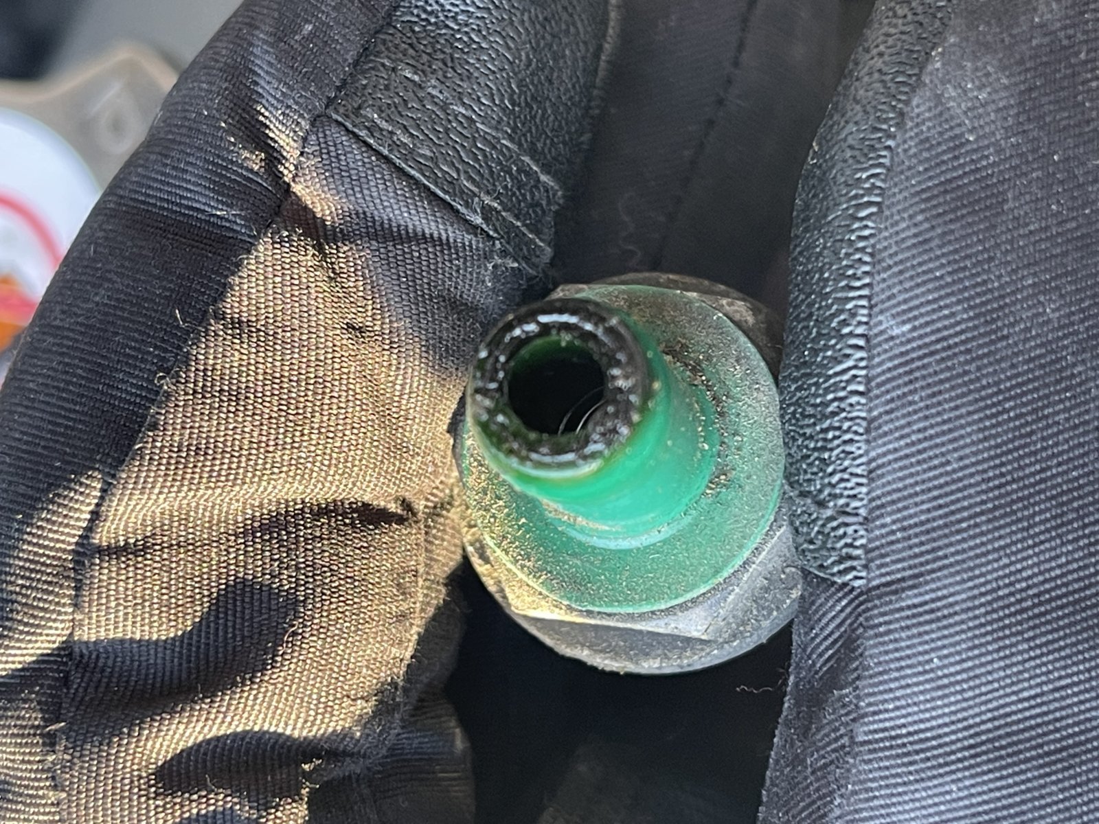

  15. Jan 16, 2024 at 11:27 AM
    #45
    parkerbows
    parkerbows New Member
    Apr 7, 2019
    #28783
    730
    Jack
    2017 crew max sr5 trd off road
    Firestone air ride air bags
    When you shake it does it make a rattle? if not it is stuck. Possibly could still be too little pressure but doubtful
