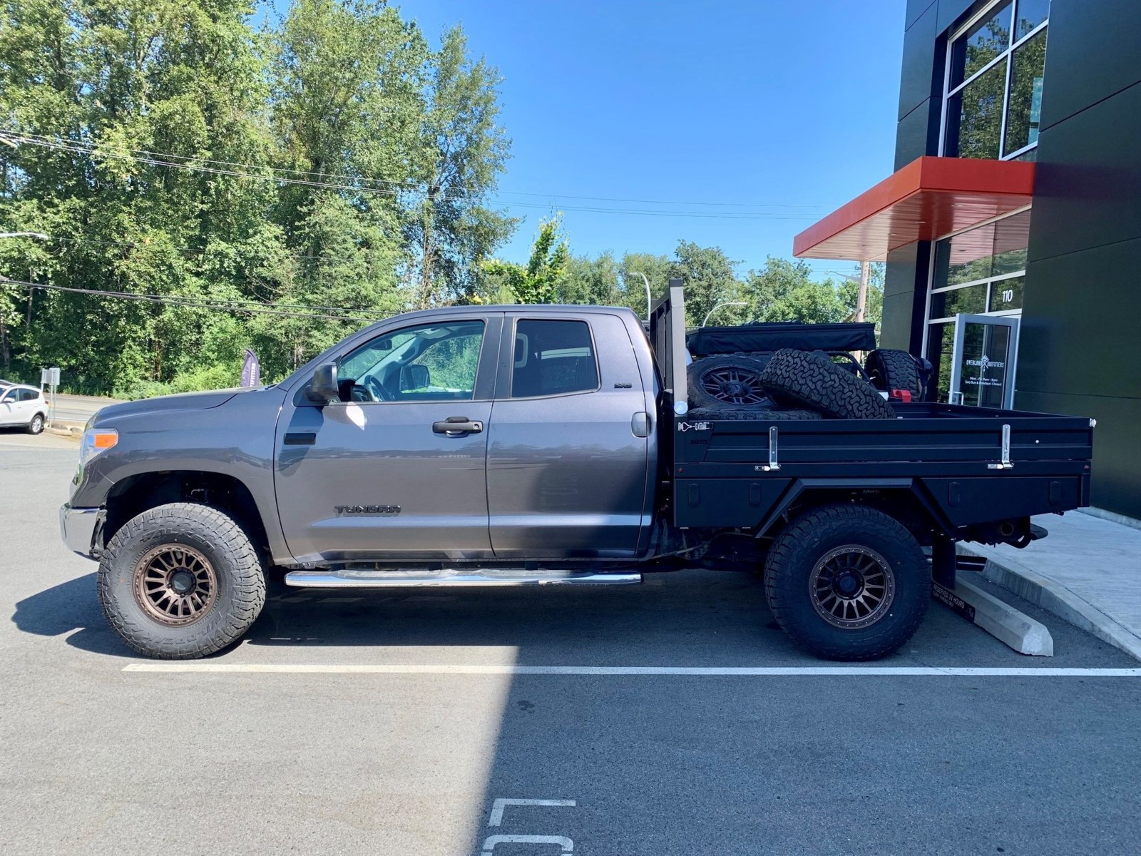

    I went with the Elka Stage 2.5 shock kit. It gave me 2.5" up front and 3" in the back.
    Up front I went with the ICON UCAs. In the Back we installed the ICON multi rate leaf kit.
    Overall price was about $5500 for parts.
    I will say that I have put it through the test on the logging roads over the past few weeks and I cant believe how smooth and well handling it is. By far best truck I have owned.

    That looks awesome!

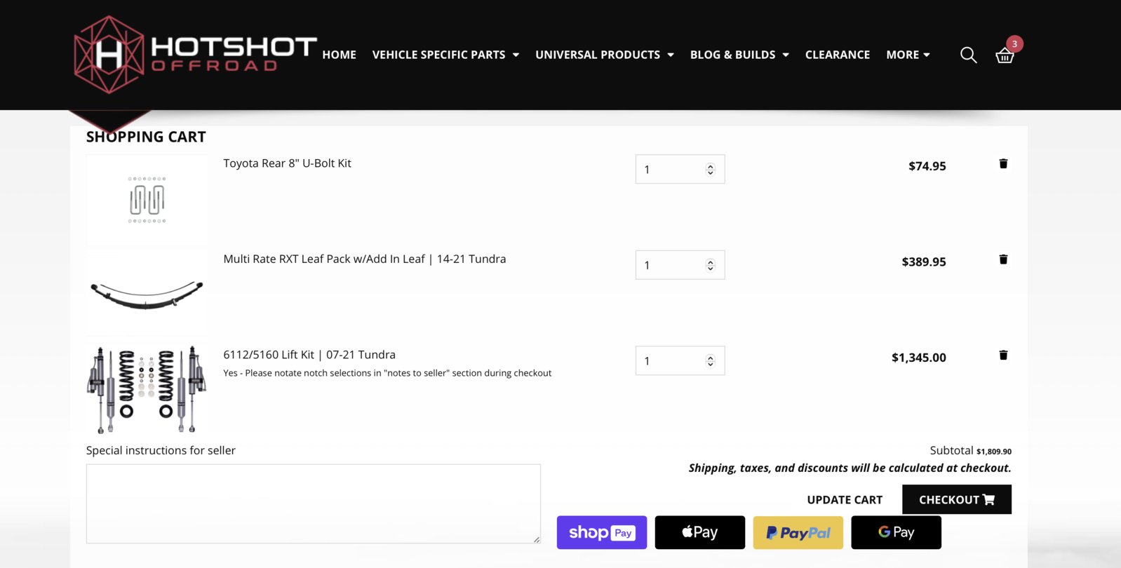

    OK, this is what I have in my cart at the moment....do I need new bump stops? Also I realized I should say that I have Method Racing 701 that came with a +25 offset I think and I'm running 275/70/R18 tires which are oversized. Am I going to run into any issues with that setup?

    You’re darn close! You’ll need qty 2 of the leaf packs, but other than that they all play nice.
    New Bumpstops are not required. However, they are nice if you decide to run the truck a little harder. They’ll help make the hard run-ups a little less harsh!
    No wheel/tire setup concerns!
