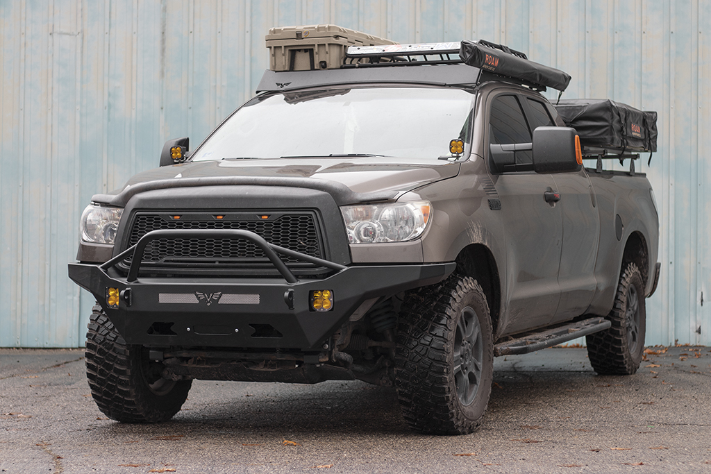

    or this guy + Morimoto/Alphraex style headlights..and the TRD PRO sequoia grille...yummy !
    https://www.victory4x4.com/product/VTU2FS-T.html
