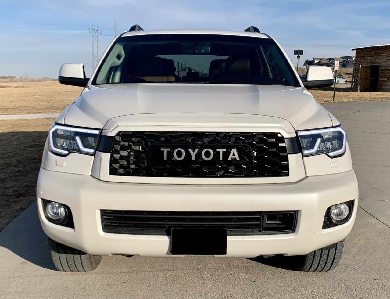

    2015/2022 Sequoia Platinum/TRD Pro
    2022 TRD Pro Grill Form Lighting LED Headlights Door Handles/Mirror Covers *All painted Blizzard Pearl to match Viper Smart Start
    2211230F-EE3E-4966-93EE-8881B1DDD028.jpg 9C61E1BA-78D4-4D8F-B392-87EA6D0E02D2.jpg 914FFADD-6515-415C-97C9-17D307854BD9.jpg B51B1A03-8C07-43B8-AC00-82391009DE6E.jpg
    I just finished my update and have GOOD NEWS…one, it’s pretty straightforward and looks AWESOME…two, the TRD Pro Grill IS AVAILABLE from Olathe (Kansas) Toyota. They told me that they will “make it happen”!
    As for mine, here’s what I did (note that there are additional numbers/letters that would be added to the grill part numbers for paint color if applicable):
    1. TRD Pro Grill (2022) PT363-0C200
    2. Grille Molding (for top) 53111-0C240
    3. Fender extensions (below headlights) 53932-0C904 and 53931-0C904
    4. Form Lighting LED headlights
    5. Body color door handles and mirror covers (chrome delete)
    And some notes/tips:
    1. I had mine all painted professionally (thankfully have a friend) in Blizzard Pearl to match (grill molding already was available in Blizzard Pearl)
    2. Form Lighting lights are pricey ($950) BUT they are self contained, meaning they have all the LED lights/bulbs in them and adaptors so they are plug and play (many you have to get adaptor plugs AND you have to put in your own bulbs). They also look OEM and have a cool feature where signal light does the “chase” as it’s going off.
    3. I ended up buying two sets of the fender extensions (below headlights). One set I cut holes in for adding the headlight washers that were on existing. I then found a downloadable 3D print file that I got a local person to print the mounting “adaptor” needed. I ended up installing with the headlight washers but the cool thing is I could just swap out and put the other fender extensions on if I wanted (and the headlight washer would just be there behind once you remove the little cover). Of course you’d want to make sure to disable them or not push the button!
    As for how “difficult” all this was…I’m simply a guy that likes to work on my own stuff. With help from forums like this, YouTube, Google, etc. I really think anyone can do about anything you need on your trucks if you give it a shot. Form Lighting shows how to do headlights, then Google for things like grill, door handles, mirror covers…really not too bad. Adding/modifying for headlight washers was most difficult part and I probably wouldn’t do it again, but it’s kinda cool to have a unique/rare “TRD Pro Platinum”.
    Hope this helps anyone interested in doing it!

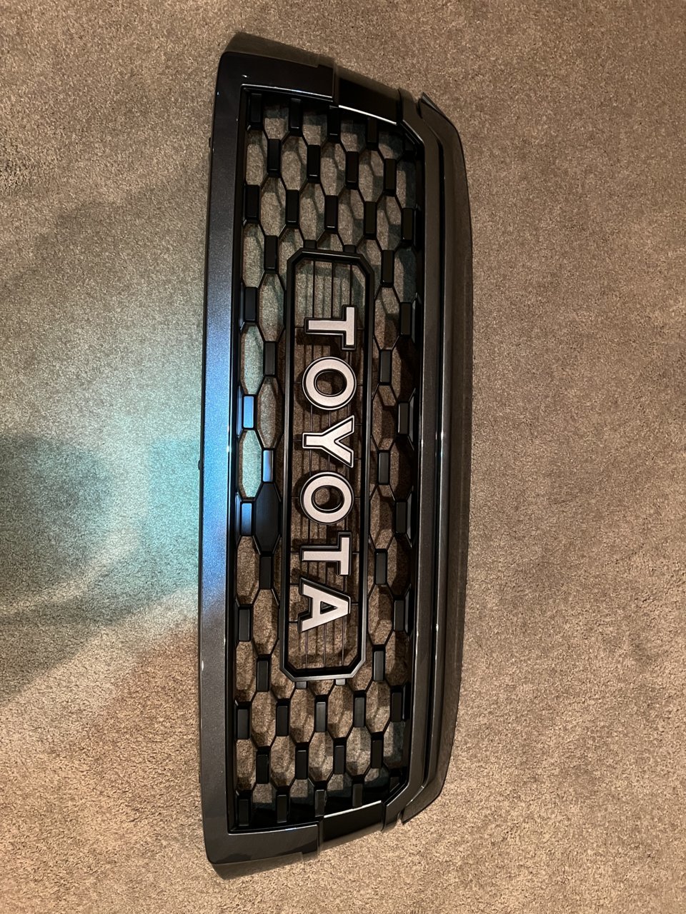

  5. Feb 20, 2023 at 7:11 PM
    #665
    bmtrujillo98
    bmtrujillo98 New Member
    Jul 16, 2018
    #17099
    87
    Here’s the MGM grill I’m getting rid of.
    Jorgesworld86 and PhotoNerd like this.

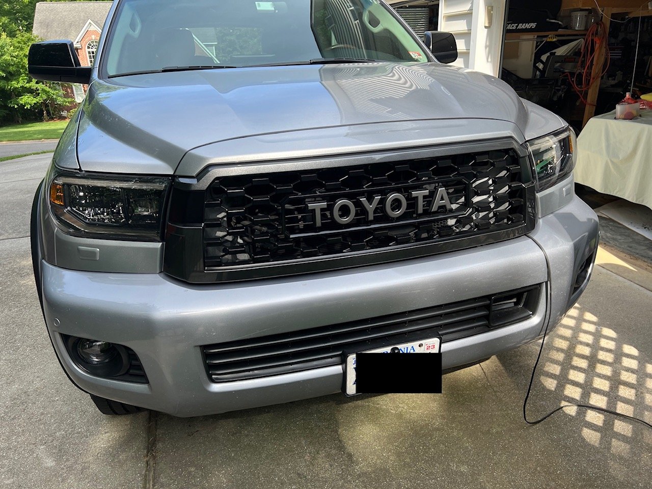

  17. Jul 31, 2023 at 11:27 AM
    #677
    weihenstephaner
    weihenstephaner Over Here
    Nov 25, 2018
    #22197
    25
    Sandy Springs, GA
    2010 TRD Offroad Crewmax
