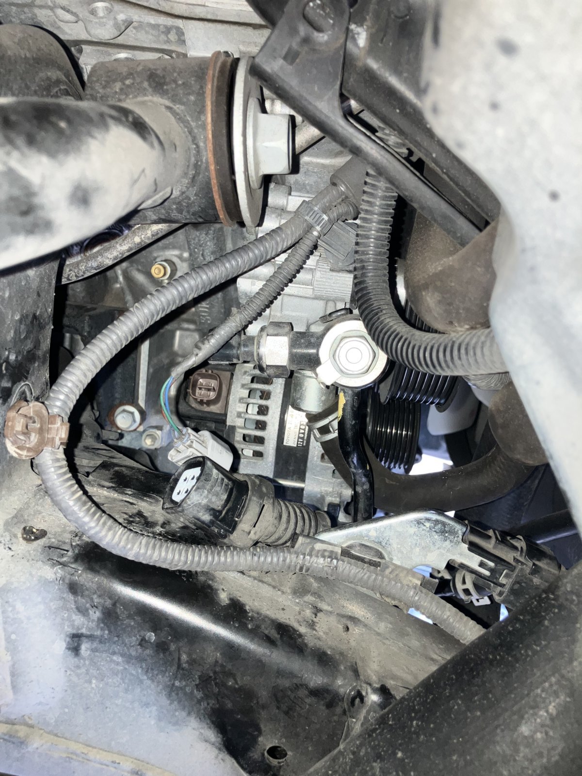

    Well, my alternator bearing is going bad. Can’t believe I have to replace it, 62K on the clock. Pretty disappointing, my truck was either made Monday at 7:00AM or on a Friday at 4:59PM.

    My truck still runs fine for the most part, it’s noisy as heck with the bearing going out and I need to replace this ASAP. Most of my issues are still relatively minor.
    Bothersome how many there are at this point; it’s approaching my F-150 on repairs.

    To the engineer who put the power steering pump over the alternator.
    may you step on a 1000 legos tonight
    That is all.

    Well I fixed everything this afternoon. Was surprised at how much quieter it is now that the alternator is fixed. Guess it’s been bad for a while.
