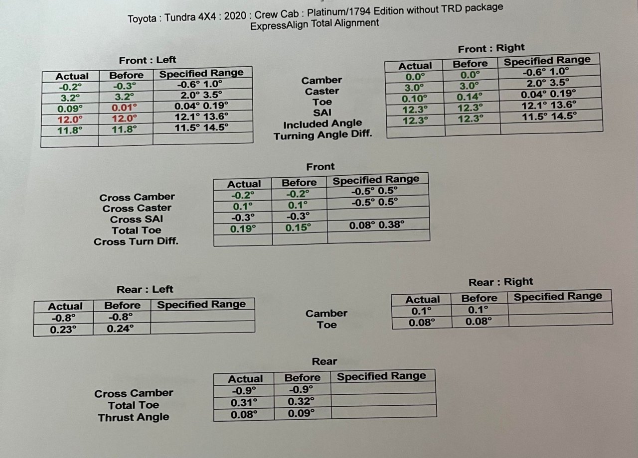

    Hi everyone! After swapping out my winter set to my summers...I noticed that the truck was pulling left slightly. I went in to get an alignment (Tires Plus) 2 times and it still pulls left (front desk said it may be crown of the road...but i doubt it). I did some googling and some people mentioned to swap the front tires with each other...unfortunately, it still pulls left. Curious if ya'll may have any ideas as to what may be wrong. Planning to check tie rods tomorrow and possibly balance tires (could be the problem) as they were from the previous owner and may not be balanced.

    If it was fine before the tire swap, and with only changing that, it suddenly has an issue, I'd say you have isolated the problem?

    After the tire swap, I did do all pads/rotor swap and I just wasn’t sure if I did something wrong or not. I’m assuming it’s the tires and balancing them will solve the problem as the tread on them are somewhat still good but uneven in some areas.

    ditto.
    2020 1794
    77k
    mine pulled to right. 3 firestone laser alignments....perfect. still pulled.
    rotated tires front to back.
    bam.
