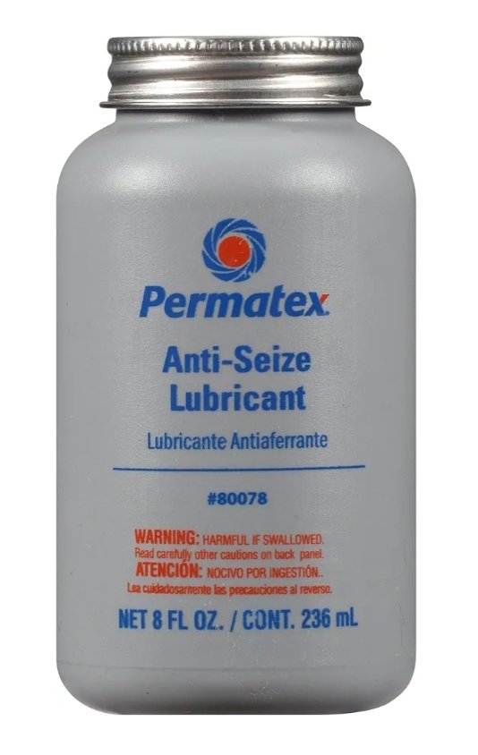

    Welcome from NY.
    You can brush some of this of the back of the rim that makes contact with the hub.

    Thanks ! I’ll give it a try on next rotation.
