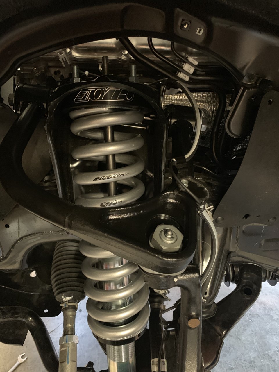

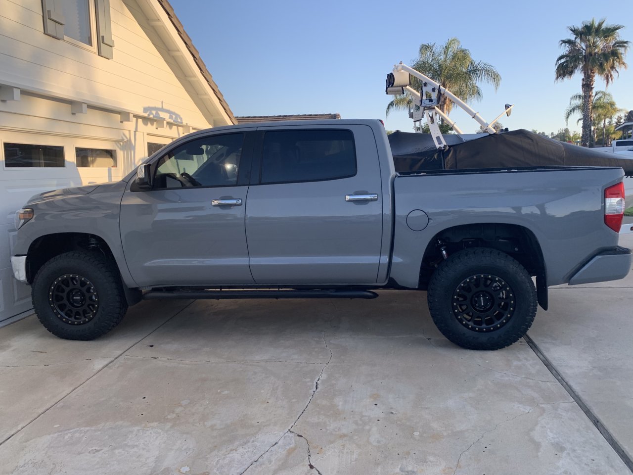

    Installed my @Toytec Lifts BOSS kit and SPC UCA’s today. Turned out great!!! The back is lower in the picture do to the stock tires and stock suspension already loaded in the bed. Also got about 3 3/4 inches in the front. Coilovers were installed at preset settings.
  5. May 25, 2019 at 9:22 AM
    #35
    Amnesiac
    Amnesiac When I am king, you will be first against the wall
    Apr 26, 2019
    #29671
    223
    PDX
    2019 Superwhite TRD Sport
    Looks great!

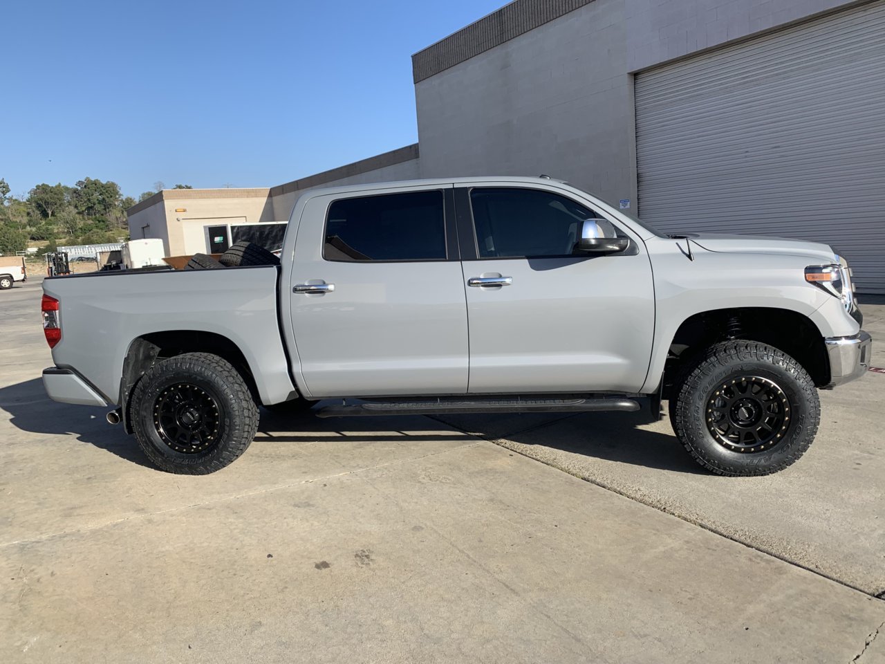

    Unloaded and back at home!!!!

    Wow! I wouldn't expect it to be that low. About how many pounds is in the bed with the stock wheels?

    @Navy Jumper there was about 350 plus pounds in the bed plus the driveway was at an angle. Unloaded it sets 1 1/4 inches higher in the rear. I tow a 5000 pound boat and did not want to be swatting in the rear too much. Also wanted to keep a little rake for the cruise control radar and collision sensors.

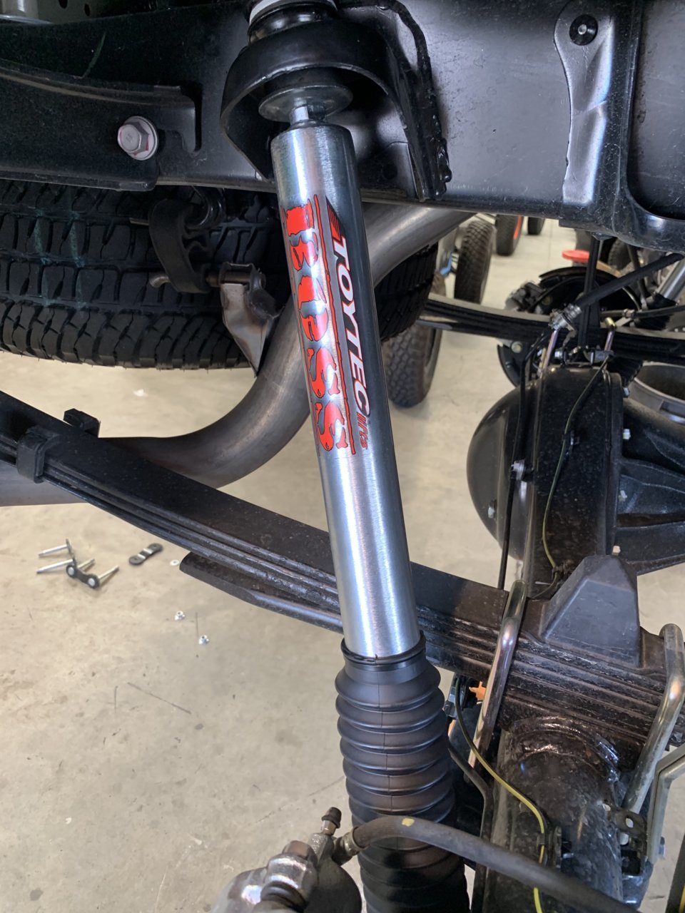

    Wheelers Super Bumps installed!!!!

    If your getting 1 1/4” rake, that means your 1.5” shackles gave you 2.5” lift right?
    Just for example. Say your stocks measurements are 22” front and 24” rear.
    After lift front is 3 3/4 so puts you at 25 3/4”. So you added a 1.5” shackle for a total of 25.5”. Unless your rear had 3” of rake in the beginning

    @Fish2eat88 I believe I had a little under 3 inches on rake to start. If I would have put the shackles at the middle setting or 1 inch setting I would probably be around even or still about 1/4 inch higher in the rear. The suspension is still settling a little bit not bad at all. Anyone who is looking at the Toytec BOSS lift kit you will get what they say if not a little more!!

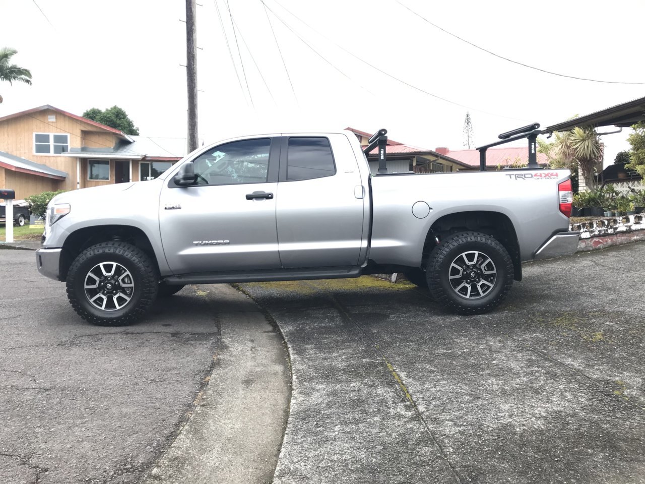

    414C99B0-BADE-4E37-B9BC-B503AE7F8424.jpg Looks great no matter!! Mainthing your happy. I had to do some adjustments to get 3” out of what I have now. Slightly stiffer but cleared the tires just find. 285/75 fills in the gaps just right

    @Fish2eat88 your truck looks good. I was on the fence between the 295/70/18 or the 285/75/18. I think both look good!!

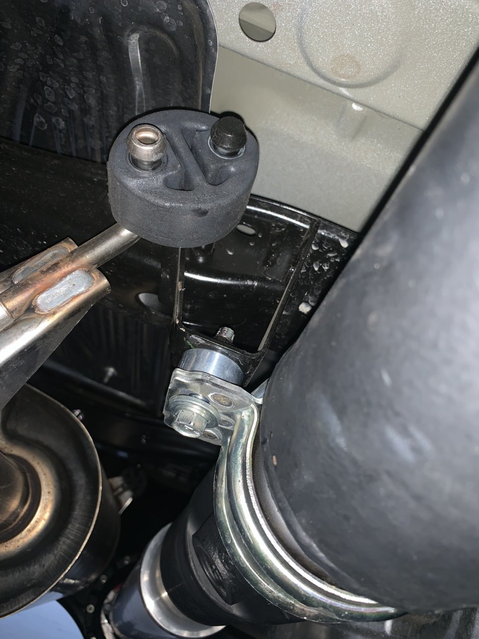

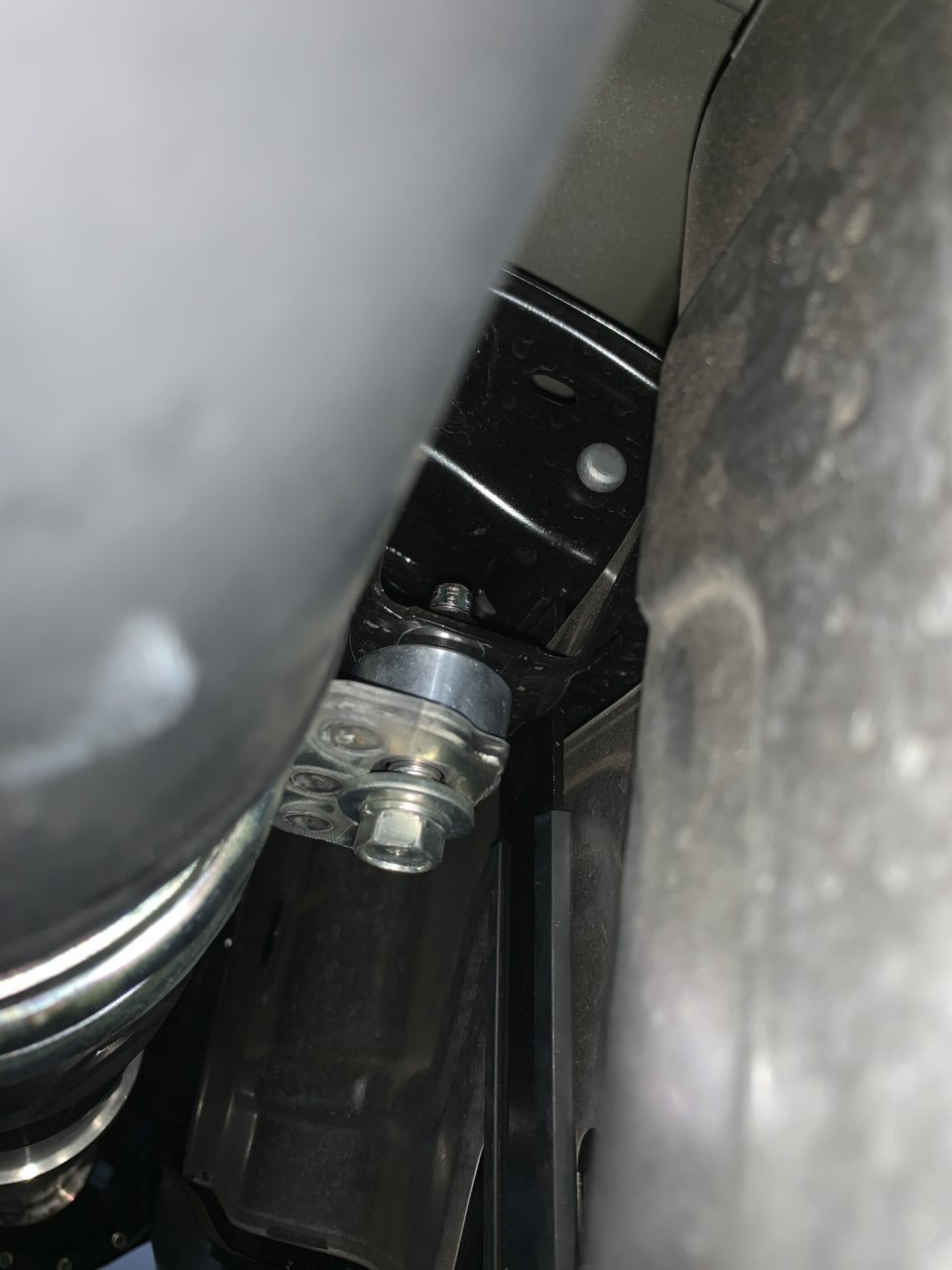

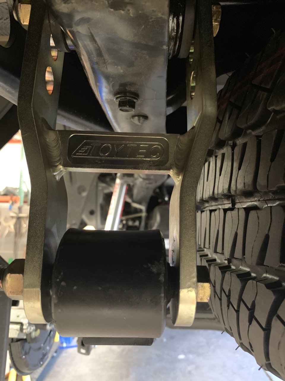

    Had a little vibration from a dead stop. @Coachbuilder1 carrier bearing drop kit fixed that right up. 15 minute install with a jack stand!!!

    Thought it was only for when going 2.5+ lift in the rear that one is needed? Did yours visually have a slight angle on it? Ill try pay more close attention when starting from a stop. Where did you feel your vibration?

    @Fish2eat88 I have done some research and some trucks do get a slight shuttering or vibration under a 2.5 inch lift in the rear. I could feel the shutter or vibration from the back of the cab going down into the rear tires when accelerating from a dead stop. When I looked there did seem to be a slight angle but nothing crazy. The coachbuilder carrier bearing drop kit I got was for 0-2 lift in the rear.

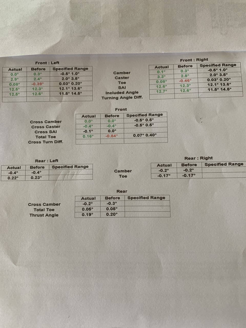

    Are these good alignment numbers?
