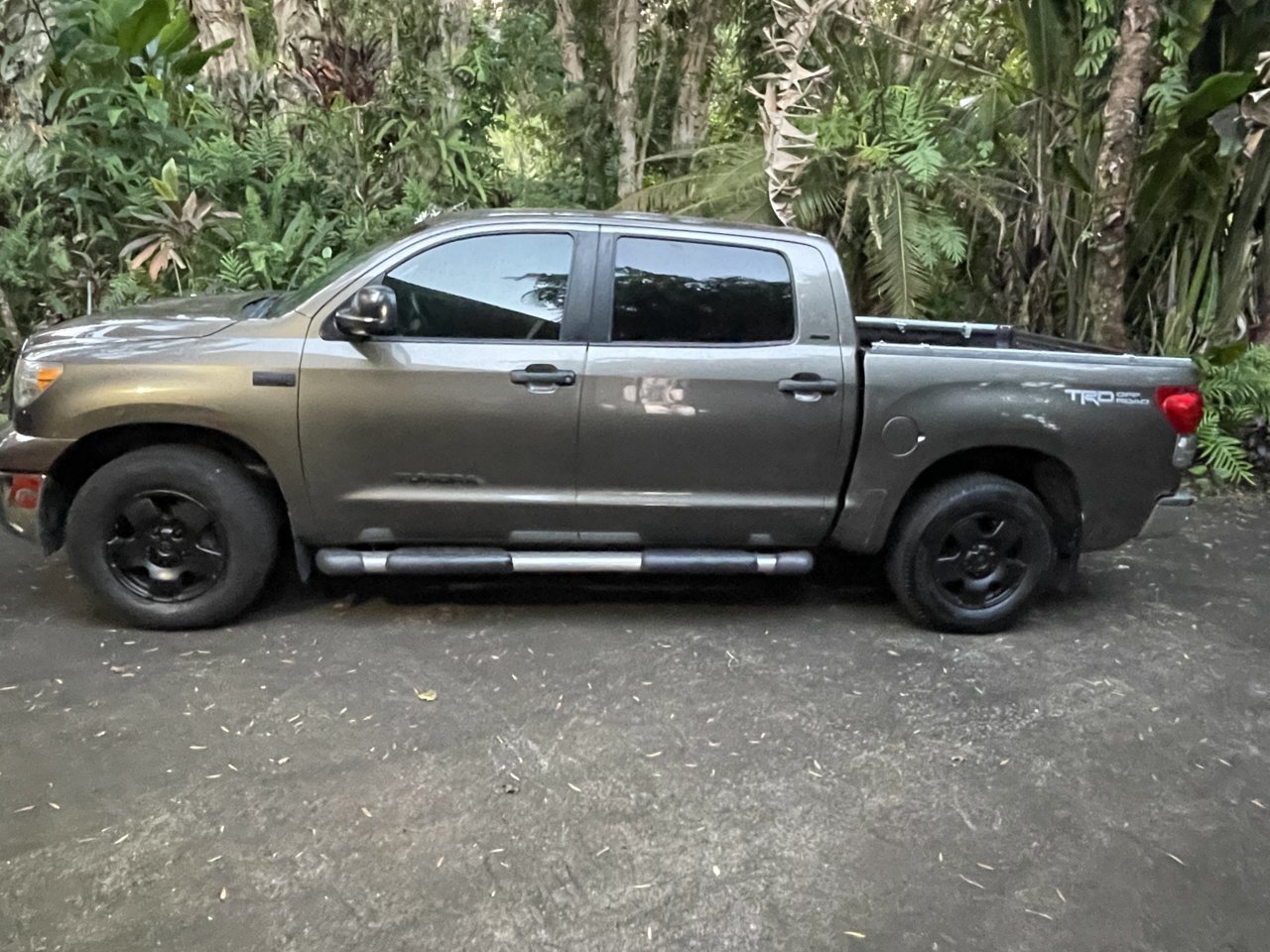

    I picked up a super clean set of these wheels and the seller said they came off his 2019 TRD, although the tires (michelin AT) were manufactured at the end of 2016, which seemed odd. I read something about the hub size being different, so I thought someone here might now. If they don't fit is there a fix? TIA

    All 2nd gens have the same pattern, you’re good.

    right 5x150...i was just concerned after reading a comment about the hub size and the gen 2.5's. Thanks...They will look sweet on my Pyrite Mica compared to my not so great Plasti-dip job! I used to be on tundratalk in the old days, but this forum seems to have more action.

    Think the hub size difference is .5mm or 1mm no one knows why but people run them just fine

    I have an '08 SR5 4x4 and a '21 PRO; My '08 was due for tires about the same time I came across someone on this forum getting rid of a set of takes offs (wheels and tires) from their '21 TRD Off Road. The wheels were the same ones you're looking at. I've not had any issues w/them on my '08, and I've got about 10k on them now.
    The only issues you may have are lug nuts (if you are currently running steel wheels) and possibly the TPMS sensors. On the set I got, the seller had removed the sensors before selling them, but the sensors off of my OE aluminum wheels worked fine w/the wheels off of the '21. Hope that helps!

    Thanks for that...I had the original aluminum TRD 18" wheels, so the lugnuts should be good.
    I'd just plasti-dipped my wheels the day before (finally, after wanting to di it it for about 7 years) and the seller who must not have seen my offer of $600, had lowered it to $500, so it was as big a no-brainer as there could be...but a part of me was thinking, "wouldn't it be ironic if they didn't fit for some weird reason"... thanks for the reassurance.
