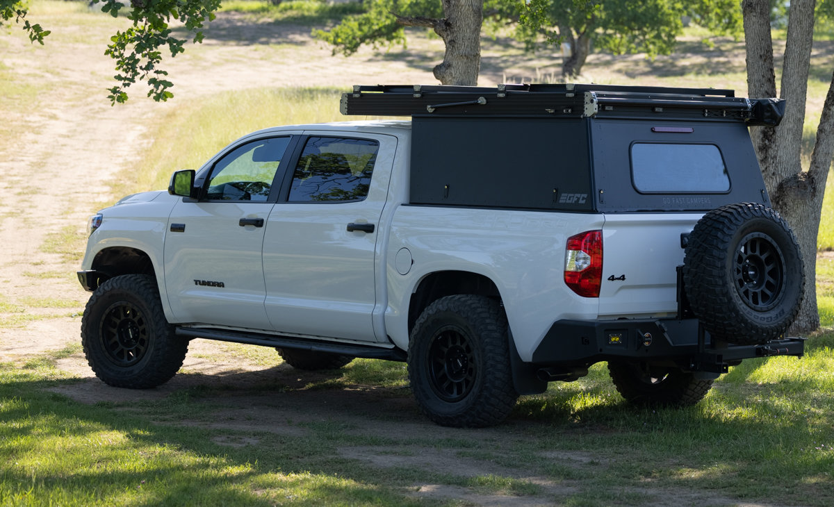

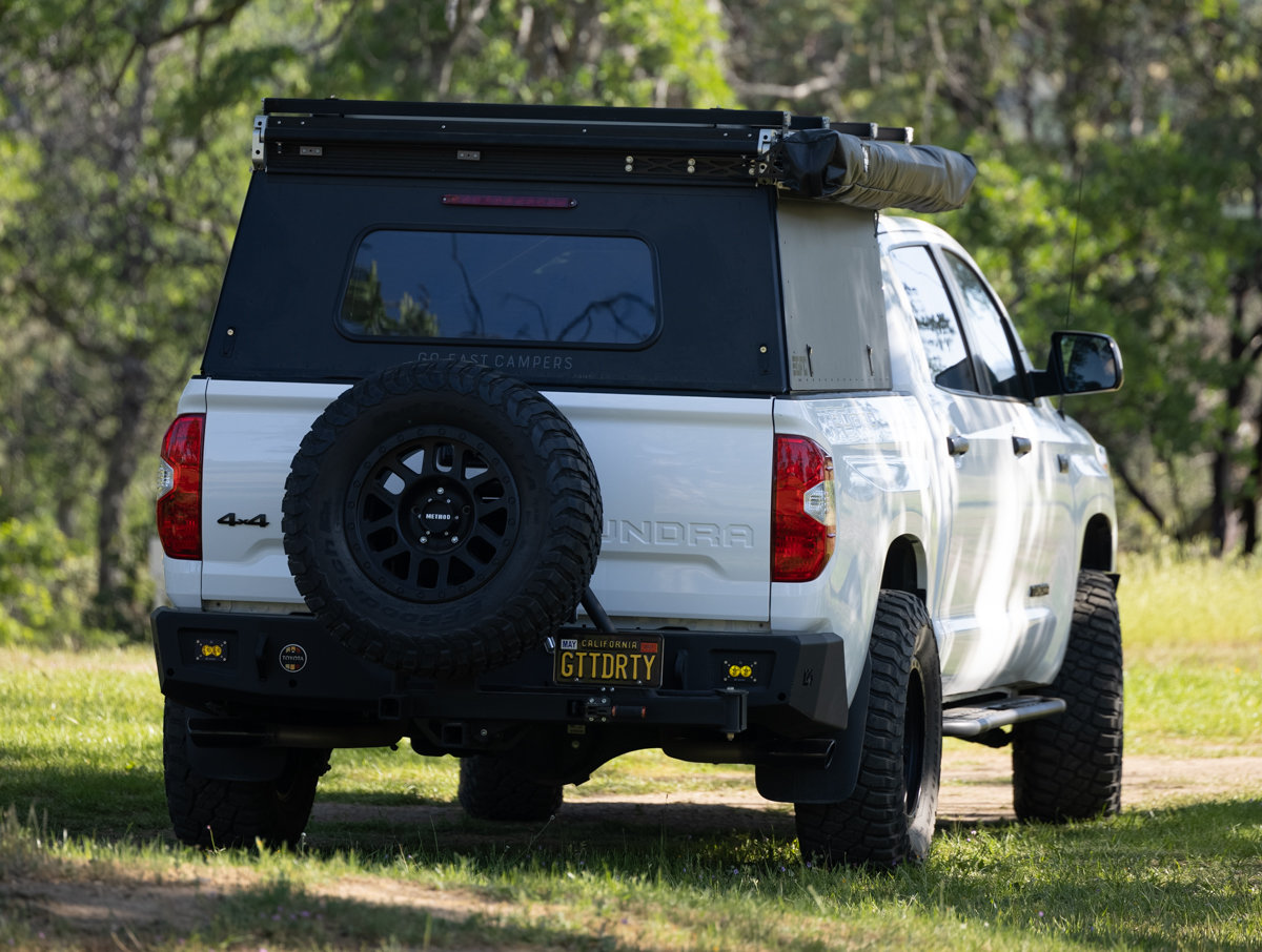

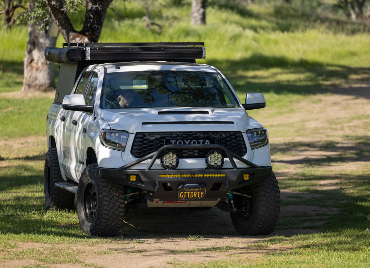

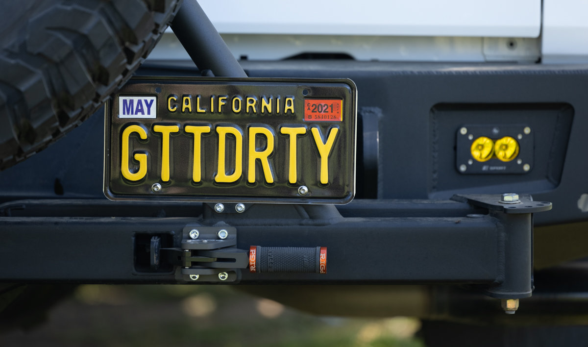

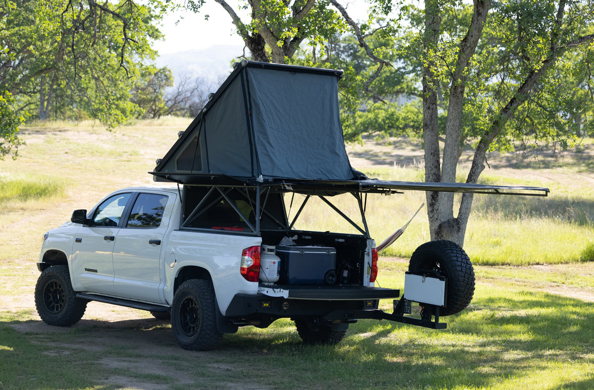

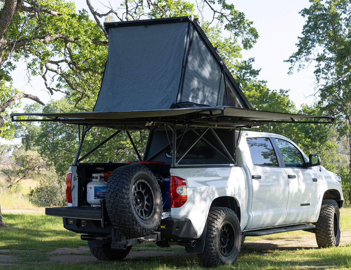

    Here are my latest build pics, i tried to show every angle and i also threw in a closeup of my new latch from Rigd that they just released
