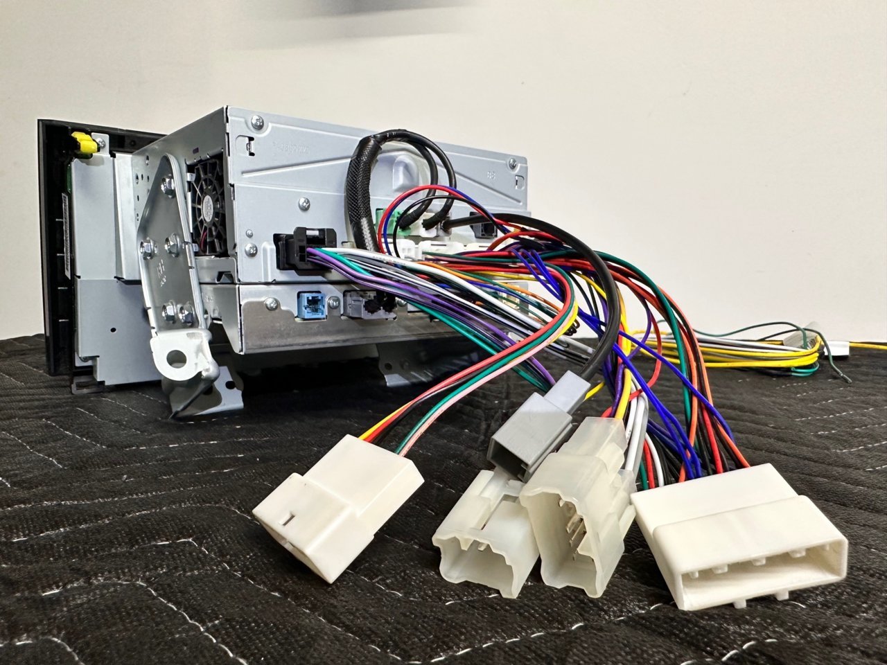

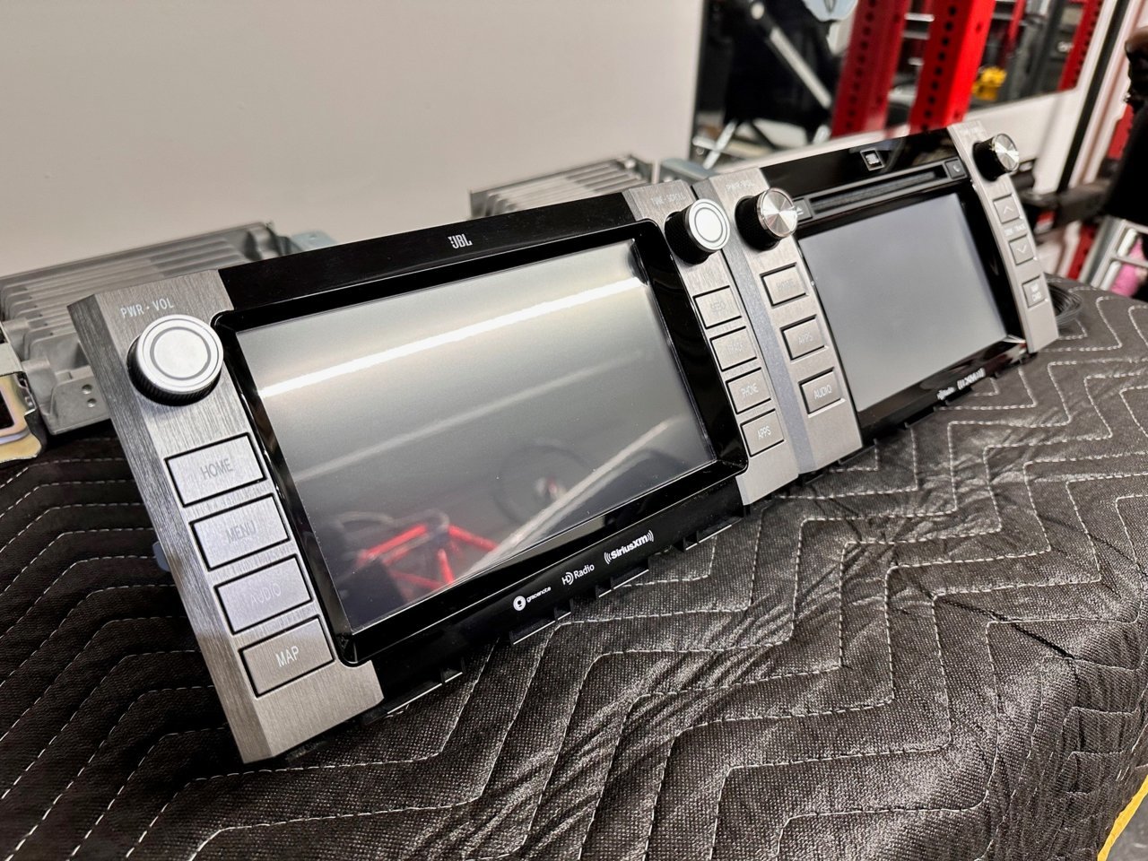

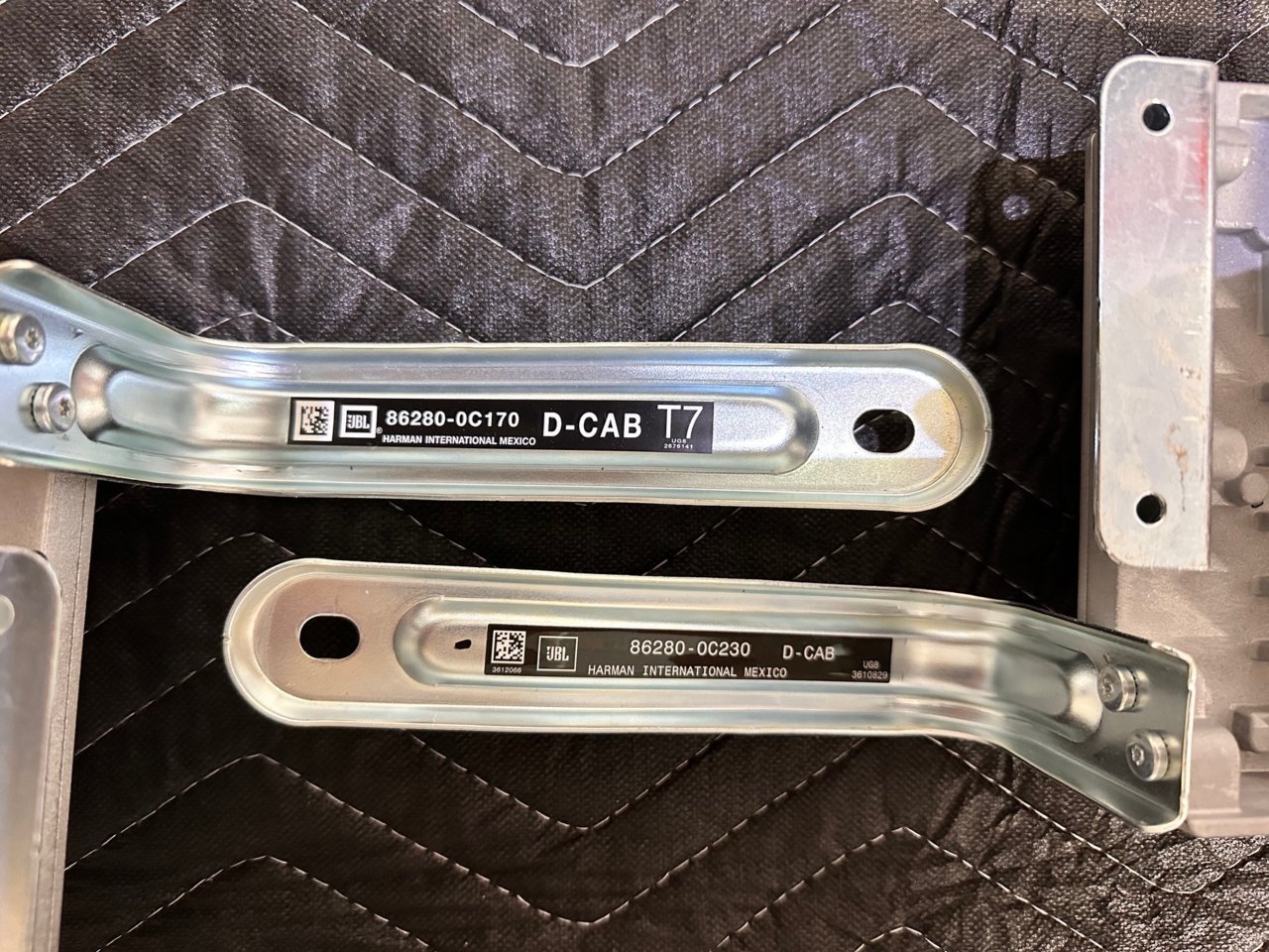

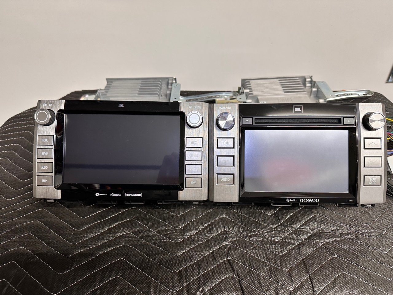

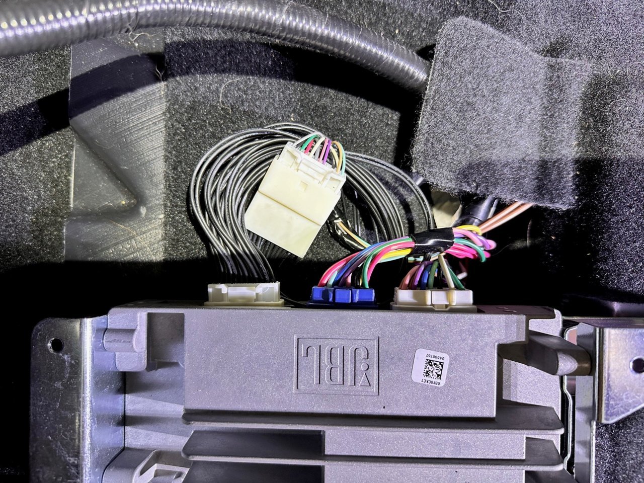

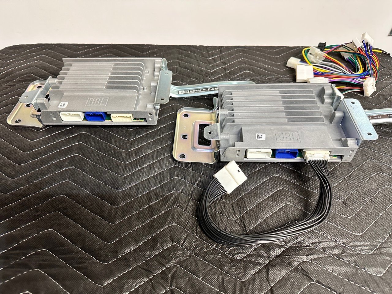

    I converted from a 2019 headunit without Apple CarPlay to 2020+ OEM Apple CarPlay with Entune 2.0 to Entune 3.0 Transplant Harness from autoharnesshouse.com!
    2020+ OEM JBL HeadUnit
    2020+ OEM JBL AMP

    It is plug and play. A bit hard to find the JBL Headunit and Amp but once you get those parts and the AutoHarnessHouse.com adapter, it's easy-peasy...

    Does the new JBL entune 3.0 have both wired and wireless carplay or just wired? I have a 2019 Tundra with JBL system and I just bought the JBL headunit and amp on eBay from a 2021 Tundra. I have ordered cables from autoharness.com. Just curious is I will end up with one or both connection options for carplay. Thanks, Steve
  9. Feb 12, 2024 at 2:51 PM
    Mtho512
    Mtho512 [OP] New Member
    Mar 28, 2021
    #61089
    10
    Only wired apple car play.
