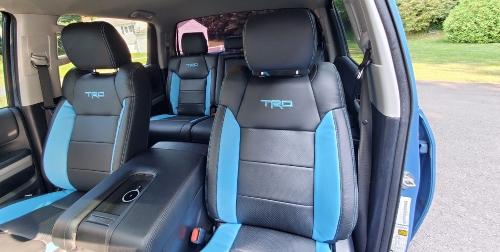

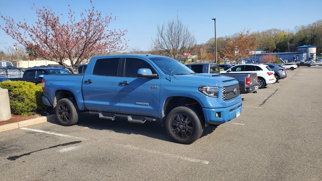

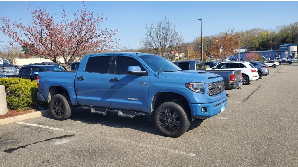

    6112's with coachbuilder shims for 3" Front Lift 5160's in rear with Coachbuilder +3 Shackles Katskins (what a pain to install but we'll worth it)
    SmartSelect_20250428_184032_Gallery.jpg SmartSelect_20250428_184113_Gallery.jpg This is absolutely amazing. So I've been piecing my setup since I got my new to me 2019 SR5 TRD Sport... Stereo is last thing to do for now lol. Famous last words.
    I really find it crazy that many aspects of our choices are similar.
    Here's my list:
    Front: 3X CDT Unity 8 Plus for Dash. I love how you have them mounted.
    Front Doors: CDT ES-690CFS 6X9 (2 ohm)
    All Active but likely doing rears separately using the passive crossover and 2 channels
    Rear Doors: CDT HD-62KHR System 6 1/2 and tweet
    Subs: 2 Audiomobile EVO 12's
    Sony XAV-9500ES
    Processing: ARC Audio PSM Pro DSP
    Amplifiers
    2x A/D/S PQ20's for mids & highs
    1 JBL BPX1100.1 for subs
    I also got all the HDPE goodies from Soundsgood stereo including amp racks for under seats and all door block off plates etc.
    It's been probably over 25 years since I took building a system seriously and I have to say I'm excited!
    Thank you for adding to the inspiration!
    Dan
