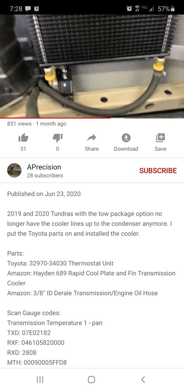

    There is only ONE transmission thermostat for the A60 transmission and it is this one:
    https://parts.toyotaofcoolsprings.c...9dHVuZHJhJnk9MjAxOCZ0PXNyNSZlPTUtN2wtdjgtZ2Fz
    This thermostat will replace the spacer plate used on 2019+ Tundras. It is a Toyota engineered part, and is a simple bolt in installation.
    Edit: Oh...Wait. Is the Hayden 689 one of those exchangers that bypasses cold fluid back to the transmission? You think you're going to use a bypassing exchanger in lieu of Toyota's thermostat? Dude...You can't even make connections to the A60 transmission without using Toyota's thermostat. I've had this conversation before, I'm done with this discussion. Read all the threads, the details are in the archives.
    Installing that heat exchanger with the connections on the bottom is like putting an empty glass into a sink full of water upside down. Air will be trapped in the top of the exchanger because there is not enough flow and pressure to force all the air down to the outlet. The exchanger will then only be partially filled with fluid and will provide low cooling efficiency.
