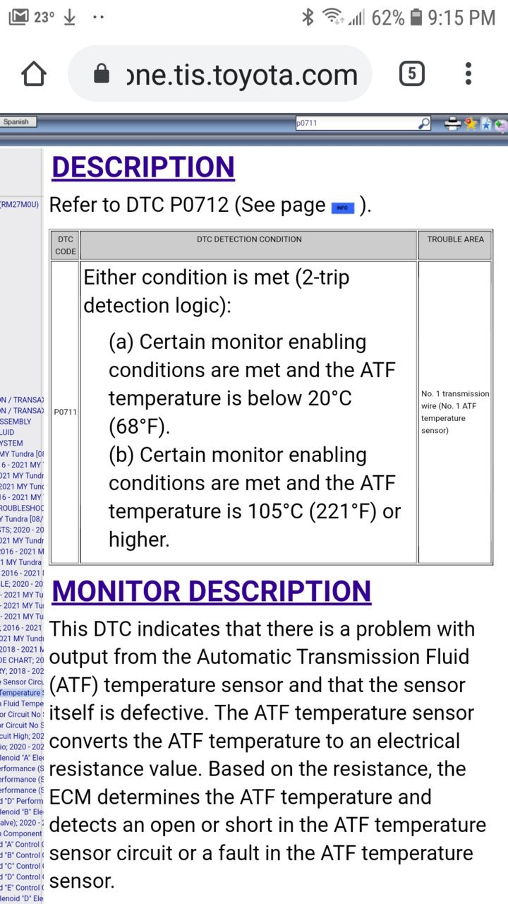

    I saw a screen shot from the TIS system that stated 221 degrees. Ill try to find it but now sure if I can.

    Dave
    NW ON, CANADA
    2016 Tundra OR
    This one. The 221f is not the spec for WS.

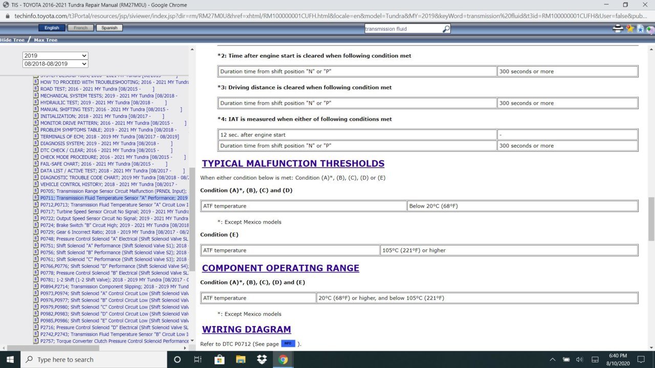

  5. Aug 12, 2020 at 7:31 AM
    #185
    2a_TX_Tundra
    2a_TX_Tundra New Member
    Dec 7, 2019
    #39649
    86
    2020 SR5 CM TSS in Quicksand
    Here you go

    Dave
    NW ON, CANADA
    2016 Tundra OR
    I was the one that posted that. The 221f is referring to the P0172 code and is not a spec for WS.

    Dec 7, 2019
    #39649
    86
    it specifically states ATF Temp operating range is 68F to 221F though

    Dave
    NW ON, CANADA
    2016 Tundra OR
    It's the condition that sets code P0172. It has nothing to do with WS.

    209
    Corey
    2019 Super White Tunda TRDPro
    Stock
    You are correct it does say the ATF temp operating range. This is part of my ammunition when I go into Toyota. However, these are not the specifications of WS ATF fluid, but this should be a great point on the truck owner side that the transmission should not be exceeding 221 degrees because its stated right here!
