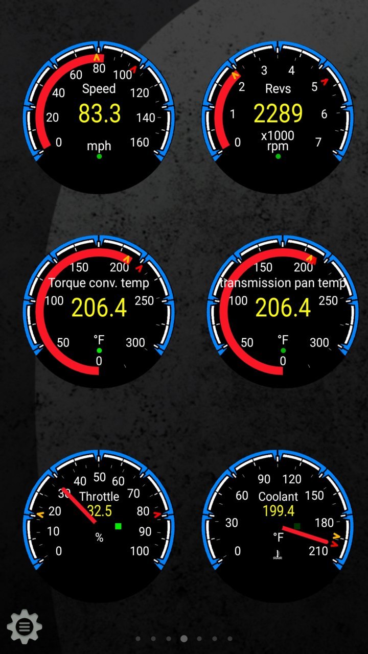

  9. Aug 18, 2020 at 8:28 PM
    #759
    Sumo91
    Sumo91 Busy with projects
    Nov 16, 2019
    #38726
    1,494
    TN
    2014 MGM Tundra Platinum 4x4
    Bilstein 8112/8100 3.25in lift Dobinson leaf springs 2.1in lift Level8 MK6 wheels Big ole dent in bedside
    I have a cooler and run around 200 unloaded on a hot day, this was at 99F outside
    80mph
    Screenshot_20200816-134400_Torque.jpg 85mphScreenshot_20200817-152509_Torque.jpg
    Jtundra81 and trdlife like this.
