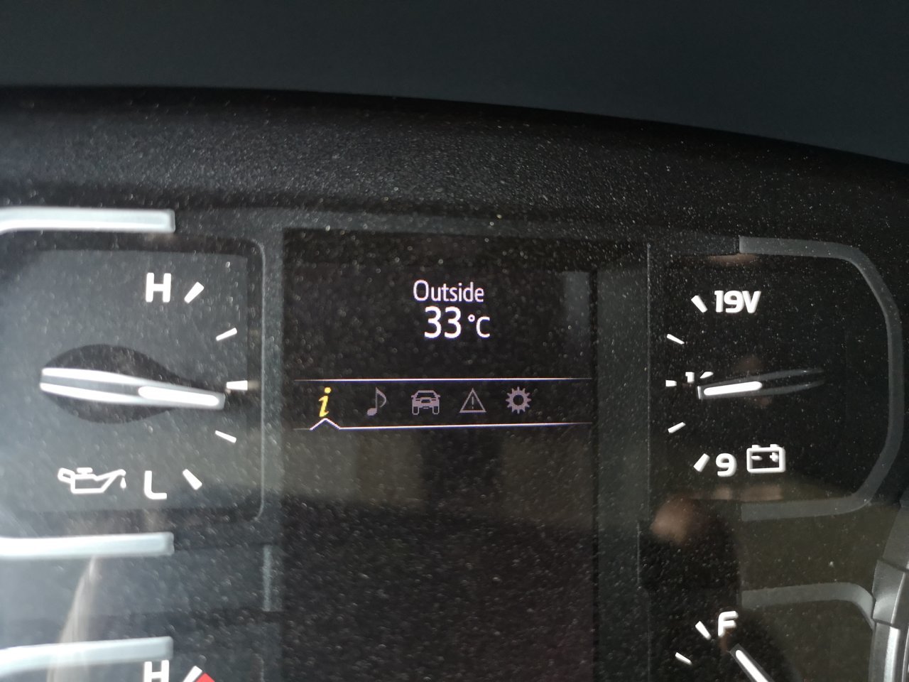

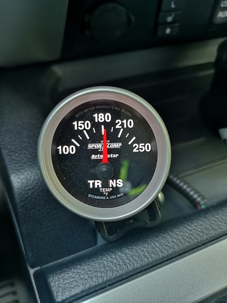

    You have your A/T temp in F and your outside temp in C. You Canadians are silly.
    Either way I like the gauge. Does that integrate with an OBDII controller?

    Bilstien 6112 front shocks set at 1.9"
    That's a nice guage

    Yep ford does that with their oil pressure gauges .. it's a on/off pressure switch . Built to always read just over the 1/2 mark lol

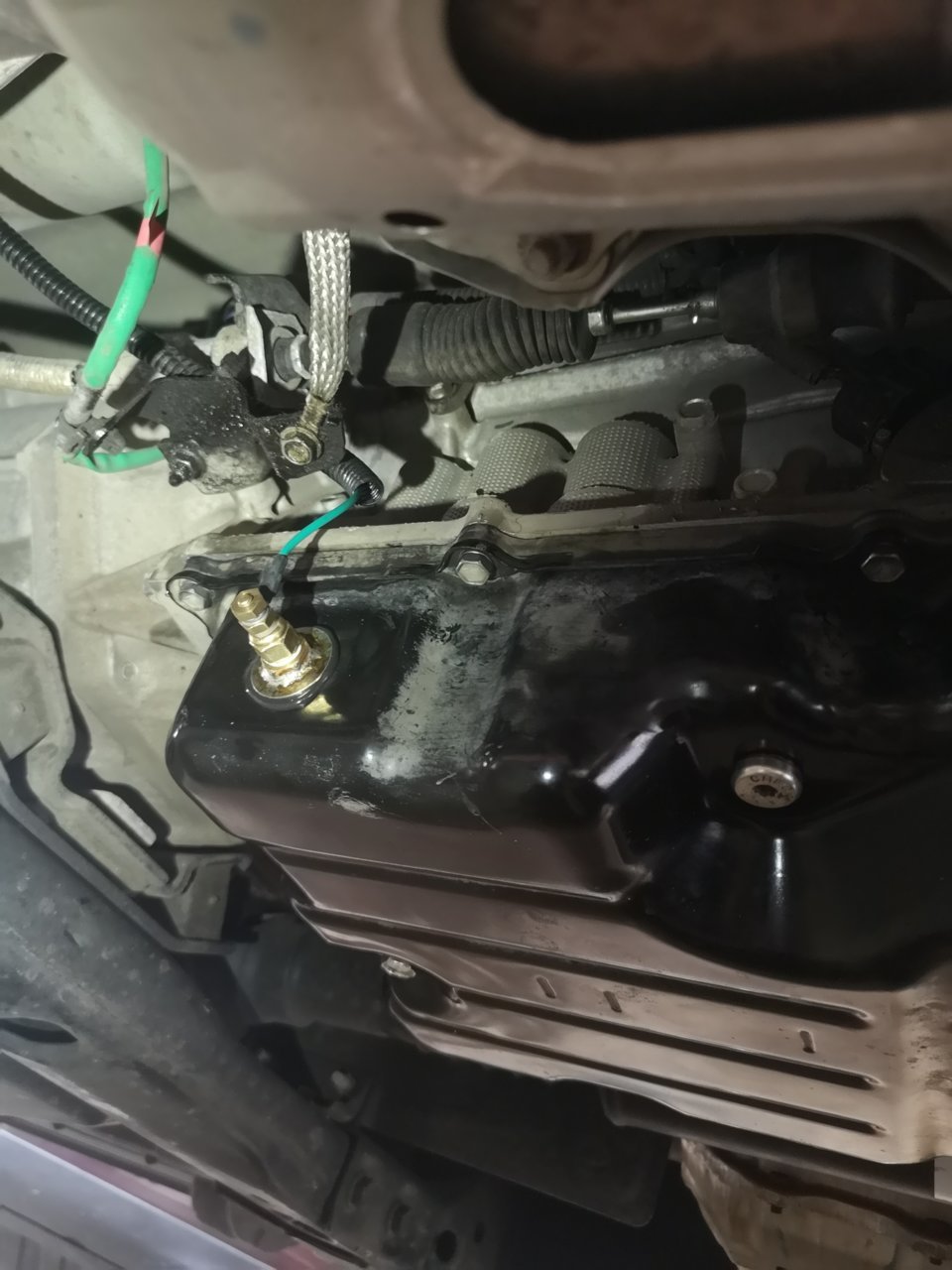

    It's hard wired to a sensor I Installed into the side of the trans pan . I wanted a real accurate reading of the pan temps . The autometer gauge reads about 5 degrees cooler than the sensor that you guys read with the obd dongles . My thought is that is because the sensor is located within the valve body and there is more heat at that location. IMG_20200701_170926.jpg

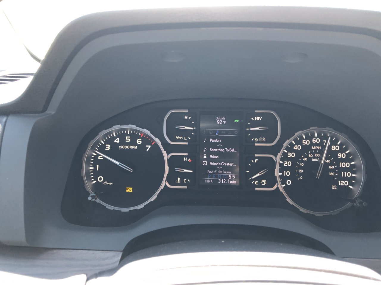

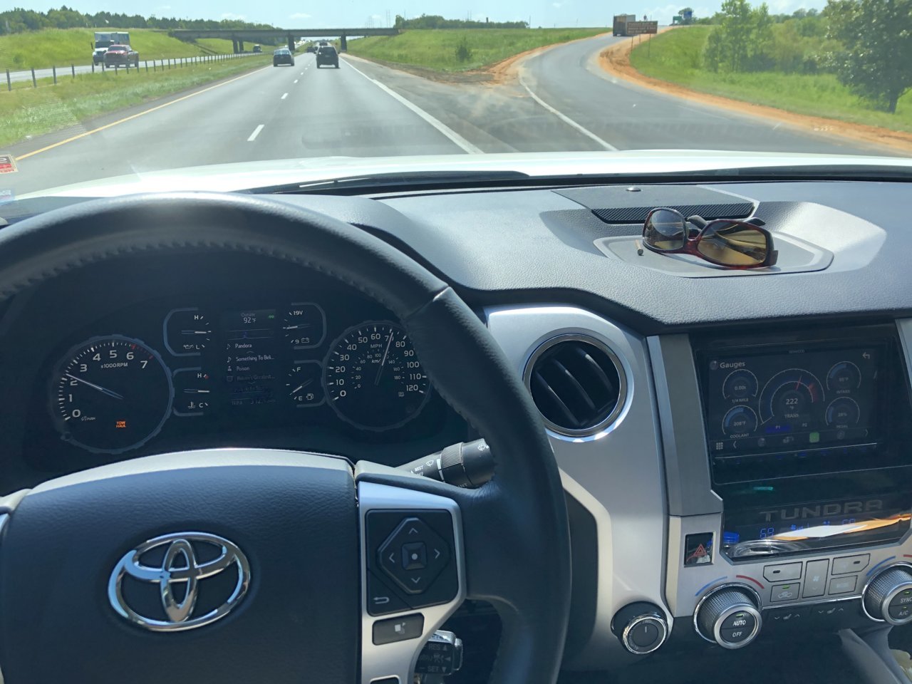

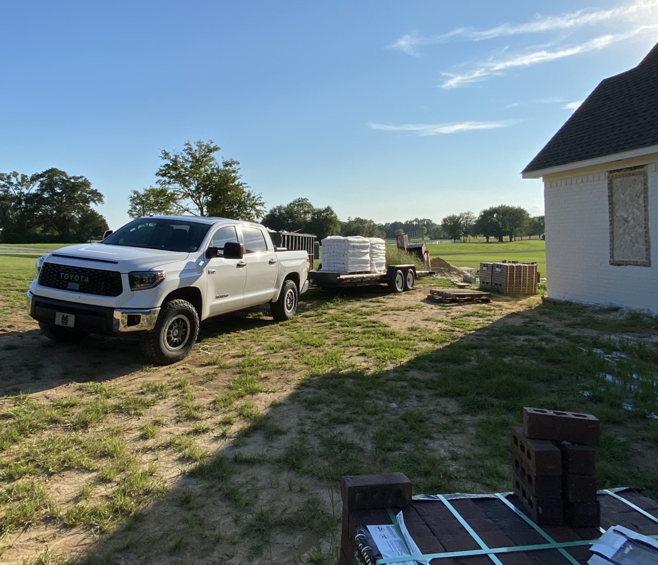

    Alright, so I had to tow around 8k pounds today for 45 miles on relatively flat highway. About 30 of those miles at 70mph in S-5 (always using t/h). Temps shown below are while cruising at 70 for 20 miles or so, but they really didn’t get much warmer than this. Over the whole trip I never got over 230. I feel confident that I could’ve driven 450 miles without getting much warmer than this.
    I’m kind of confused that they didn’t get hotter because as stated earlier in the thread, I had the temp warning come on when towing a couple thousand pounds less in similar conditions a year ago (was more wind resistance being an enclosed trailer). I also saw 235 when towing a much smaller trailer unloaded a couple weeks ago in similar conditions.

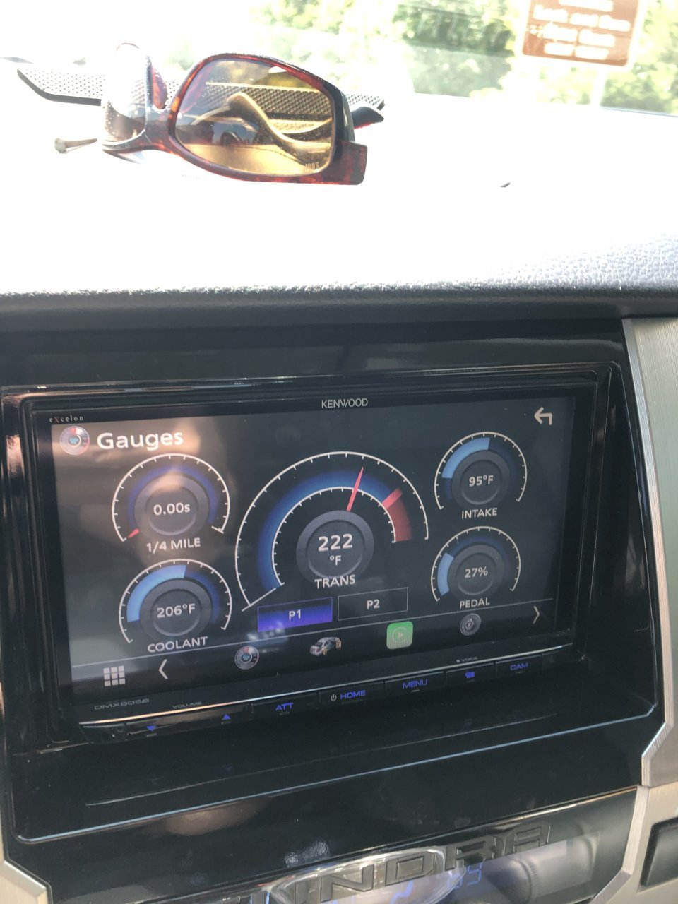

    How did you get your gauges to display on your radio? I have a kenwood unit similar to that one

    Not sure what that is, I'll look it up, I have and obdII reader that's plugged in my port, and I read the temps through torque pro, but I'd like the option to read it on my radio instead. I think my radio is a kenwood AVIC 9xxx
