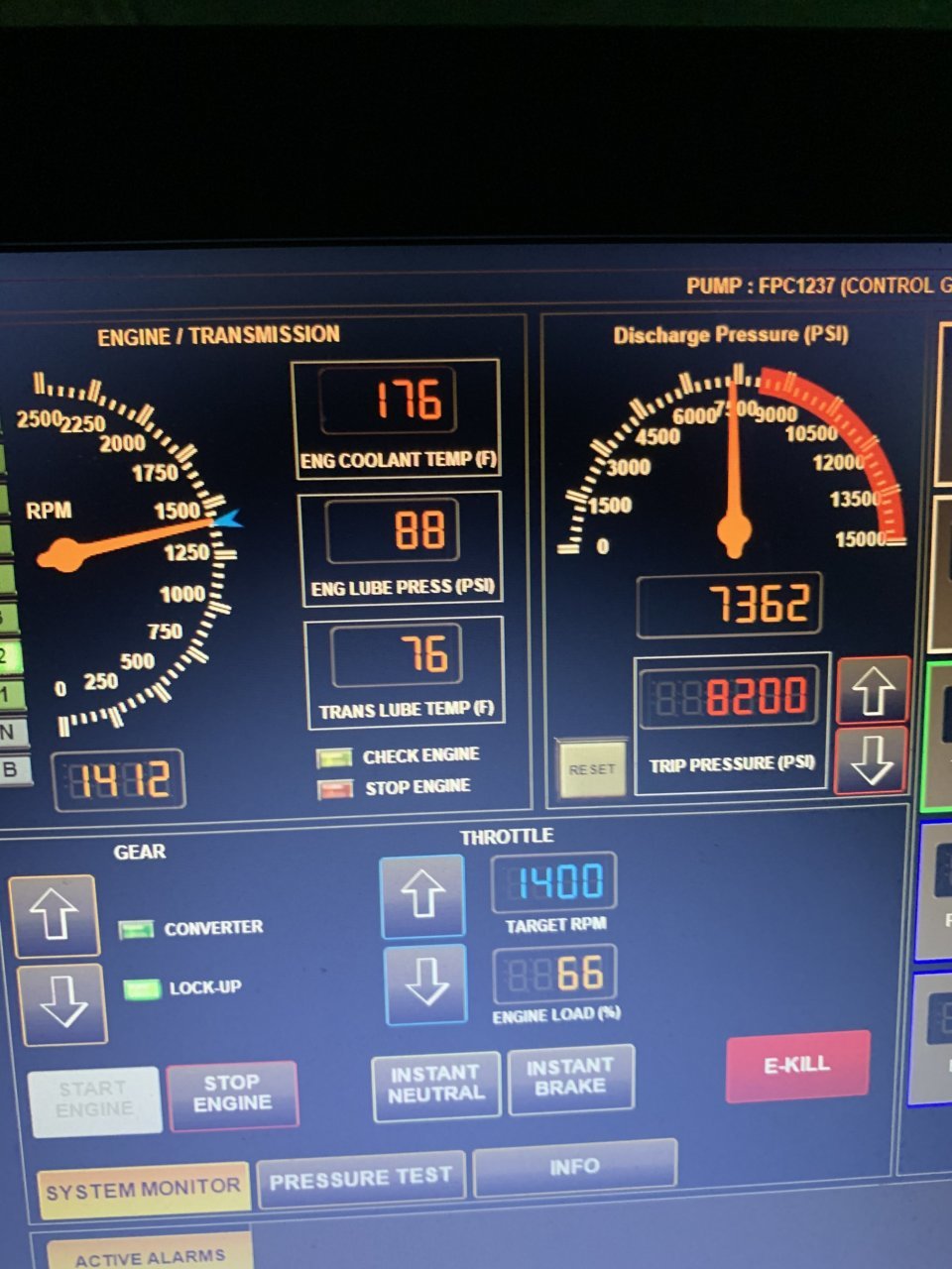

    here is an example I am dealing with right now. The trans temp is indicating ambient temperature when it should be engine temp (170’s). This tells me the cooler is working but has no control over actual temps due to either, a trans thermostat failure or a total lack of a trans thermostat altogether.
    Not a huge concern when it’s always 70-110 degrees ambient. When winter comes we will have issues with this unit, it won’t allow any gear selections other than 1st (and neutral)when trans temp is under 70 degrees.
    Anecdotal info: notice the lock-up indicator? Notice the engine RPM? This is the lowest RPM I can maintain lock-up. RPM makes for a more efficient torque converter, which means less slip, and less heat. An older Ford I had would “look” for less than 10% slip in the converter before applying the lock-up clutch. If it never saw 10% or less you never had lock-up, leading to trans wear.
    RPM is your friend as long as the cooling capacity of the heat exchanger package can maintain control of unit temperatures.
